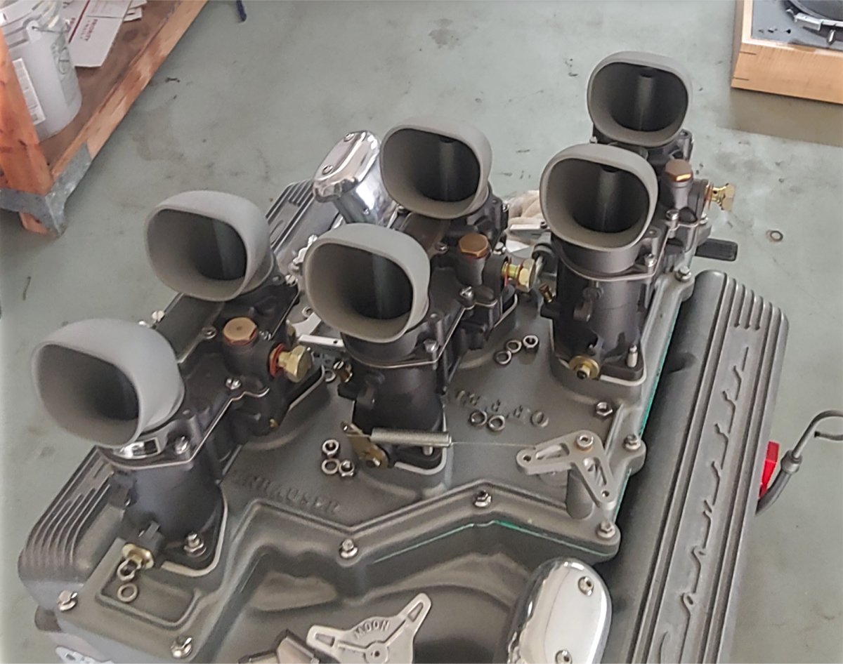

    I am too lazy for polishing chrome and aluminum so I am trying Cerakote. I did the intake and de-chromed Inglese boat scoops in baked satin magnesium and the 48IDA Webers in air dry tungsten. It is a bit of work prepping everything but I think the Cerakote will last for many years.

    I went to the web site... did you use the rub on patches or spray gun, or?

    I am not aware of any rub on patches. I sprayed mine on after blasting with fine garnet.

    I see. They have one video that shows it being applied with a saturated wipe of some sort that comes in a pouch. That may not be it, but just a top coat like Armorall. Looks good regardless.

    Surface Prep is most critical with high heat ceramic coatings. All surfaces should be blasted preferably with aluminum oxide. These are generally water-based coatings and all oil even residual oil has to be removed. I have found over the years quality metal prep will extended the service life of these coatings as far as corrosion resistance. In extreme heat situations metallic pigments , aluminum, stainless steel ,will hold up better than pigment.
