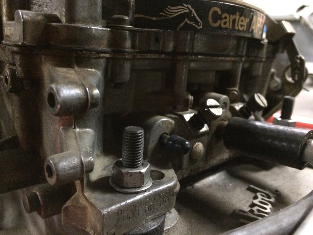

    Dumb me:) Here are pictures , the only ID I have is on the baseplate in the second picture................... 2639 9G 5S is the number, a little hard to read, yes it is a 5.25 inch air horn. There are 10 calibration kits listed on the Edelbrock site, so I'd like to get close to the right one, maybe I will have to mic the metering rods to find a match, any other ideas? Thanks for the help!

    The 96?5s is the carb number.
    I want to say it is a 625cfm carb the only numbers that it could be that start with a 96 and end with 5s are 9625S and 9635S.
    Both are 625cfm.

    9605s
    600cfm aftermarket AFB from around 1995.
    They use the same gaskets as an Edelbrock, but they use a different combination of jets/metering rods.
    Carter uses a different numbering system than Edelbrock, so it's kind of hard to cross parts unless you have a Carter AFB book (PN3703A) and an Edelbrock book. Their tuning guide tables are a little more complicated than Edelbrocks charts, but it's not rocket science.
