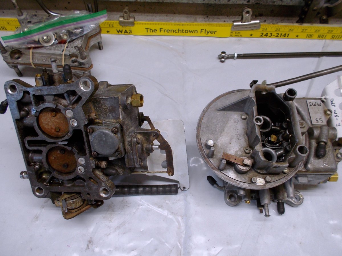

    Recently I discovered that my roadster pickup drag car had worn throttle shaft bores. This caused the throttle plates to be loose and leak air into the fuel / air stream. That created an erratic idle that could not be cured by adjusting the idle mixture screws or the curb idle screw. A search on the internet failed to find any good description on how to properly fix the problem. So this article addresses the problem. The carburetors in question are the Autolite 2150 series two barrels. They are a good carburetor with many advantages over other more popular aftermarket brands. Additionally, they are abundant in many bore sizes and available relatively cheaply. The steps outlined in this series apply to other brands of carburetors also. carbush 01.jpg
    The kit I ordered is from HENKYO. It consists of a 7/16” reamer on a 3/8” shaft body. The kit also includes eight knurled bronze bushings. I found it online for about forty bucks.

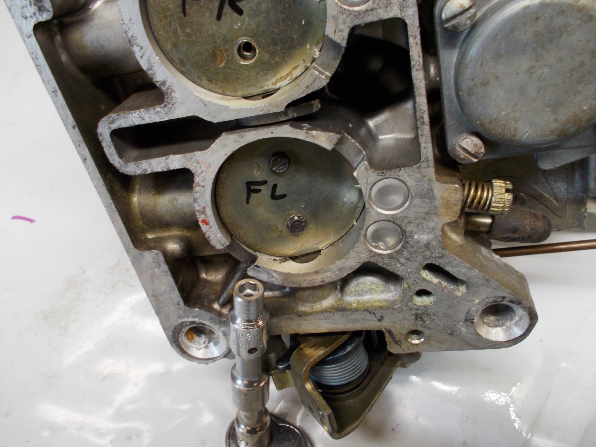

    Placing the carbs on a bench upside down gives access to the throttle plate screws. On these carbs they are #6 screws with extra fine threads. Some brands of carbs peen the threads of these screws; some crimp them; others use trocho-centric (vibration-proof) screws. It may be necessary to grind down the protruding thread with a Dremel tool before removal.
    ONE CAVEAT HERE: THE SCREWS HAVE VERY SHORT HEX HEADS. Be very careful not to strip them out! They were tightly secured in the shafts and required that I modify a 3/16” six-point socket by grinding it down to eliminate the slight lead-in chamfer on the socket. Leaving the chamfer in place did not provide enough hex head purchase to loosen the screws (I tried several brands) and the hex will round over before reaching breakaway torque.
    Mark the location of each plate. Once the throttle plates are removed the throttle shaft is ready to be removed.

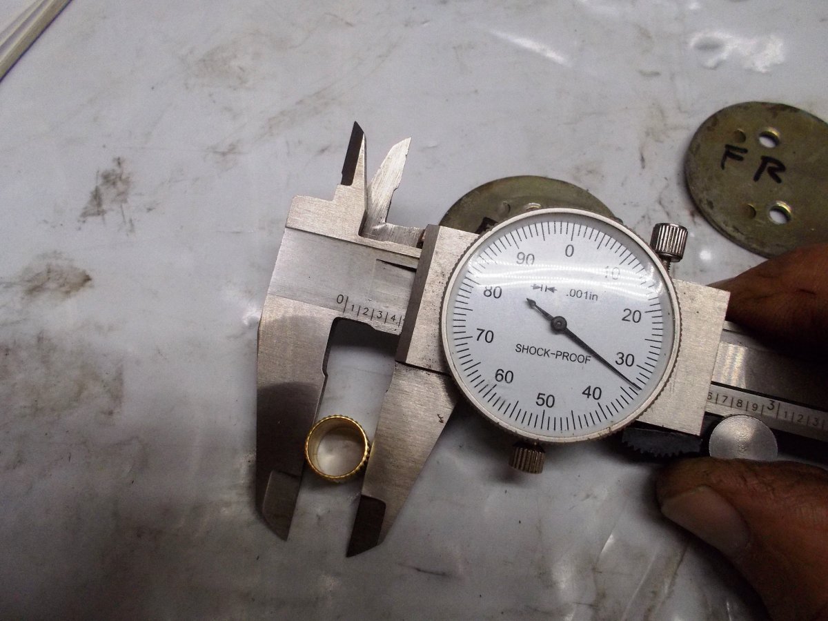

    The O.D. of the bronze replacement bushing measures 0.433”.
    The O.D. of the throttle shaft measures 0.372”.
    The I.D. of the bushing measures 0.375”.

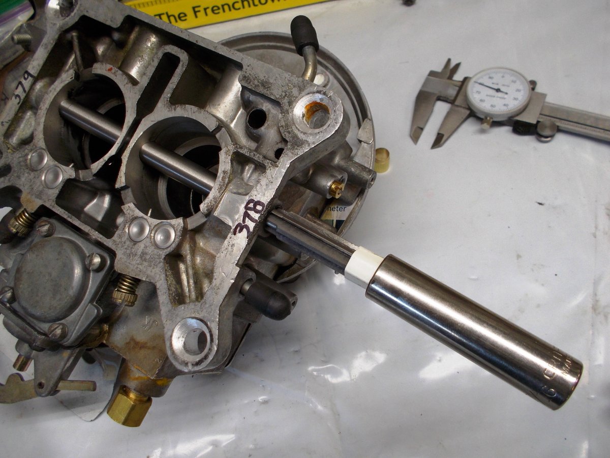

    You are now ready to drive in the bushing. It has a short lead-in area with no splines to make alignment to the bore easy.
    I use a bushing retaining compound and lightly coat the outer splines with it to secure the bushing in the bore permanently.

    Ream the carb body only deep enough to press in the bushing completely. In the case of this 2150 carb that meant the pilot needed to protrude out past the carb body by the length of the bushing. Ream to required depth. Drive the bushing into the bore.

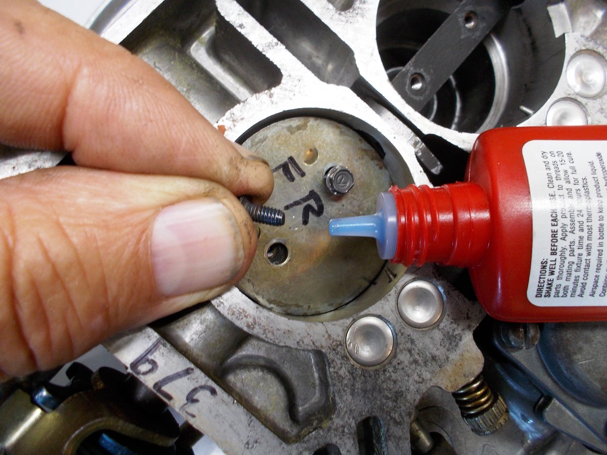

    Apply thread locker to the threads of the throttle plate attaching screws. LIGHTLY assemble the plates in the bores exactly as they were removed, but do not tighten the screws yet.
    Back off the curb idle adjustment screws completely before the next step.
    Using the plastic handle of a screwdriver gently tap the throttle plates while at the same time applying light pressure to the throttle lever to close the plates and perfectly center them up in the venturii bores. The holes in the throttle plates are intentionally oversized to allow for this perfect alignment adjustment before tightening the screws.
