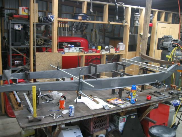

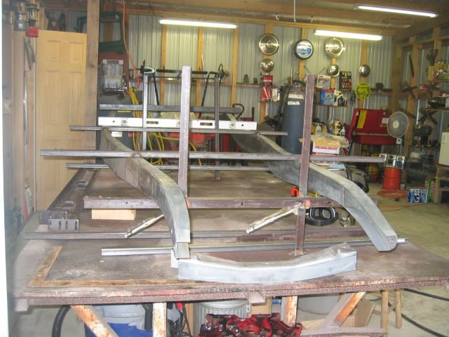

    Hot Turkey
    The frame was a bitch! Live and learn.... I know now that you jig it before you box it! It was out of wack a bit but I was able to get it back into shape. Just took many hours to do it right.

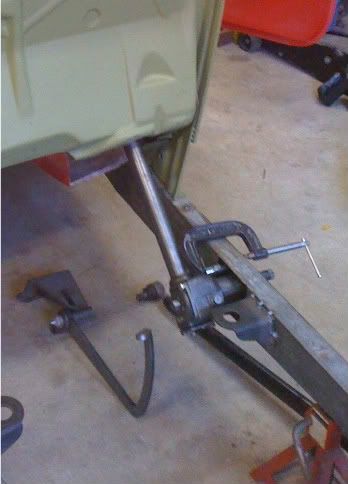

    Hot Turkey
    I got a steering box out of a 52 ford truck, cleaned it up and put it in. I had to grind off the bolt mounts on it so it's welded to the frame on the inside. I cut out the boxing plate and rewelded it around the body of the box.
