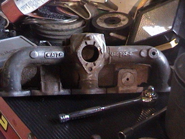

    These are pictures of what I was told was a Stude flathead six that is in my Willys Pu. Problem is I dont know the vintage or even if it is a Stude
    Any help would appreciated

    i believe that is a continental? engine.

    judging by the wire loom and the oil tube it is a stude....i have the same one in my 50 commander...it was 102 hp and a shit load of torque.....these motors are great drivers getting about 28 mpg at 65mph

    I still cant match my numbers to anything I can find in the stude forums and the local librarys are no help maybe someone can read these for me
    Top of head 526989
    2 D>N
    D 1 13
    D.s of block inbetween w/p and oil fill tube
    either bIIb649 or 6II649
    Lower section of block near oilpan D.S
    524807-3
    Also noticed intake and exhaust are the same assembly with only one exhaust port which is in the center
    Thanks for anyhelp I can get

    are you positive this isn't a plymouth or dodge flathead? there are a lot of similarities to the 50's mopar flathead there...

    Continnental still makes industrial and aircraft engines. They used to make auto engines through the 50s. In the 50s Continental was part of the Kaiser empire, so the engines were used in Kaiser-Frazer and Willys/Jeep vehicles.
    AMC NEVER used continental engines. AMC made their own engines. They didn't make the electrical parts or carbs, but an AMC engine with an Auto-Lite carb, starter, distributor, and alternator is still an AMC engine!!
    The flathead six used by AMC started out as a 1940 Nash design. You might count the 71-72 four cylinder F-head used in Jeeps made by AMC an AMC use. It was only used until supplies were used up and the AMC six was adapted to the CJ.

    The egine you are showing me is A Studebaker champion engine 170 or 185. Yes you can get all kinds of performance parts call bill cathcart give him the #s he will tell you year and displacment.
