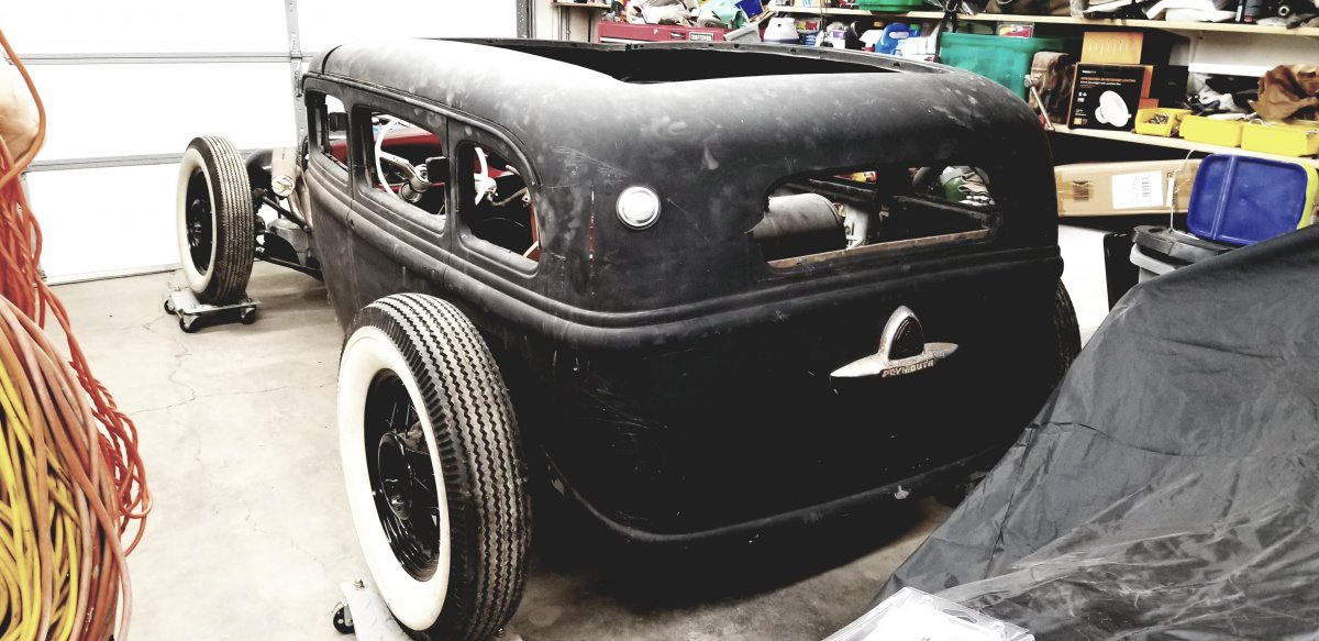

    So - can this car and it's evolution back to a road-worthy vehicle be a part of the HAMB family?
    It's in a funky state....but can it live here? Can we flesh it out together? Because I don't think I can do it without all of your advice.....
    1934 Plymouth sedan, chopped and channeled and on and on and on....none of which matters if it doesn't belong here.
    What do you think of this thing? Can we be a part of the HAMB? Or do the likes of this Plymouth not belong here?
    Help me understand. I need some guidance on this build -

    I think so, but it needs some "un-doing".

    I vote YES. Not every ones cup of tea when it comes to build style... but it IS a hot rod...and I'm not seeing a whole lot of non-traditional parts. Or are we still afraid of anything that has a vague resemblance to a rat?

    Mustang II and airbags are a no no. the whole style is modern. you have a big block and tunnel ram with wire wheels and wide whites, which is all mixed up.

  12. You asked, So here's my 2 cents. I like it, but what I'd do if it were mine. I don't like independent suspensions on a fenderless Hot Rod. { an easy fix } Build it safe, and I think it's a cool Hot Rod! Then drive it alot, and have FUN......

  17. When you have specific questions take close up pictures of the item in question, being careful to not get any of the "offensive" parts in the shot (IFS, bags, etc).
    If it was mine, i would probably start by removing the tunnel ram, the grill insert and those headers. Then I would turn over a 5 gallon bucket 10-15 feet away from the car, sit down and take a real hard, long look at it. Formulate a plan of where you want to end up and work back from there to where you are sitting on the bucket. Once you do that 90% of your decisions will have been made and it's just a matter of making the changes required to get you to your goal.
    Example... get a regular 4bbl intake and carb and a cool air cleaner (vintage caddy or something, and some headers that point in the correct direction... you may be able to swap sides with the ones you have...hard to tell from the pictures. Maybe put some form of muffler on them to make it tolerable to drive longer than around the block, get it started and running (without it overheating) go through the brakes and make sure that system is perfect... then drive it and figure out what you hate most about it and fix that next... on mine, the first thing after running and stopping was the rattling. YMMV.

    The one thing you can do to get away from the rat rod stance is raise the back of the body so that the wheels fit into the wheel well.

    Eliminate mid-section of body to make extended cab pick-up body, unchannel it, add 4 ft bed. Front "Z" in chassis is an eyesore. Maybe bobbed front fenders (rounded off back ends w/o running boards) would hide "Z" and M2. Maybe better to find a '34 to '48 Ford chassis to mount the body on.
  27. The Pinto suspension actually would be pretty easy to loose, no harder than stuffing an axle under a '55 Chebby.
    granted I am making a big assumption here but I would assume that removing the independent and hanging a an axle on the front would be part of the transformation and once everyone sees how easy it is in reality maybe more botched street rods would become fodder for a trad build. ;)
