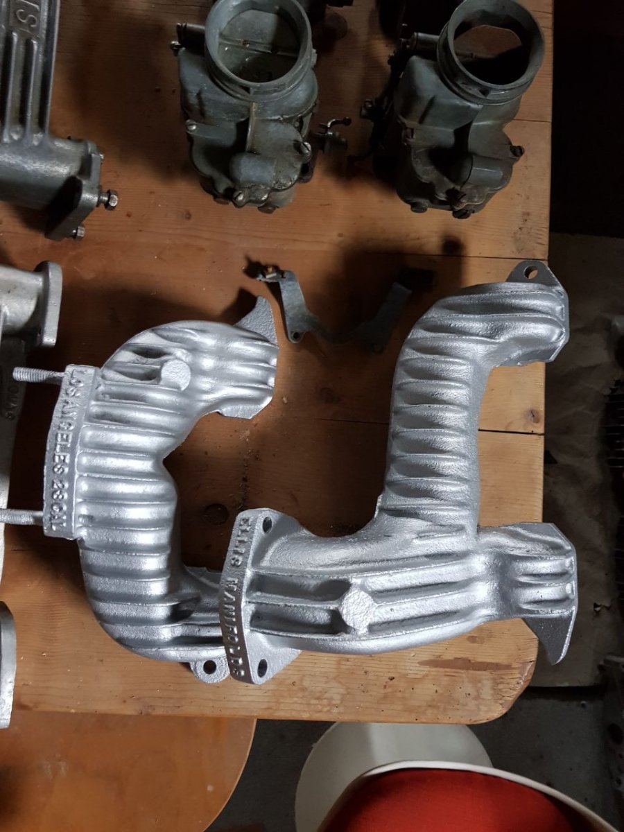

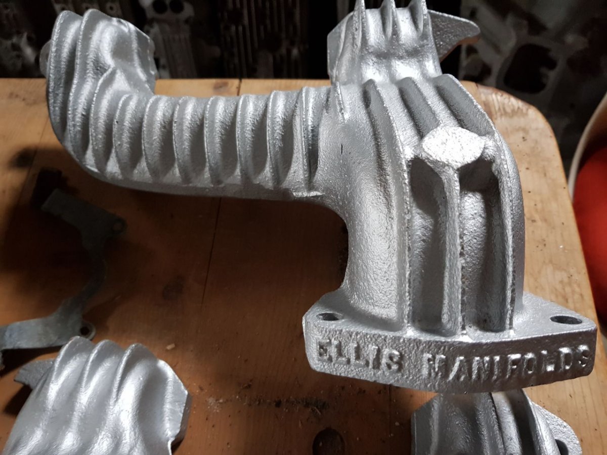

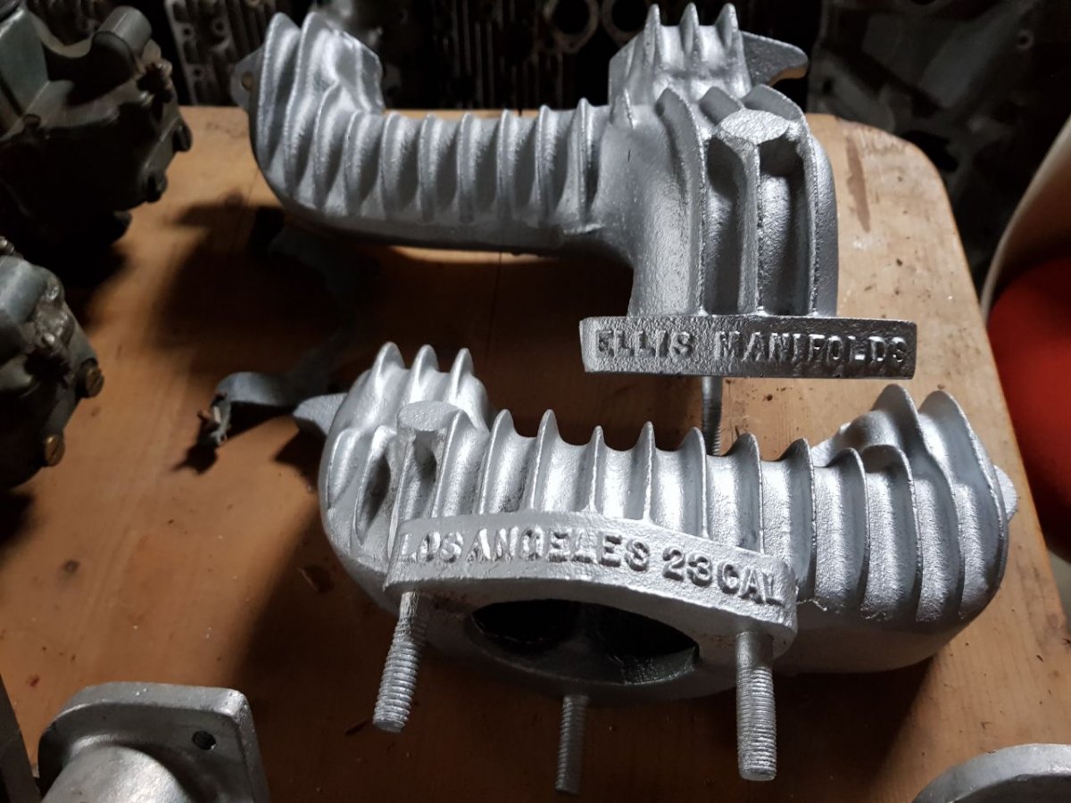

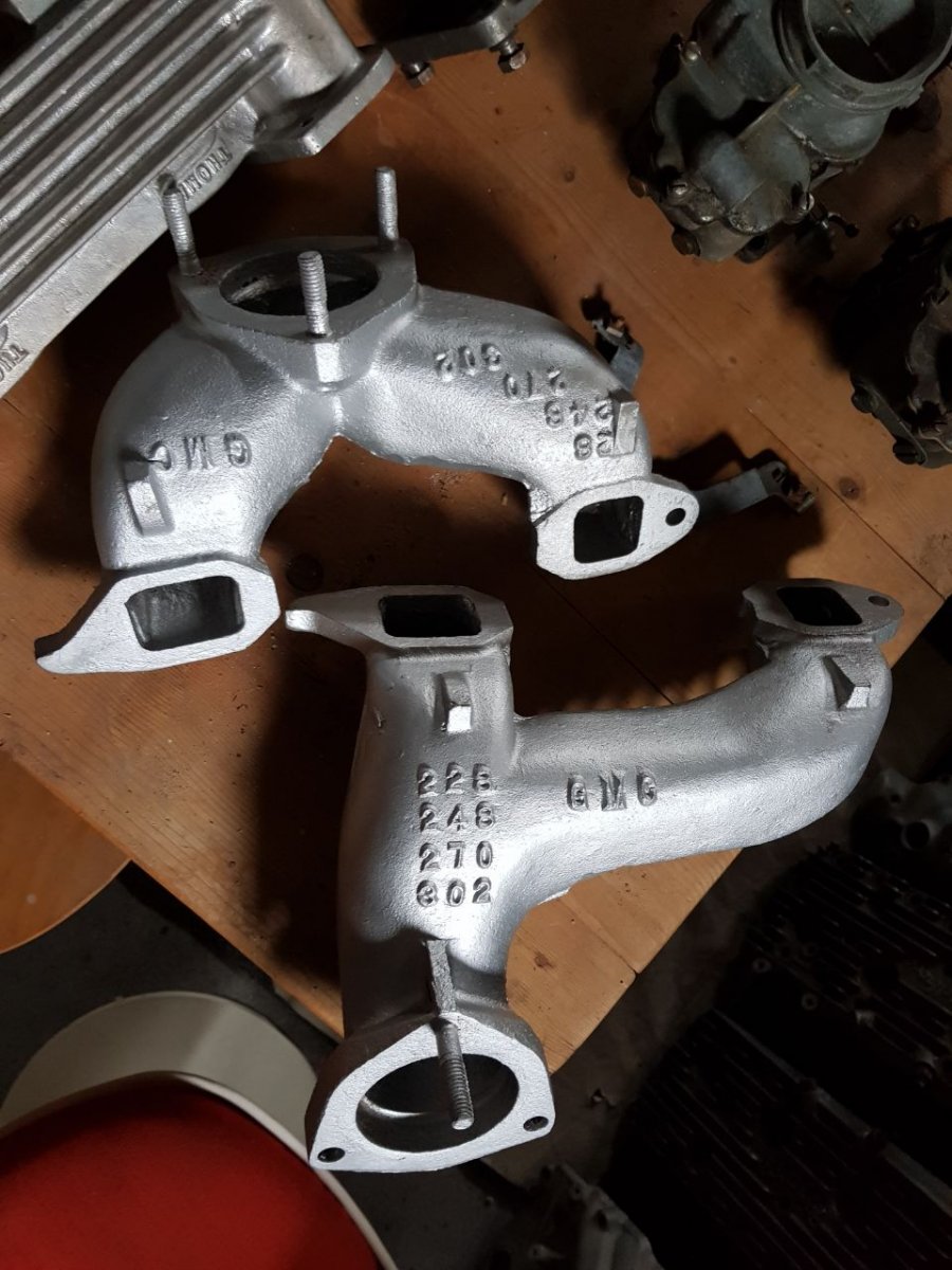

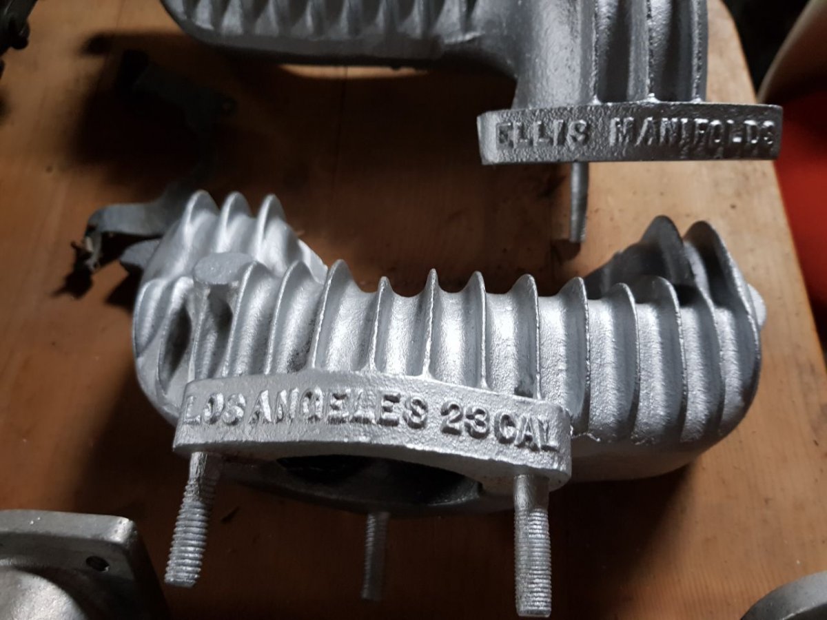

    A friend offered me a set of old Ellis GMC 6 manifolds . I have a 55 Chevy with a 235 in it and I think they look extremely nice! I don't want to cut them up, that would be a shame, but maybe they can be made to fit my 235? What do you think?

    The port spacing and size isn't quite the same as the Stovebolt's, but people take the Stovebolt Fenton headers and weld and grind the ports to match the GMC heads, so i'm sure it can work the other way too.

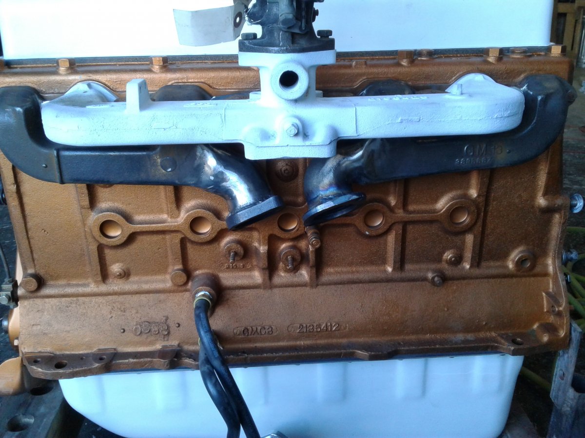

    If you look closely at the pics 1wannaflattie posted you can see the misalignment of the 235 manifold ports to the head ports.

    Those aren't in any Ellis price sheets I've seen. They didn't show up in the Chev/GMC 6 speed equipment thread a few years ago. They might be the only pair in existence ....
    They'll fit a Chevrolet as far as port spacing, but would likely need the clamp flanges trimmed to fit without leakage.

    They are real close to the Nicson GMC's with all those cooling fins and manufacturers info added. Nicsons are/were simpler. All GMC's were poor performers because you see as the exhaust must make an abrupt 90* down as it leaves the head even tho you do get duals. They are worth a lot as I see them as are original Nicsons but these would be way more. I would not modify them in anyway for a Chev.

    As for the manifolds, it'd be a shame to modify them in any way if they're really that rare, maybe they could serve as molds to cast a limited run of repops for the GMC builders. They're in amazing condition! I don't even have a GMC engine but I would grab those in a heartbeat just to have them. Great stuff.
