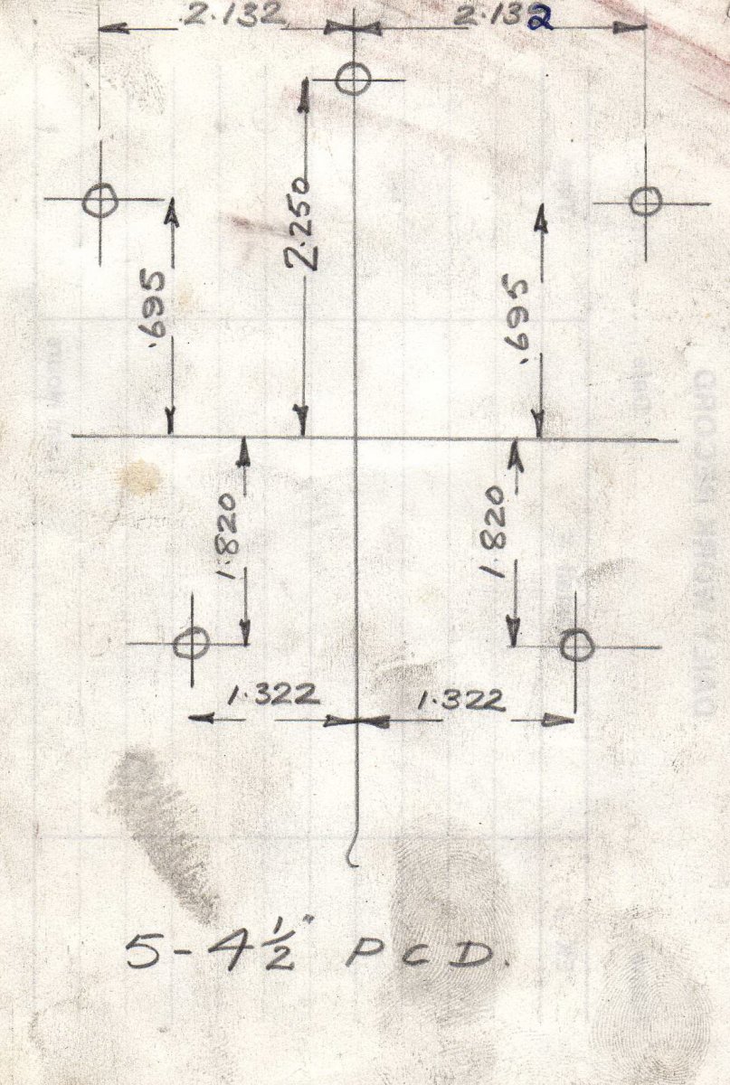

    I made a mold about thirty years ago to check wheel patterns of axles and wheels and here are the dimensions in case anyone is interested. Hope it helps.

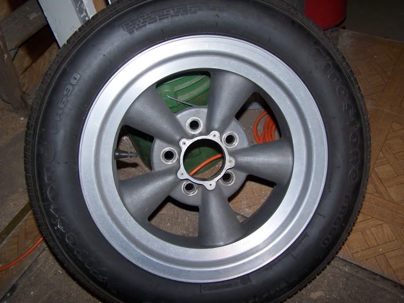

  24. Personally I hate wheel adapters so in my eyes you either redrill your hubs and drums or machine the wheel for unilug, since the wheel is flat on back and takes a shouldered shank there wouldn't be a problem and the washer may even cover your unilug.
    This is a photo of a 15x6 but I'm sure your 14x6 looks the same, should be a 11/16's hole. 102_6499.jpg 102_6502.jpg
