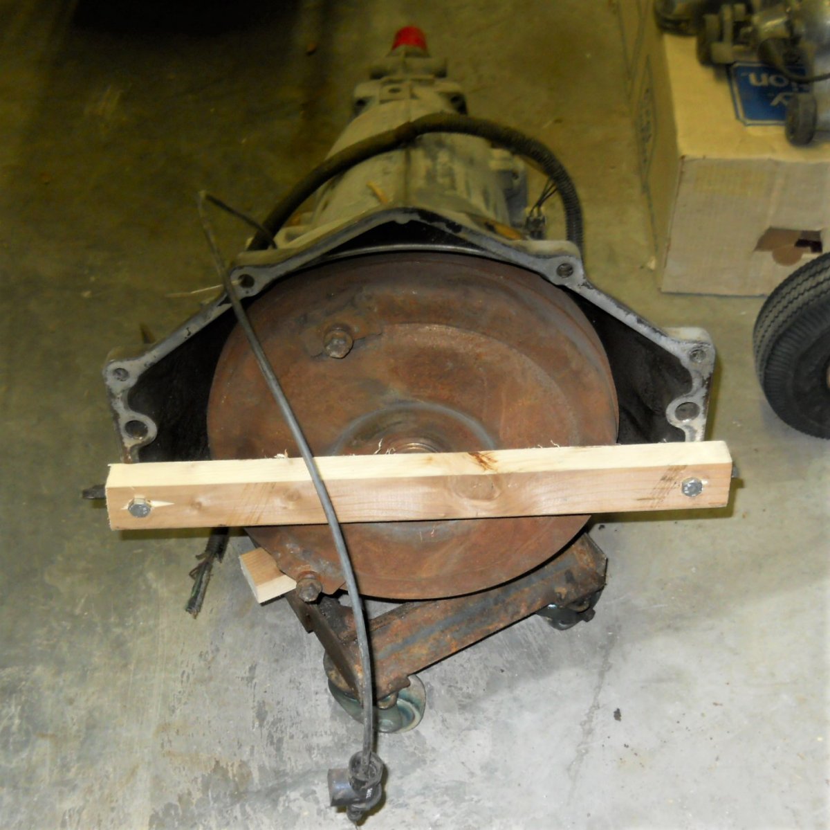

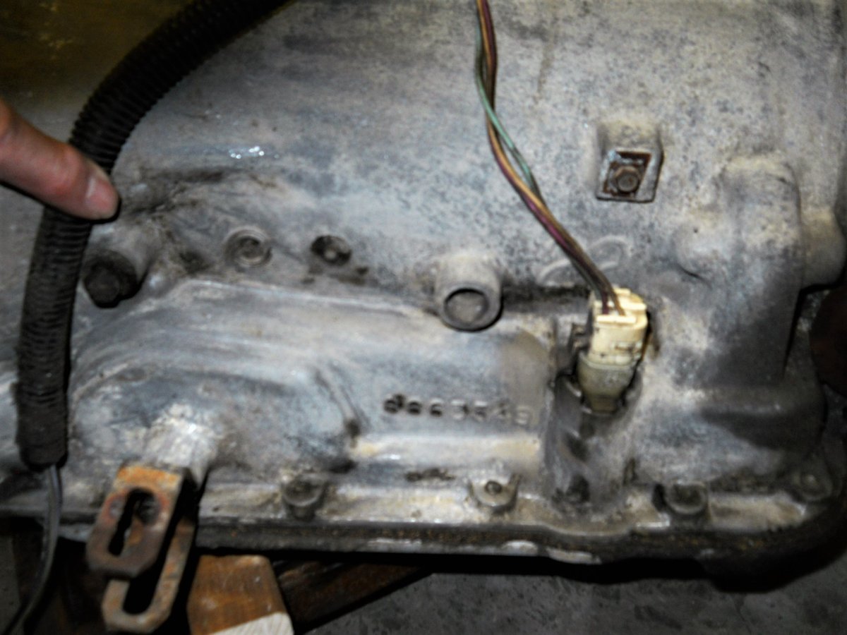

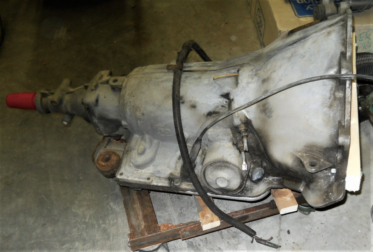

    I'm trying to find a four speed auto for my 56 Chev convertible. I'm told that a 200R4 has the same overall length as my powerglide. A buddy has this trans available and I don't know enough about them to ID it. Check it out and see if it's what I need.....thanks!

    It's a late TH700R4/4L60 with an auxiliary valve body. And electric speedo.

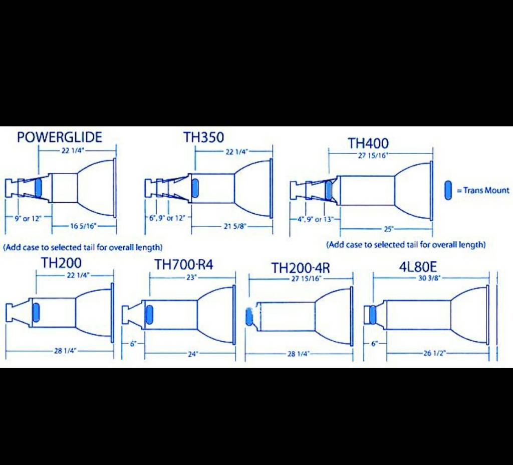

    I know I have another one about ID ing by pan gasket shapes, but I can't seem to find it quickly right now.
    Your pic does have a 700r4 look like the one in my Stude, but I built mine 20+ yrs ago, so I am using old memory :)

    you don't need a chart to see that it's a 700, do you ?

    I always find the 'transmission ID' charts that use pan gaskets could always be more informative. They often don't show the orientation in the vehicle, they don't specify whether you are looking up or down at the unit and are reproduced at varying sizes mixed together.

    Now any of you wise guys know if there's anyway that trans would fit in my 56 chev ragtop with the X braced frame? Does it need a computer to run it? and I thought there was a way to hook up the mechanical speedo instead of the electric? I know the 200r4 is the same length as my powerslide but I'm not sure about the 700r4 swap.

    Neither a 700R4 or a 2004R require a computer. They do require a 12+ IGN wire, if you'd like the torque converter to lock up in high gear. Both can have mechanical speedometer drives.
    Neither is the same length as a Powerglide, although, if you have the longer aluminum Powerglide, a 2000R4 is pretty close.
