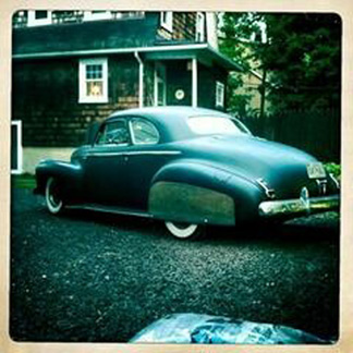

    I had a set of coil springs made for my '41 Buick that lowered the car just right up front, but now that they've settled, the front is SLIGHTLY lower than the back which is no good - opposite of the taildragger rake I'm going for. I mocked up the skirts I've been working on and figured that I need about 1.5"-2" lower in the back.
    Can a spring shop take the coils that I have, cut them to lose the extra height, and re-shape them to sit in the spring mounts properly? Or do I just need to have new coils made?
