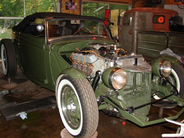

    Uh, wrong-O on that. I have a '68 high compression 472 that's .060 over in my '36 roadster. I used cam and valvetrain componants from MTS, and ported the stock intake (very little clearance underhood) and heads per their reccomendations. It's 10:1 using Egge pistons, runs great on pump (premium) gas, and, according to MTS, with how it's set up, is 400 hp. Remember, these are 375 stock. An Edelbrock intake flows much better than stock, headers supposededly really wake them up, and you'll want rocker shafts as opposed to the stock pedestal rocker arm set up to turn it over 4500 rpm, but, it's scary fast as is.
    You can't find reliable info on the 'net? You're not looking very hard. Expensive? Mine was all in at less than 2500 bucks, counting the machine work (hot tank, crank 10 under, resize the big ends of the rods, bore, valve job and assemble the heads). That's dirt cheap power, AND it gets 18 mpg on the highway.
