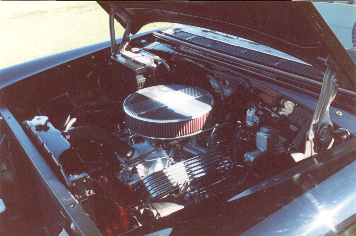

    I've been running the same engine in my 55 since 1977. It's a 283 bored to 301, (0.120 over), 11:1 compression, 2.02 fuelly heads, 375 hp 327 cam, Edelbrock Tarantula intake and 780 Holley. Champion J12Y plugs have always worked well in this combination.
    One of the best changes was going to a Mallory Unilite. The timing is much more accurate and the plugs last longer, with the Unilite.
