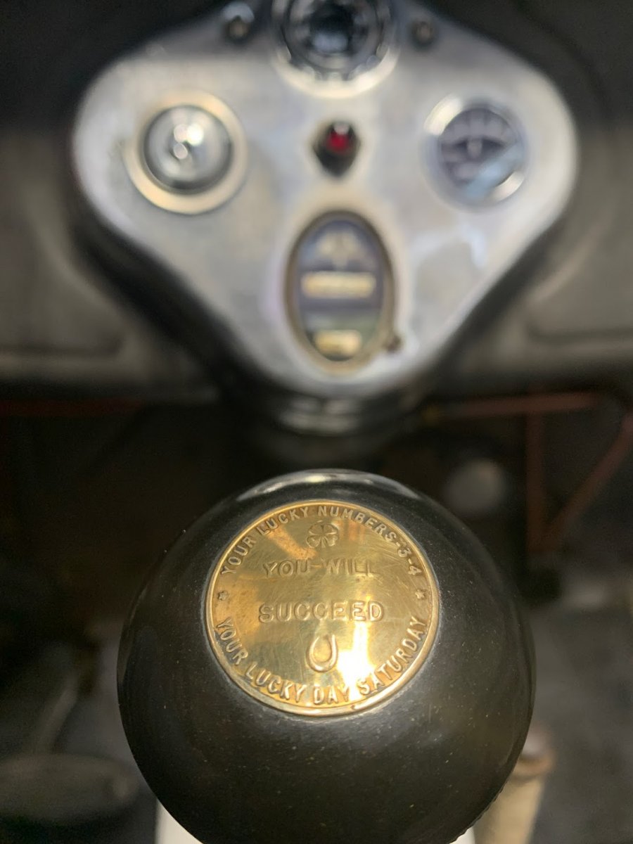

    On Wednesday, I also received a pair of priceless gifts for the car. As luck would have it, they're both shift knobs. The first one came from my parents and Lucky Burton. Lucky is a talented craftsman and one of the nicest guys in the business; I got to know him while writing the feature on his Model A competition coupe for TRJ #83.
    IMG_6732.jpg Here I am trying out Lucky's land speed machine.
    For my roadster, I can use all the luck I can get! The shifter has a great feel to it.

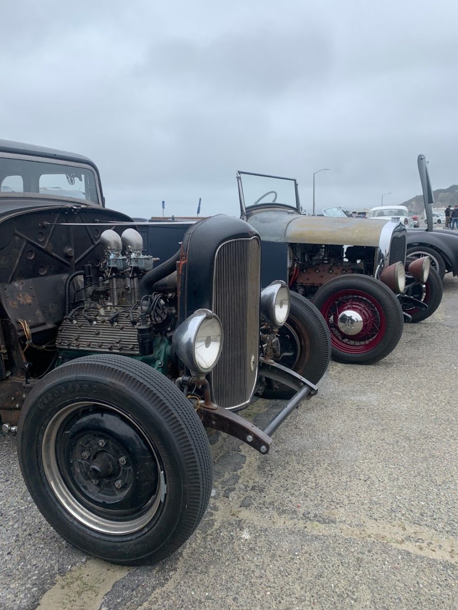

    This morning I cut through the fog and rode my bike to the Ocean Beach car show. I was very impressed with the traditional hot rods in attendance, some of which I've seen and others that are new to me. IMG_5116.jpg

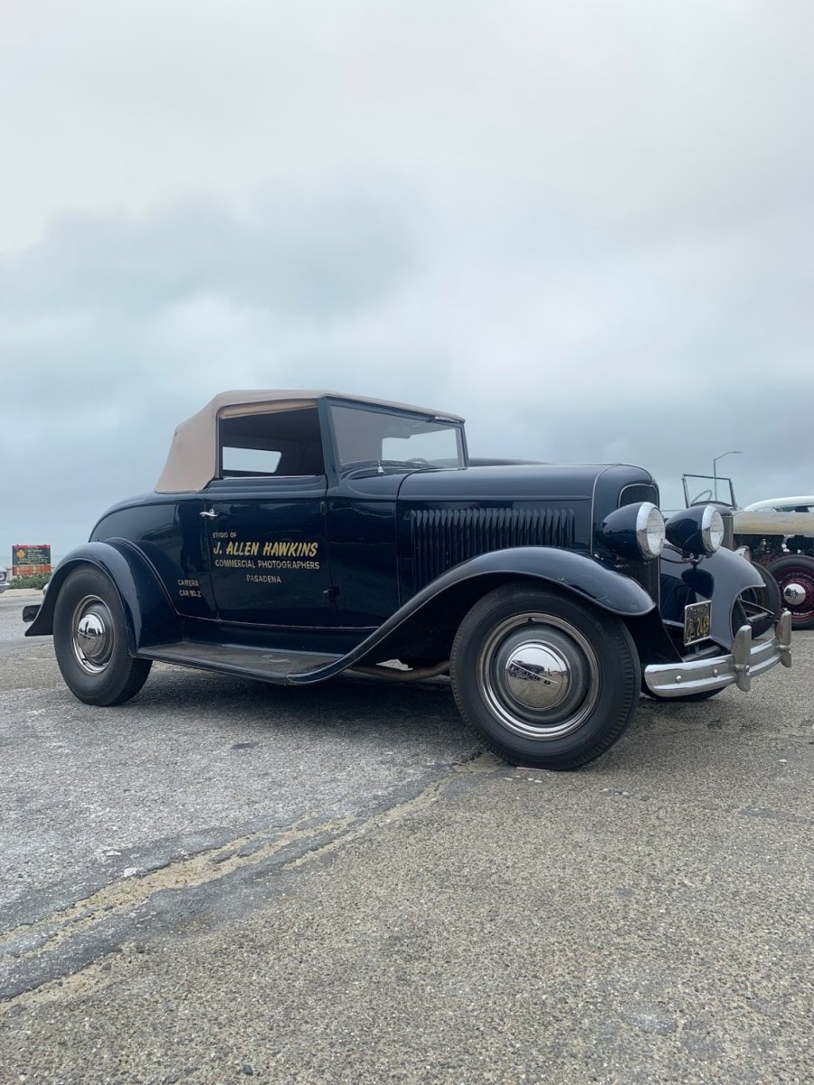

    I've always liked this cabriolet, better known as "Camera Car #2." IMG_5127.jpg
    Bonus points for the creative fender patch. Possibly a future Jalopy Journal feature car? We'll see...
    I dream of having an interior this nice one day. Note the old chrome upper dash rail and garnish moldings.
    More good looking vintage tin. The five-window in the foreground belongs to Brandon aka LokiRoadster.
    Of all the cars I haven't seen before, this was my favorite. It belongs to master craftsman and land speed racer John Buddenbaum. I had a great time meeting John and learning about not only the A, but also his record-setting 50cc streamliner motorcycle and his slew of interesting projects. On the cabriolet, note the aluminum rolled rear pan, Bugatti exhaust and vintage racing tires.
    Power comes from a hopped up 'banger running a 7:1 Lyon Speed Head, Stromberg carb and plenty of tricks for touring. John bought the car in Arizona and drove it back to the Bay Area. I can't wait to get a photo of my car next to it for comparison sake. IMG_5135.jpg

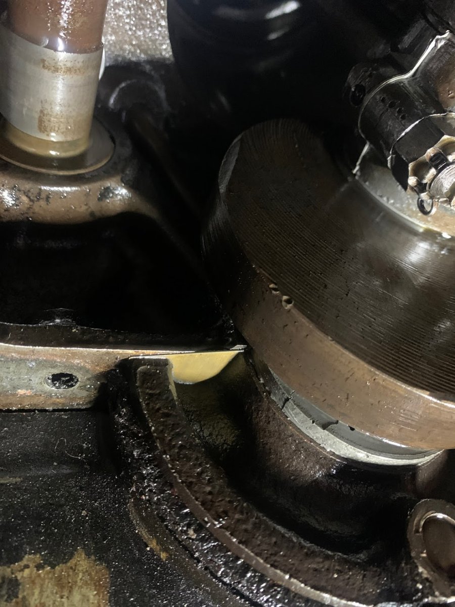

    When I got home, I dove right back into the project. While scraping the old oil pan gasket, I came across something, well, bad.
    Looks like the babbitt on the bottom of rear main is cracked. There is no babbitt material in the pan or in the oil, so it's hard to determine when this occurred. I'd like to think it was years ago, but part of me wonders if it happened while I was trying to remove the woodruff key. When I first saw it, my heart sank. Rebuilding this engine just isn't feasible from a money/space/scope of project standpoint. I can always swap for the Gopher Motor, but my gut tells me I should just run it like this for as long as possible. I've seen online that many people have ran way worse setups (mostly Model T's). It appears as if the rest of the babbitts are complete.
    Seeing this took the wind out of my sails. I'll be honest, I was really sad. You know those moments where you're laying on the garage floor wondering what the hell you're doing? Yeah, it was one of those. Anyways, after a few minutes of that, I jumped back up and rolled the car out in the driveway.

    I think that's your front thrust surface on the rear main, if I am seeing the picture correctly. I's not bad compared to a lot I have seen. You can remove the cap and just get new babbit poured in the cap and then use a bearing scraper to fit it back to the crank. It's a bit of work with the motor in the car, but possible. I remember seeing some of the gurus on Fordbarn discussing this exact scenario sometime in the past. I will see if I can find it . Maybe I bookmarked and indexed the thread.
  20. 97
    Joined: May 18, 2005
    Posts: 1,983

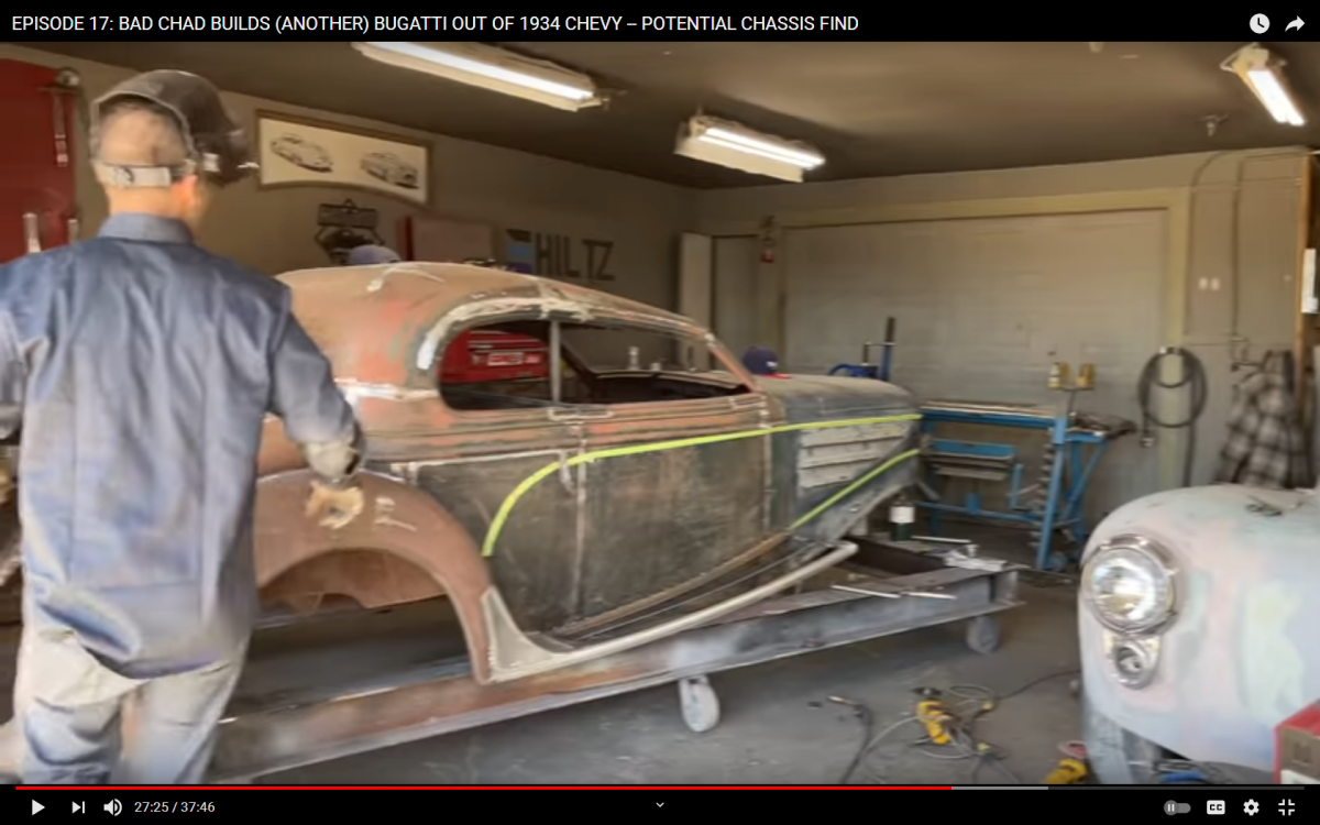

    Hey if you like that "Chevy" Sports car you should check out Bad Chad on You tube, he has vision and could see a Bugatti in a 34 Chevy 4 door sedan. Now he is building it , 17 or 18 days in . It isn't a replica as such just a resemblance, and it's not the first Bugatti he has built you will see the other one he is building from nothing in the background.
    First post was 17 days ago, so 17 one hour You tube posts ( I speed watch them, by scrolling along the time line)
    So from episode 1 a stripped out and floppy 34 body cut into pieces
    to this in episode 17
    J.Ukrop, tb33anda3rd and Six Ball like this.

    Hell no, I would just drive it but if it bothers you Joey, take the cap off and inspect it, dust off the flakes if there are any and replace it , torque it up and drive it.. Model As were designed to be repaired this way. Hell I have a tool (made in the 30s I suspect) for grinding a Model A crank in the car. Never been used , still in it's box.
    I flipped the picture and lightened the thing up so I could get a better look, I reckon there is nothing wrong with it.

    It seems that every time you look into your running engine you find a problem. My advise it quit looking. :eek: Good up date, lots of good advise on the bearing. Pick the one that suits your needs.

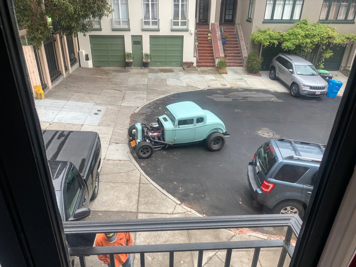

    Hey everyone, I’ll continue the conversation tomorrow, but I just wanted to post a couple of photos from today. After many an hour of planning, searching, measuring, building and testing, the taillight project is complete! I had to roll the roadster out in the driveway to soak it all in before I closed up shop for the night.
