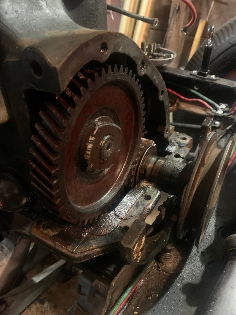

    Unfortunately, the timing gear nut was chewed up pretty badly by the previous owner. I've spent the past two afternoons wrestling with it using a combination of Kroil, Liquid Wrench, an impact driver, a breaker bar, and a hammer and chisel. Despite my efforts, it's not budging.
    I'm keeping the gears in place using the method prescribed by Dan McEachern. IMG_4985.jpg
    Next up, I'm going to order a new tool from one of the major suppliers and get my torch ready. This is shaping up to be quite the project, but I know we'll figure it out one way or another.

    That nut isn't left hand thread by any chance is it?

    definitely not.

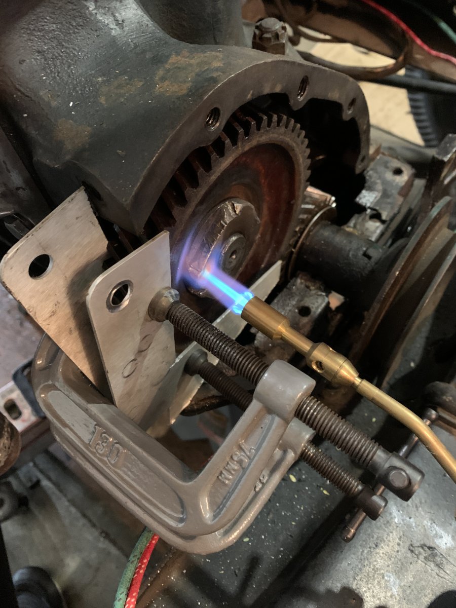

    Although I wasn't really planning to do much on the car today, I wandered down to the garage just to see how things were looking. Well, that quickly turned into me working to get the cam nut off. I turned on the fan, broke out the torch and dove right in.
    After heating the nut for several minutes, I tried using that that cam nut tool. Again, it didn't work. Then I recalled a post on the H.A.M.B. about giving it a good hit with a hammer and chisel. I applied a little more Kroil, just for good measure. One hit. Nothing. Second hit. Wait a second. Did it just move? Yes!
    Like magic, the old nut came off and I cheered. Talk about a satisfying feeling. I can't wait to put a new one on there. Next, I applied some heat to the crank pulley nut, which came off with ease. In order to pull the cam gear, I had to drop the pan. It's amazing how a seemingly simple task soon turns into disassembling much of the engine!
    With the pan off, it was exciting to see the inner workings of my powerplant. For a few minutes, I just laid on the garage floor looking at all the pieces: the crank, the rods, the pistons, the cam, the oil pump and more, all right there in front of me. It was a neat experience that I won't soon forget.
    Anyways, I tried using my vintage Craftsman two-jaw puller to remove the timing gear, but it appears to be stripped. (I bought it used on eBay, so you never know what you're going to get.) Luckily, the local auto parts store had a more contemporary three-jaw puller for rent. I rode my motorcycle over there, and it wasn't long before I brought it back and removed the fiber gear.
    I'm accumulating quite the pile...
    Unfortunately, at the end of the evening, I hit a snag. Despite my best efforts searching online and in the Les Andrews book, I can't find any information about removing the crank gear. There's a Woodruff key that I can't seem to get out. I've tried heating up the shaft and the gear as well as tapping it with a screwdriver. Pliers don't seem to work and the Kroil and Liquid Wrench have no effect.
    I'm wondering—can I just pull the gear without removing the key? Or is it necessary to do this task first? From what I can gather, the car is currently running an aftermarket gear. It's stamped 207AB and "Made in the U.S.A." It seems to be very runnable condition. IMG_5015.jpg
    That's all for now. Any advice would be greatly appreciated!

    I'm no A guru but if it's a straight through key and slot it should pull straight off but some key ways are like half circle groove in the shaft with a matched key and they slide up the key way creating a lock when pulling and the key might need to be tapped back with a pin punch to allow further pulling...I look forward to your experience...glad you got that other one off...the walk away for a moment method paid off...

    You cannot remove the key until the gear comes off the crank. No need to remove the key when installing the new gear. You will need a good 2 jaw puller to get the gear off with the crank in the block because there is not much of the back side of the gear accessable. Putting a clamp across the jaws will help to keep the jaws from slipping. Unless you have a good size torch, I doubt you will be able to put much heat into the gear without getting the crank too hot.
    You can heat the new gear up to about 350 degrees to help it go on easier, much more than that and you will begin to draw the hardness. If you turn the teeth blue color, you have overheated the gear- no more than a light straw color.

    Gotta pull the gear first, it's slid onto the snout over the woodruff key

    You will need to clean up both the crank snout and the key to get that off and the new one on. ( Order a new key when you order the new cam nut.)The gear is a close sliding fit so without removing metal get all the crud off and polish the crank surface so that thing can slide. Use a small fine file on the sides of the key. It may take a couple of pry bars or a couple of small wedges to get the gear moving at first if you cannot get the puller behind it. Whatever you do be careful about pounding on the gear, remember the thrust bearing surfaces are white metal and any pounding will move the whole crank , with the load going through the thrusts. While the sump is off you could check bearing clearances and replace the cotter pins when you retorque .Wipe out any old oil and metal from the tray and the sump, make sure there are no holes in the oil troughs (tray) clean the oil pickup and check the pump clearances. make sure the drain tube at the rear main is clear and all the oil feeds from the timing chest are clear.
    Put new gaskets and rope seals in when you replace the sump..

    getting that crank gear off will be just as much fun as the timing gear. There actually seams to be a slight interference fit between the gear and the crank. Mine was so tight i ended up slitting with a cut off blade in a hand grinder being carful not to grind the crank. I did have my pan off and on a engine stand so it was a little easier to deal with. I made a press fixture to push the new one one using the thread in the end of the crank instead of beating it on with a hammer.

    I will add that these are almost all an interference fit (hole is at or slightly smaller than the shaft) so any gunk or burrs will increase the effort. Also, get GOOD replacements (woodruff key, anything else), there is a lot of cheap hardware out there that does NOT belong in a lawnmower, let alone a car.
    Rent or borrow a puller and installer for the gear.

    What the others said. The gear will come off with the key in place. Pull them off, press them on. Use some heat to expand the gear but not the shaft. Clean & check everything. It'll be easier putting the big gear on the new hot cam before you have it in the engine. :rolleyes: You are this far why waste all this work and have it run the same? A good cam with your carb and header are the most change you can get for the investment. It gets complicated and expensive after this. A few thousands off the head and you're a real hot rodder! :D:cool:

    I would be very careful about any heat to the crank gear, remember you have a babbitt bearing right behind
    it, and it won't stand much heat before it melts. Like the guys have stated, use a good gear puller and it should
    come off. Some good advise on this thread....

    Most heat guns range in temperatures between 200 to 1000 degrees Fahrenheit, the babbitt main reaches a plastic
    state at 415 degrees. These are poured mains in the model A's, thus the reason to be cautious with heat....
