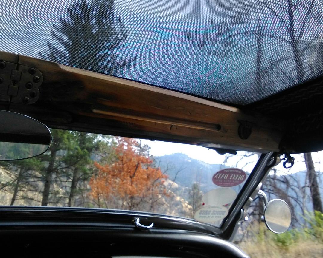

    I am now about 4000 miles into this adventure. I am thrilled, couldn't be happier. Probably the best thing I have done to the car since I've owned it. Met all the parameters. And, as many guys had lectured,...I'm inclined to leave it on. But,.... let me qualify.
    With the top on, it's still almost like driving a Roadster. With the mesh, 'tho filtered, you get the full view almost like a Roadster. With the full opaque top, the view is as if from a coupe. The diff. is, the full Roadster view vs looking at the world through a "slot",...like a Coupe.
    The mesh sheds water pretty well too. Forgetting to cover it one night after too many beers, a heavy marine layer in Oregon left all of the cars dripping. About half of that water got through the mesh. But not as bad as a topless car, the
    interior was pretty wet. Nuthin new for me!
    That said, the mesh sheds water quite well at speed. Got caught in a heavy downpour later that day. A downside was, the visor affects an air flow that directs the water, usually wrapping over the top of the windshield, downward and blows it in my face through the gap at the cowl. Easy fix with a rubber gasket or,.....duct tape.
    I encourage all y'all whether topless, with folding or rigid tops, to consider this feature. Ya know, the sun's ain't giving up on tryin to kill you. It's almost like not
    giving-up that which we love about our open cars.
