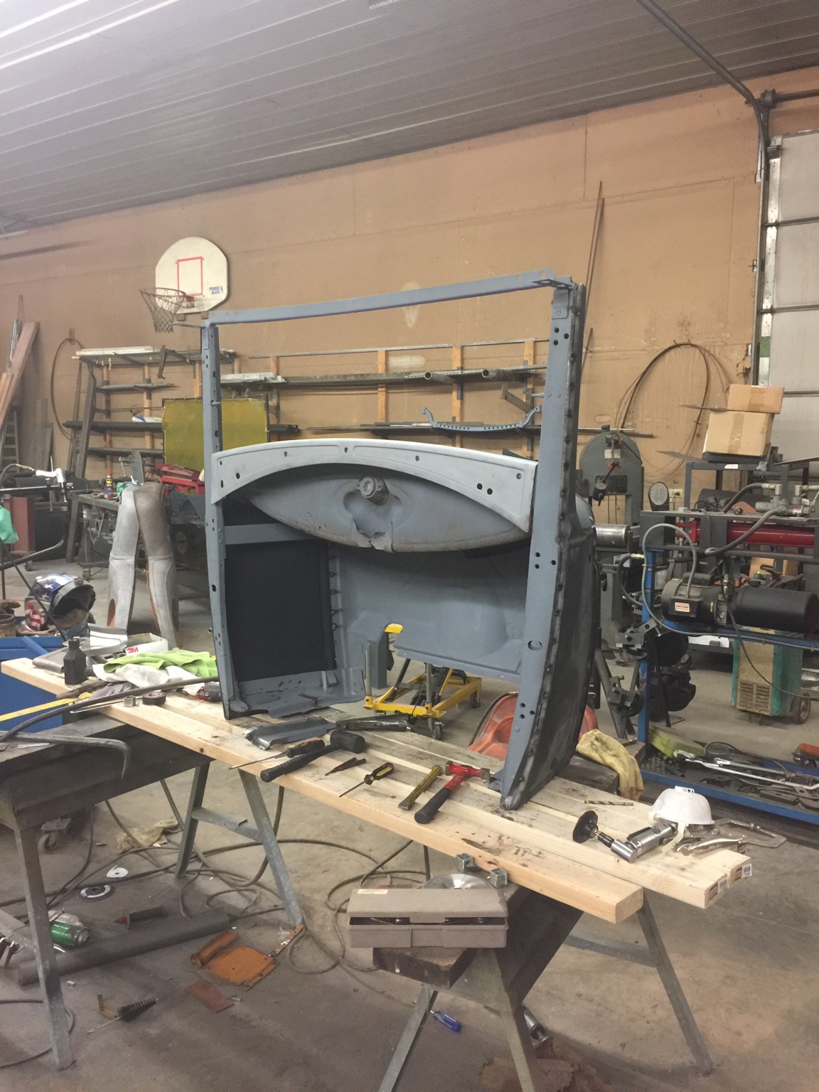

    So I had a chance to play at the shop the last couple of days. It's slow going but still forging forward.
    [​IMG][​IMG][​IMG][​IMG]

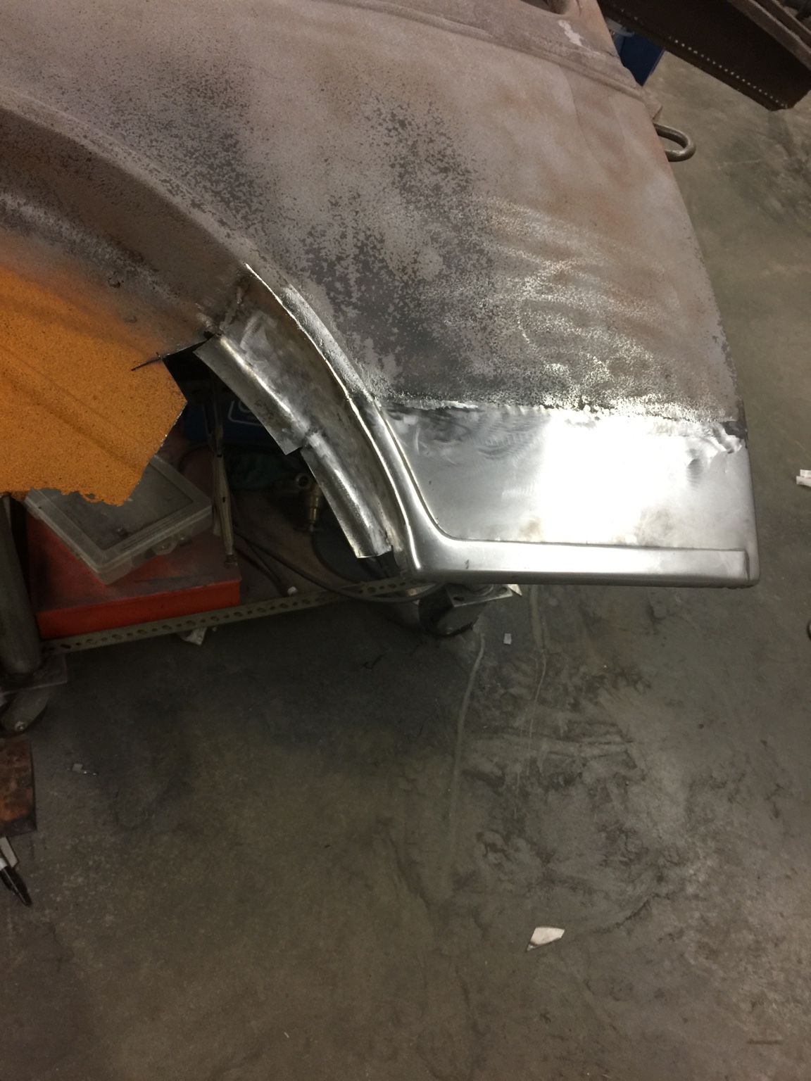

    It is slowly getting there. It was a real PITA to try and find a starting point. Basically, the bottom of both large panels were so trashed and wasted that there was no way to know where to cut. I didn't have a reference point in which to put the new patches.After a LOT of head scratching and back and forth between the mock up and the weld table, I figured out the correct starting point and started cutting. The other problem is that the patch panels were nowhere near a perfect match. A lot of hammer and dolly work to get them to line up. They actually look better in person. The pics give off a glare that makes the lines look off. They actually are real close.
    Had to also make a few tools that were contoured to the beads in the panels.
    One thing that did make for some fun was using a planishing hammer I built this past year. It worked like a champ and was fun. I hope to jump on the driver side tomorrow morning after my son's soccer game.

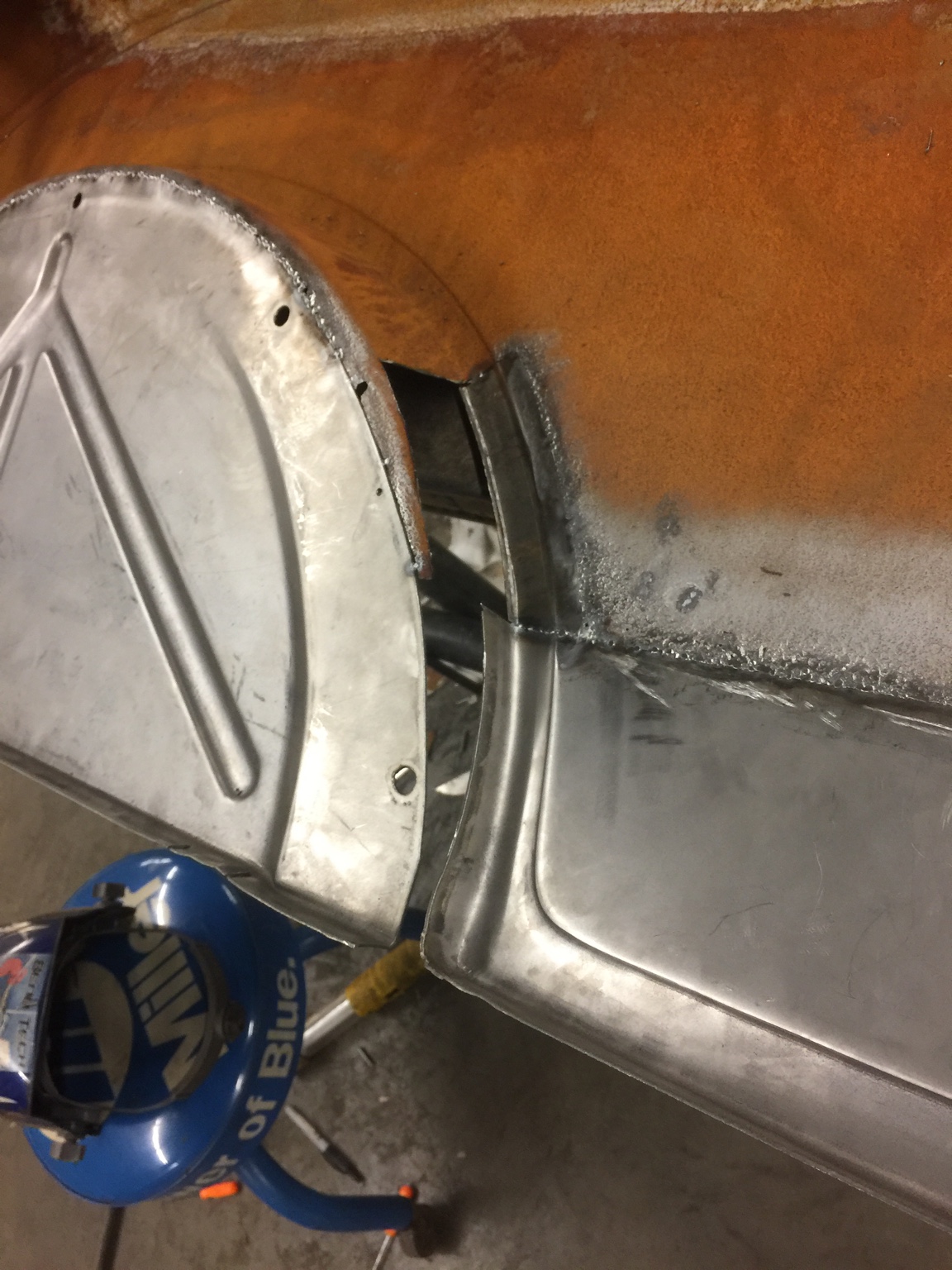

    Had some time to get on with the Driver's side. This panel had a lot of warping. Of course all the patch panels were off and needed work too.
    Rear top is just sitting up there. [​IMG][​IMG][​IMG][​IMG][​IMG]

    You can see how far off the lower rear is off. I had to add 3/16" piece to make it the same width as the actual body panel.
