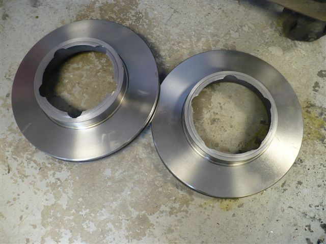

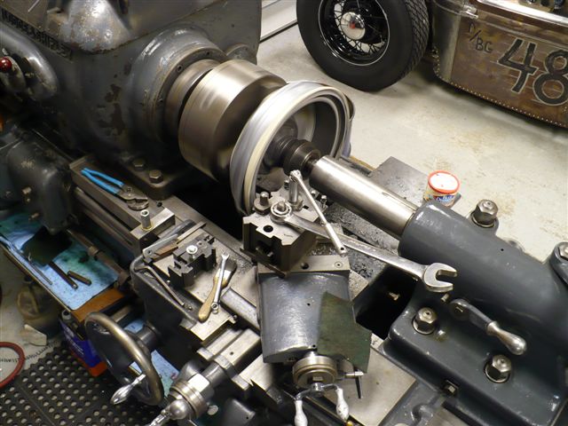

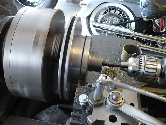

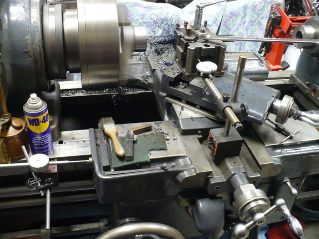

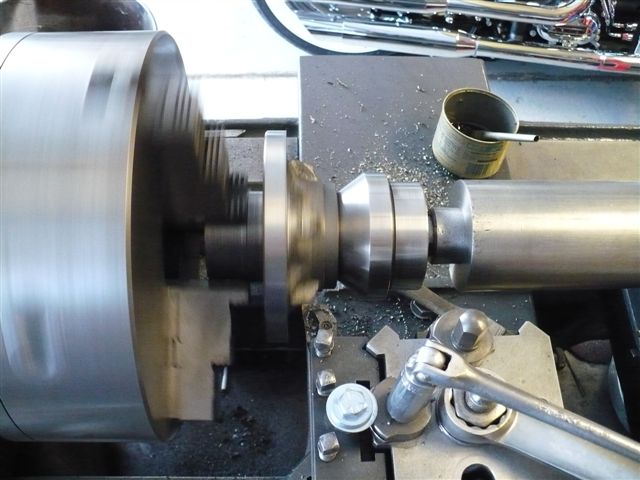

    #2, #3, #4, #5 This is the Camaro rotor in the lathe, parting the rotor
    from the hub. #5 shows him chamfering the rear side
    of the "new" hub flange.

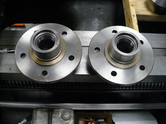

    OK, the outer bearing snout on the hub where it meets the flange has a straight, machined surface which is slightly larger in OD than the snout itself. Brian was going to make two (two drums and two hubs) indexing rings to center the drum on the hub. The ID of the center hole in the Buick drum is larger than the OD of the machined surface on the center snout on the hub. He machined these two rings out of a piece of raw stock. He ended-up sizing the ID of the ring a very few thousandths smaller than the machined surface of the hub snout for an interference fit. He cut the OD of the indexing rings a couple of thousandths TOO LARGE for an interference fit in the ID of the center hole in the Buick drum. Once he had sized the ring stock he made a chamfer cut on one inside edge of each ring. This chamfer is to clear the small radius at the transition between the flange and the machined, mounting surface on the snout so that the ring will fit flat against the flange when pressed-on. The next five pics will show Brian machining these two rings.

    Here is one of the finished rings being heated slightly before being pressed onto the machined surface of the snout. Note the chamfer, which goes to the inside and against the flange. Both rings installed on the two hubs. The surface of the aluminum DRUM with the large hole in it where the drum will eventually mate with the hub flange is quite thick, something over 1/4" as I remember...much thicker than the same area of a comparable STEEL drum. Here you'll see Brian heating the vertical face of the drum at the center hole to slightly expand the hole for the interference fit over the indexing ring. When he does slide the drum on the hub, he's careful to index the drum on the hub with the five original Buick lug holes "clocked" half way between the CHEVY 5 x 4 3/4" holes in the hub. This is important for the "new" bolt pattern which still remains to be drilled in the drums. It's also important for the permanent attachment method of the drum to hub which is still to come. Final pic in this batch shows the drum pressed onto the hub via the indexing ring, from the back side. Look closely and you'll see the chamfer on the rear side of the hub flange which he did in the first batch of photos.

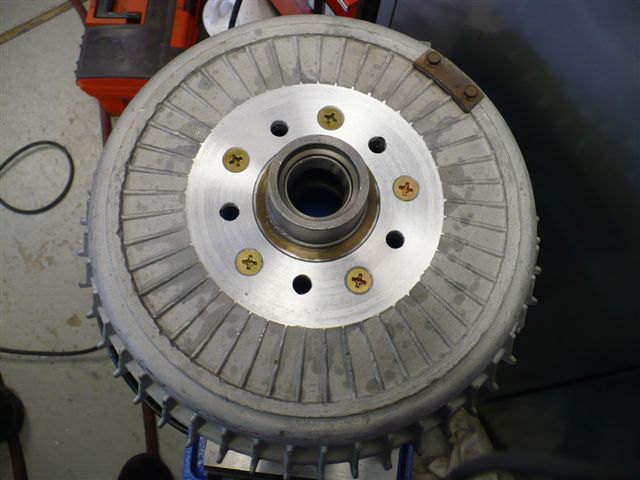

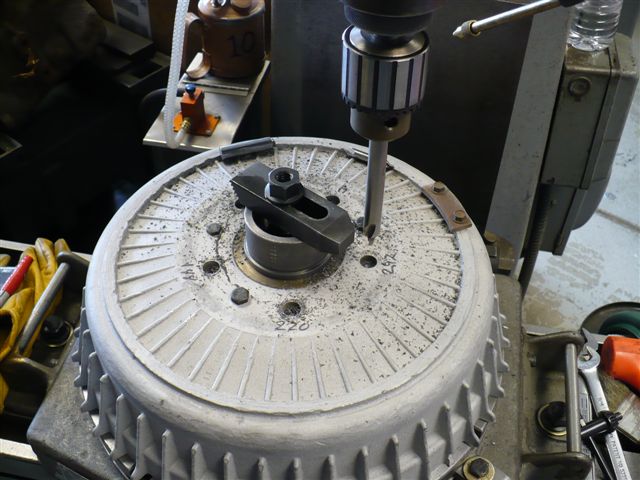

    Putting this together is slow-going for a HAMB neophyte like me. Hope you all can bear with me. There's still more good stuff to come. Anyway, the next few shots show Brian making a fixture so that he can clamp each assembly to the table on his mill to finish the rest of the machine work, which essentially includes drilling and tapping the hub through the original Buick bolt pattern stud holes. You'll note three bolts which are temporarily clamping the drum to the hub to make them "as one" for the next machining operation. The THREE holes he used for this are the ORIGINAL holes that were used to rivet the Buick drum to the BUICK hub. The bolts are kind of skewed through the three rivet holes and into three of the five holes in the hub that will eventually become the CHEVY 5 x 4 3/4" bolt pattern that we're going for. The final shot in this batch of pics shows him countersinking that thick aluminum for the countersunk machine screws that will bolt the drum securely to the hub. More to come...

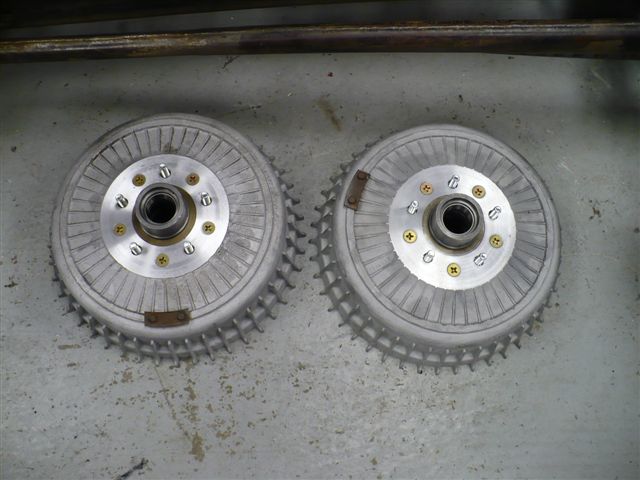

    The first pic in this batch shows the five countersunk machine screws installed and tightened which effectively make the drum and hub one piece. Next, he mounts the drum assembly in the lathe to FACE the wheel-mounting surface so that the wheel runs straight with the world, in other words, no chance of wobble. Next, you'll see him drilling through the CHEVY bolt pattern hub holes THROUGH to the aluminum drum wheel-mounting surface, so that he can now install the new studs. Next, he TURNS the drums to make sure the shoe surface is true to the world. In this shot, it's not hard to notice HOT ROD PACKARD's beautiful, famous ol' Hot Rod Magazine cover car in the background. Many of you who have seen this car in the flesh know what a craftsman/genius Brian really is.

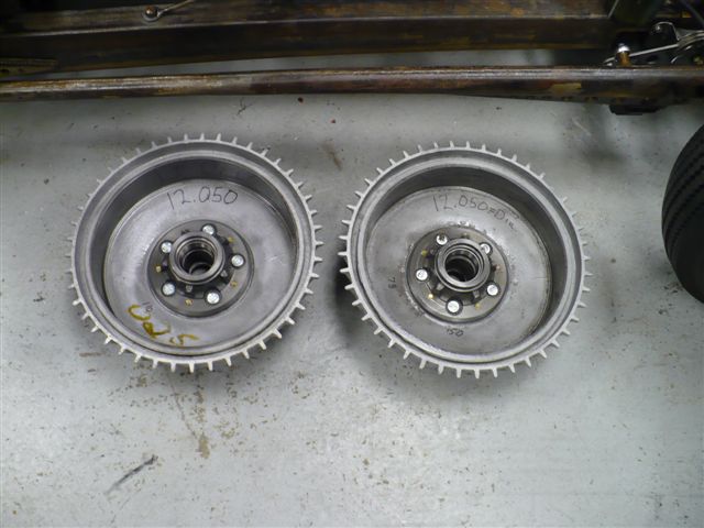

    In this last batch of photos, we see the finished product, both front and back...beautiful! Next, we see one of the drums mounted with the backing plate...and it turns WITHOUT rubbing on the backing plate. Finally, we see what this looks like, ready to bolt a wheel in place. Just want everyone to know that I put a little thought into the WHATS and especially the WHYS of doing these this way. Brian put the expertise, knowledge and precision care into making it happen so well. You'll note that the end product turned-out with NO extra holes like you see so many times when a drum has a new bolt pattern drilled into it. Brian's forethought made this happen the way it did. He DOES have his shit together. Many thanks, Brian.
