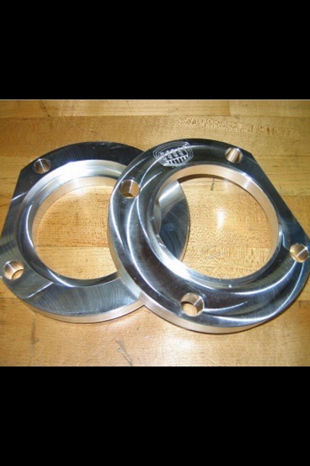

    In order to use Buick backing plates on ford spindles you need to use 58 to 59 Buick backing plates and enlarge the center hole and use a adapter that spaces the backing plate out. I got my spacer from Karris Customs .

    Buick backing plate 1958, 1959, and 1960, . Hot Rod Works in Idaho used to make the adapter/spacer ring, don't know if they are around anymore. I think the print for these things was floating around on this site,

    Yes these appear to be the 58 to 60 Buick backing plates like I am using. I welded the four mounting holes up and ground smooth and ordered a set of 58 to 60 Buick backing plate to Ford round back spindle adapters from Karas Kustoms for 90 dollars. The center hole in the backing plate is to small so take them and the adapter to a machine shop and they will chuck up the backing plate and enlarge the center hole to fit the adapter. Then put round back spindle, adapter and backing plate together and drill new holes to match spindles for mounting. Then you need 46 to 48 Ford hubs and they mount outside the drum. There is an article online from an old edition of Street Rodder I believe that covers all this. Try Googling it if you get a chance.

    Karas Kustoms adapter
