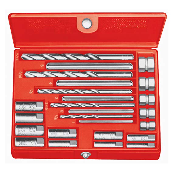

  17. saltflats
    Joined: Aug 14, 2007
    Posts: 12,602
    saltflats
    from Missouri
    I have had good luck with these.
