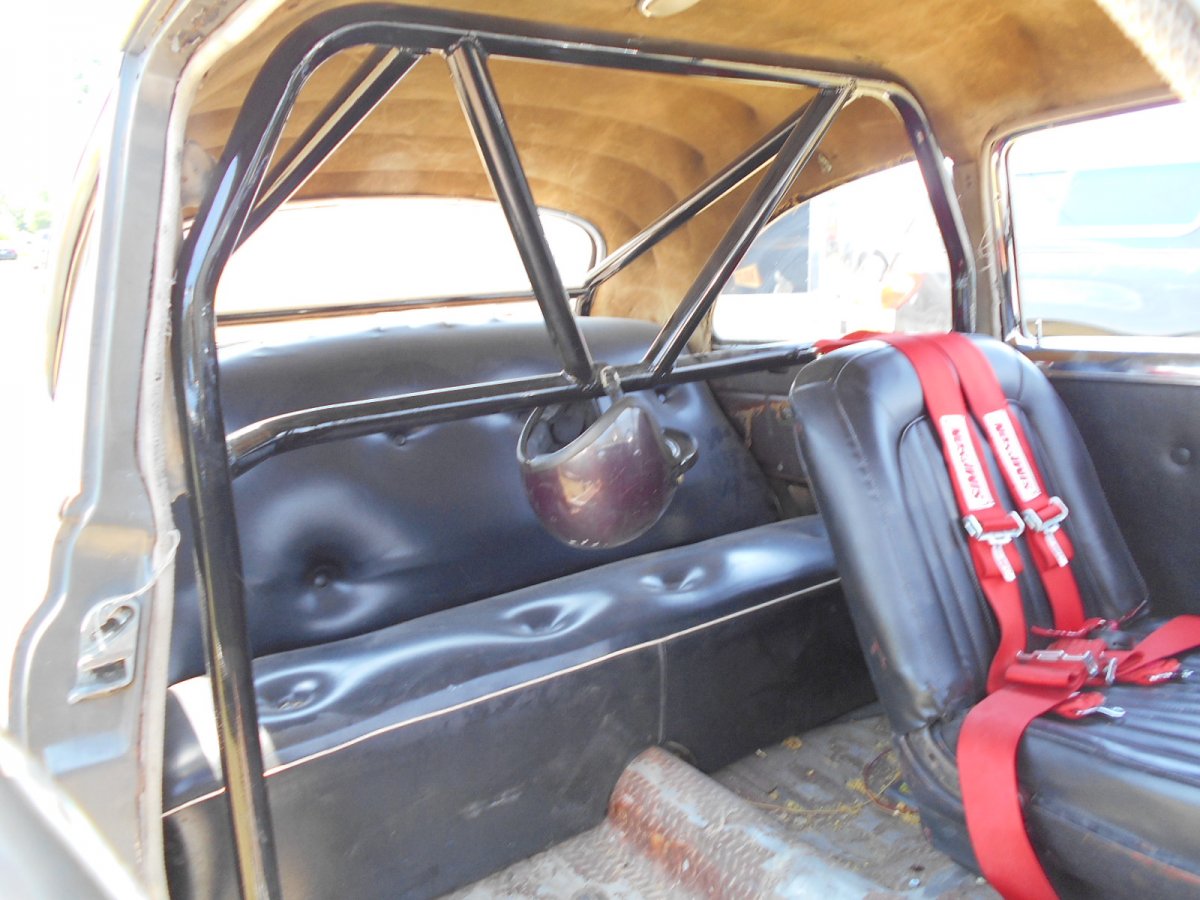

    2 things: I don't mind the wide whites, but (imho) don't think they look good on aluminum wheels. And, who's gonna fit in that back seat? Cool car though. I like it.

    In the end it is important to note, this car will not win any awards for appearance. The entire car will remain in primer as I found it after 45 yrs of storage. This will not be a race car built from all new parts hidden under the old shell. Everything that we can reuse, we have. Items were replaced for safety purposes only. The reason no one will fit in the back seat is because there wasn't any rollbar and I do not have a death wish. No one needs to set in the back seat because "THIS IS A RACE CAR". AND I DRIVE IT FROM THE SEAT IN THE FRONT, YOU KNOW, THE ONE BEHIND THE STEERING WHEEL.

    If its a race car it would have the seat [BACK] removed for weight savings.

    "" "THIS IS A RACE CAR". AND I DRIVE IT FROM THE SEAT IN THE FRONT, YOU KNOW, THE ONE BEHIND THE STEERING WHEEL.""

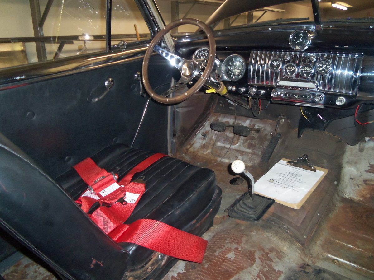

    I agree. Unfortunately the original builder didn't take it that serious, I guess. My job here is to preserve, protect and restore this vintage original gasser. The original owner first modified the car to a semi-custom street car. He added light custom touches most likely purchased from suppliers such as J.C. Whitney. He added chrome door frames that snapped over the original frame. He added a chrome cover that snapped over the glove box door. There is a chrome cover over the steering column. These gadgets and bling items seem to indicate the owner was not a hard core installer of speed parts. Removing the hood trim and installing an aftermarket chrome strip down the center of the hood implies to me a desire to make his car unique with a limited amount of mechanical skills.
    So, at some point when the car is probably over 10 but under 17 years old, he has someone recover the seats and door panels with a black vinyl material, simulating leather, with large buttons tufted into the seat surfaces. For that reason, when the transformation to gasser began, the owner opted to keep his beautiful back seat and door panels because he liked them and probably paid a good price to have them done. The thought of lightening the load may not have ever crossed his mind.

    Believe it or not we took great pains to install the new roll bar around not through that custom back seat.

    DSCN0348.JPG DSCN0350.JPG DSCN0352.JPG The 51 is now known as "Shifty 51" Most everything has been addessed, car passsed tech by Great Lakes Gasser's at Milan Drag Strip. I need some fine tuning prior to first trip down the track.

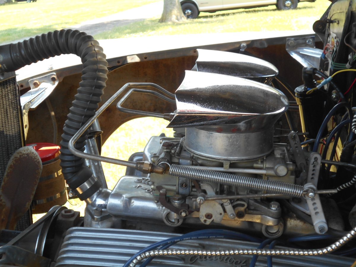

    I hope you are going to change to DUAL throttle return springs with a proper bracket.

    YES, thanks for reminding me. That is one thing pointed out to me during tech but I forgot it.

    After driving the car several times on the open road, I found the steering to be unreliable, it was very herky jerky when trying to navigate curves at 25-35 mph. That will definitely need to be addressed asap. Another issue has been the carbs and back firing. I feel the power valves are blown and I will need to tear both carbs down prior to anymore driving. Quain has ask that I replace the front tires and wheels with slimmer ones aka "front runners". I have been looking and have not been able to find vintage replacements as he has requested. He also wants me to eliminate the alternate side exhaust as it does not follow the Gasser theme. I have pretty much decided to scrap any plans of street driving anyway, so I will modify it to allow removal at the track.
