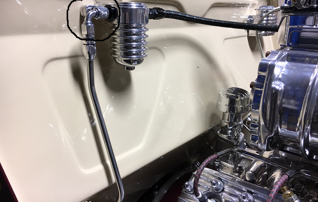

    News alert: Bending and flaring 3/8 stainless sucks ass!
    Down at the regulator
    then up to the filter mounted on the firewall
    That is some tough stuff to bend! And sanding all of the red and blue anodizing off those fittings and polishing them sucks as well.

    Just to save you a bit of time and fingerprints, to remove the anodizing without sanding, submerge them in regular easy off oven cleaner for about 10-15 min. Removes the anodizing, but may turn the fitting black, but that comes off easy with a quick once over with a wire brush. I find that much easier and quicker to get those ugly colors off, esp in the nooks and crannies.

    Bandit Billy that has to be some of the tightest shortest bent section of tube between 2 fittings I have ever seen. How in the heck did you get it that short with two fittings on it and still get it to bend? Your doing a hell of job on this one!

    If you're asking about this bend, I believe that's not something that he bent, more likely a manufactured bend.

    yes, that part is a Russell fitting, you are just used to seeing it anodized blue and red. I painfully stripped and polished it prior to install. That line had to make a fast move toward the ground right there to look right.
