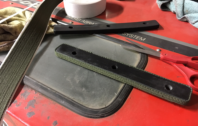

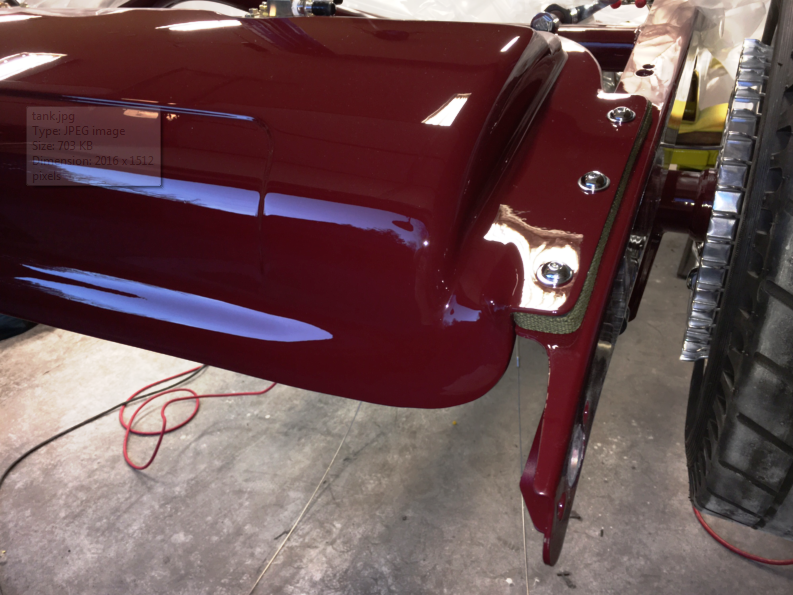

    I got off a little early (no one was looking so I snuck out the backdoor) and I headed home to get a little work done. Progress pics attached for your viewing enjoyment.
    The tank is done being polished so I thought I would stick it in and start working on the stern. The tank sits on some rubber blocks I made for two reasons, to set it closer to the body and show off a bit more of the QC. The rubber spacers/isolating blocks aint much to look at One idea I had was to sew them up in leather but for now I wrapped them in woven frame insulator as an experiment.
    Hell, beats black rubber.
    Next, add the tank.

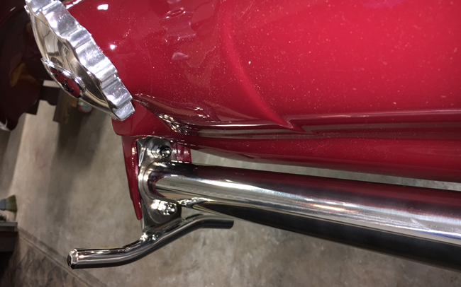

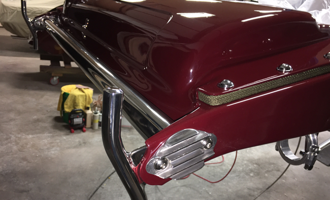

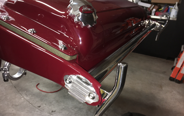

    You can see the work on the tank and how it hugs the frame now. I had to trim the frame horns a bit to make it look correct.

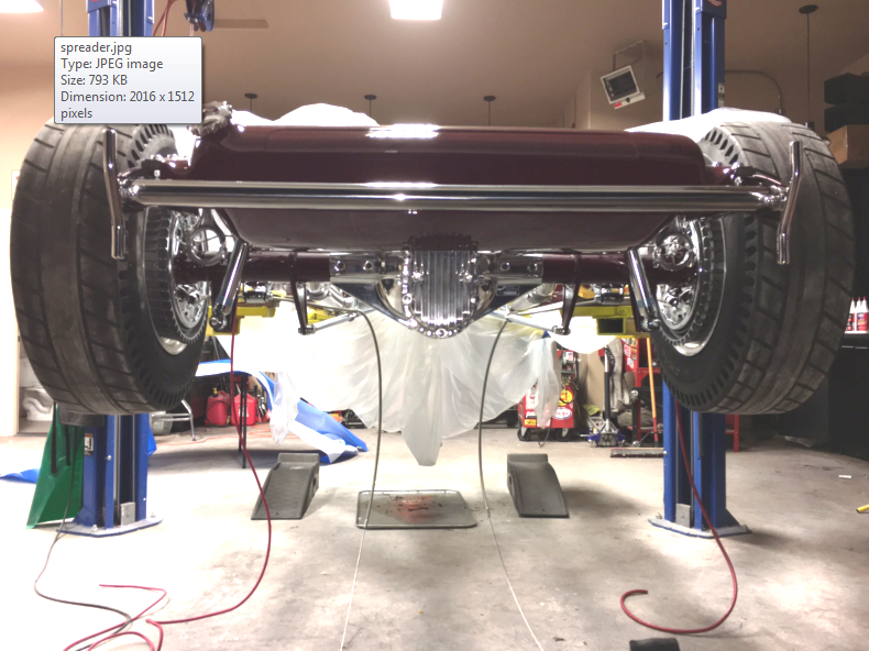

    Now, add the spreader and nerf bars all of which took a lot of fabrication.
    Those finned aluminum, frame covers took some major work as they are 32 fore items. I had to weld up the original holes, re=drill them for the frame, then weld up the frame holes and re-drill them so the damn things would sit parallel on the frame horns.
    Sorry the pictures are so dark, it gets late early here :cool:
    Here you can see the gap I created by moving things around. There was more gap here before we painted!
    Here is one from behind, no "full diaper" and this is a 16 gallon 32 ford tank. The plastic car cover is to protect the motor while the oil pan is off from the polishing going on in the garage today.

    Bandit Billy what a great idea for gas tank insulators! I might have to steal that sometime in the future...

    I made my radiator mount pads out of the same block of rubber and I will wrap them like that as well. The radiator mounts show a little under the front inner fenders since I trimmed them a bit to add a little grace to their design up front.
