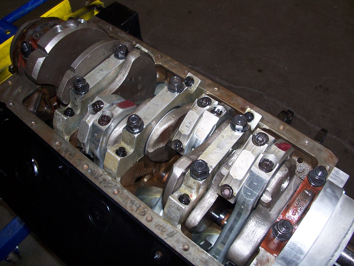

    Still the issue at hand is Although you are building this for yourself and have the ability to do so for whatever reason, If it does not correct an issue or make more power, how would one justify the added cost to the customer?

    I think Nick knows what he is doing, and since he's building this engine for his own use and utilizing machinery and skills that are his, if he wants to put straps on all 5 mains, that's his business, and I, and I suspect others here, are interested in seeing how he does it:):cool:

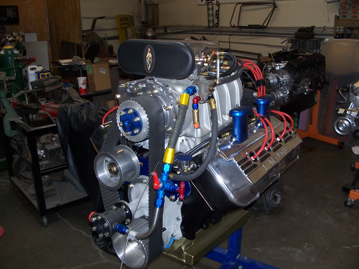

    Never said it was good or bad, just wanted to know his reasons for doing it as I (and all the iron motors I have done) have never seen anyone/builder doing it even with blown nitro 100_1012.JPG 100_1056.JPG
