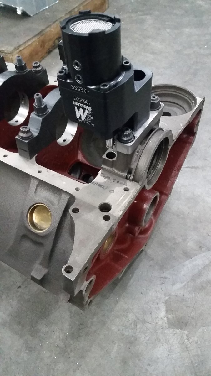

  2. What's the canister thing in the valley?
  3. J. A. Miller
    Joined: Dec 30, 2010
    Posts: 2,065
    J. A. Miller
    from Central NY
    Baffle for PCV

    Some of the earliest PCV systems that had the valve on rear of intake used that baffle cannister, but it was there and used with road draft tube from '55 on up until the PCV valves came out.
    Later, mid '60s, block was changed and that hole was eliminated. In post #238 is an early block with the earliest PCV adapter in the hole where a road draft tube was fitted in earlier years. Some of the other pics you can see the hole with nothing in it

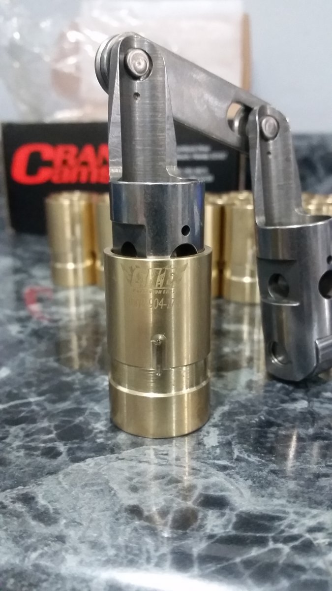

    Finally ponied up and spent some money on some lifters. Crane Cams has always been really good to me with all the Early Hemi stuff I do so I found a Pro Series lifter they offer that will work perfectly with what I'm after. These are .904 "Mopar" diameter lifters with centered pushrod cups. With a larger diameter lifter they typically will have a larger roller wheel that will handle more spring pressure and last longer. I know these are excellent lifters as we have run them far past their recommendations with great success. Like to thank Robert for a great deal on these lifters for my own personal build - Thanks man!
    Next step will be to finish machining the bronze lifter bushings with a oil slot and drill a smaller hole to feed each lifter. This essentially makes the oiling system to full time oiling the way I'm doing it with the band around the bushing. I have to be careful that it doesn't line up with the hole that feeds the pushrod hole directly.

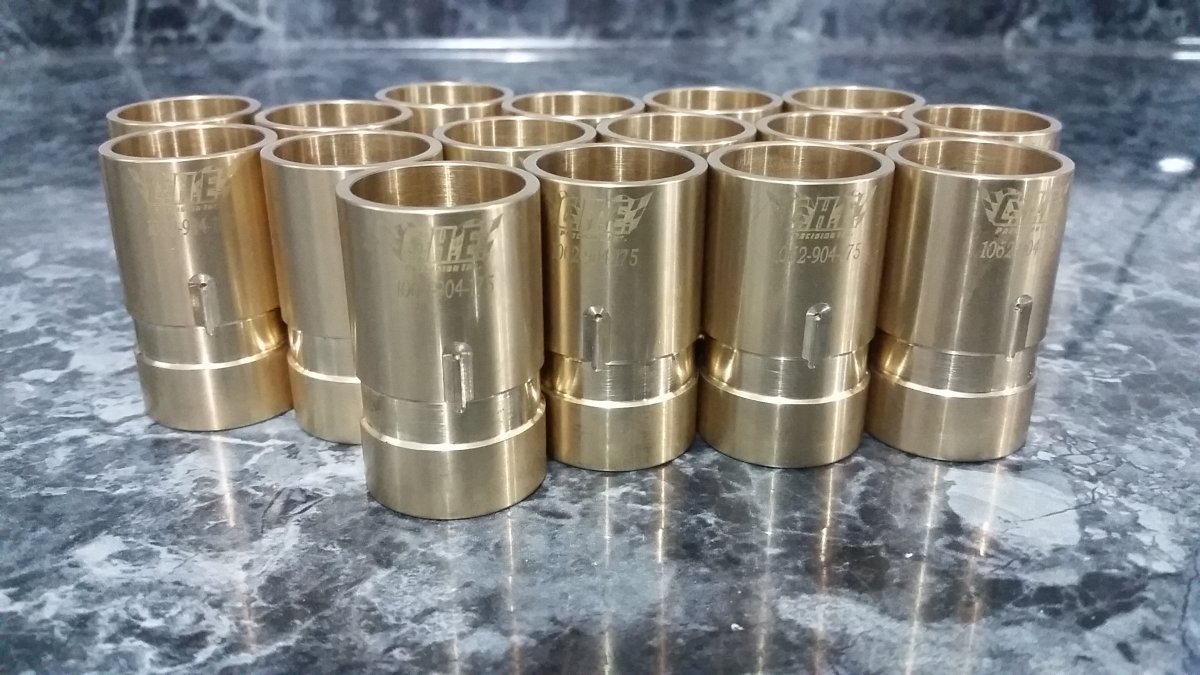

    I've been buried with work and just not in the mood to tackle the mountain of work I have ahead of myself in my shop. Tonight I took some time for myself and machined these bronze lifter bushings on my mill.
    Nice to have a rotary table, comes in handy! Also used a lifter bushing driver and used my stop on the backside to make setups quick and repeatable. Here I'm using a 3/8" ball endmill to machine a groove about .300 long. This passage is to offset the band a little for the lobe lift I plan to run.
    Here I'm drilling a #58 hole which is around .040 in size. Seems small but in reality under pressure the stream is rather large.
    First few turning out as I hoped.
    Batch of bushings are fully machined and ready for installation.
    I plan to clock the bushing like in the picture. I don't want my orifice to line up with the pushrod feed hole, that would be a bad thing. Offset enough to help feed the thrust side for each bank.

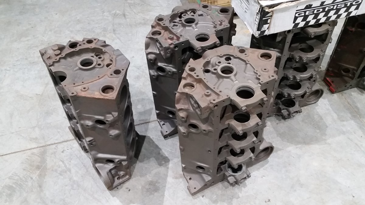

    I acquired some mid 90's Comp Eliminator crankshafts. One is a Callies and the other is a Lunati which appears to be a modified LJ 327 GM Crankshaft. Both of these are 3.160 stroke, 350 main size, and SJ Rod size. I've been rethinking my combination as of right now but I potentially may take some stroke out of one, turn the mains down to a 283 main, and convert to a Honda Rod pin. I have time to sort it out yet and a Plan B......
    I also decided on a Melling Billet Oil Pump that has the Shark Tooth Technology (basically a helical gear vs a spur gear) so it is supposed to be far smoother running. This is also far lighter as well.
    Also ended up with a full sump Kevko pan that has a nice big kickout. The pump clears this pan, close fit that may require some further modification.
