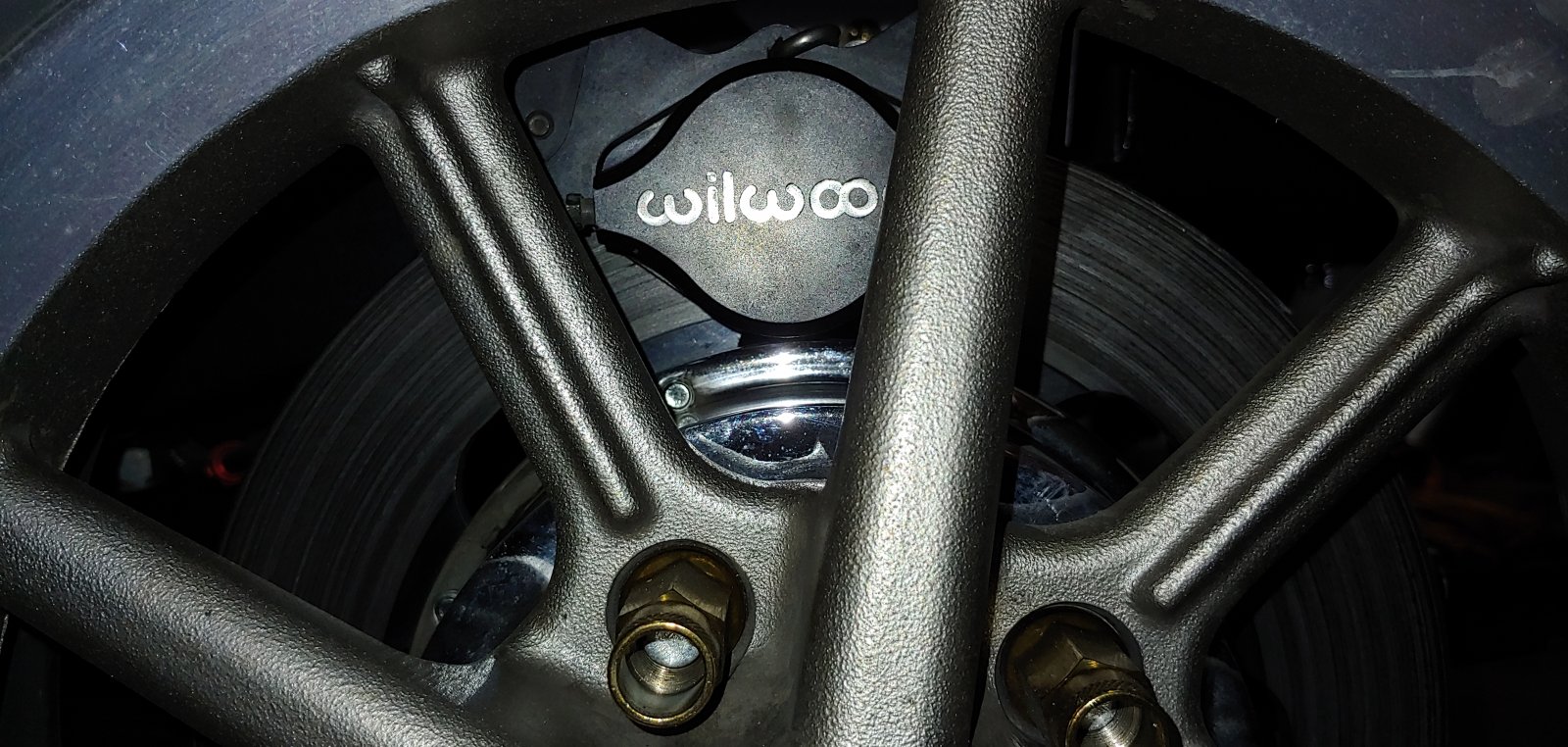

    I used the original Willys spindles coupled with a- believe it or not- 5-4 1/2 trailer hub, heavier lugs, matched the bearings, added an SKF seal 16667 .5 -wider to cover the lip of the spindle, added a Wilwood hat with an 11.25" disk, and wrapped it all up with a pair of ET spokes. I did this all in 2001 because no one I knew had any knowledge of this swap. This is a project I've had since I was 16- long before buying shit off the shelf was available and we had the luxury of H.A.M.B!
  9. cahaldo
    Joined: Sep 30, 2010
    Posts: 11
    cahaldo
    from Wisconsin
    I also made my own caliper bracket and made spacers to line it all up with. The entire axle assembly including tie rod, etc. are chromed just to make it look nice. And, oh yes, I'm now 70 and still have it.
