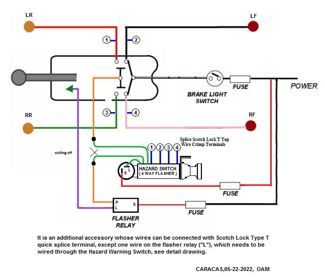

  2. Hello everyone, I'm from Caracas and I would like to collaborate by attaching the following installation diagram of the hazard light switch ( 4way flasher), using as a base the drawing presented by Bob Jones--Fat Fender Hobbyist-- (bobj49f2). ADDING HAZARD SWITCH 4 WAY IN CLASSIC CARS.png
