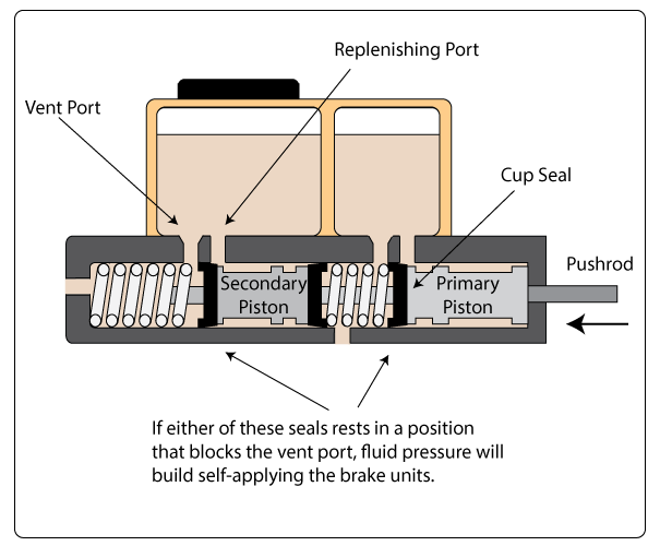

    master-cylinder.png master-cylinder.png A little explanation on what the guys are saying.
    With no return spring the weight of the pedal assembly puts a bit of pressure on the brakes. The spring pulls it back so there will be just a little freeplay between the push rod and the piston.
    The adjusting the push rod, same thing, you have to have that bit of free play or it can push the piston just enough to cover the return port between the cylinder and the reservoir not letting the fluid go back in.
