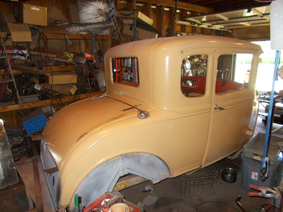

    Nah. Not much has happened on it for a few years. Got married, got a mortgage, had kids, work away, rebuilt an eh holden to sell to earn a bit of extra spending money. So the model A build has slowed up a bit.[​IMG]
    Sent from my SM-T805Y using The H.A.M.B. mobile app

    body looks in good shape! but yeh man ill let ya know if I'm ever heading up there!
