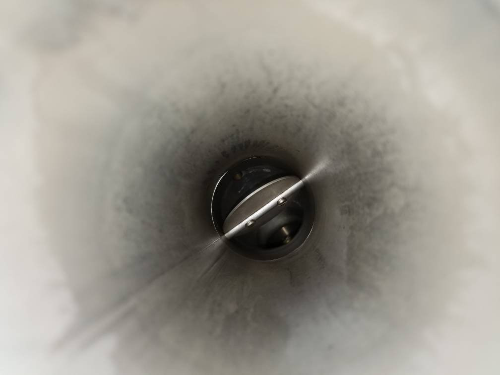

  5. I did find one cool thing tearing it down. It's always felt real lazy in high gear I thought it was clutch issue but I'm pretty sure it is a throttle issue. The return spring pulled the bracket away from the intake causing it to hit the pedal stop about 90% open. Can't wait to see what that does to my ET. 20170819_111546.jpg

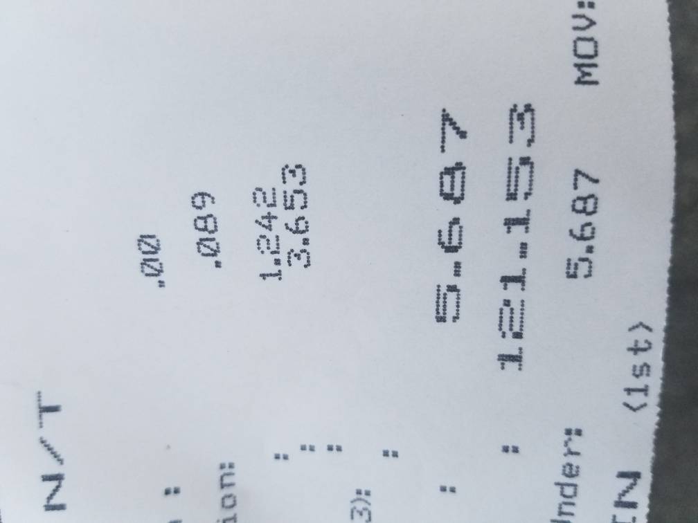

  11. Quain you are rite shady side was the only race my car had good MPH went 121 there. Every race after that only went 117 118. Oh don't worry I'll be ready for ya I'm a lot better on the tree so u won't get a 1 car head start on me so u better turn that old willys up. Might want to reconsider that taking that Jimmy Huff Ford power if you don't want to have to read my saying on my trunk lid all the way down the track

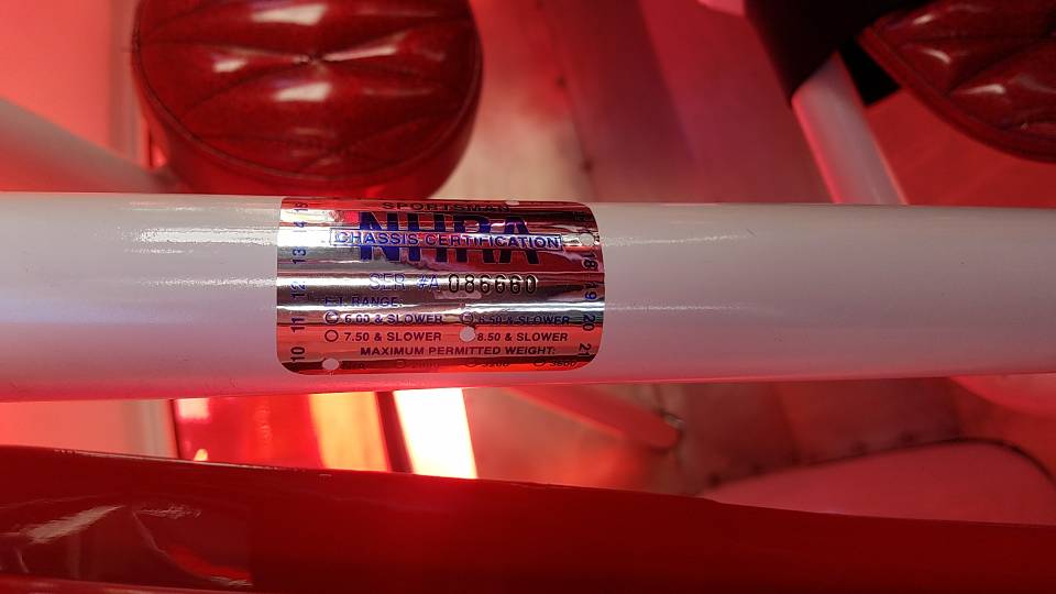

  17. Got the motor back last Friday. Put it in last Sat took 5 hrs to get it in and running. We didn't dyno it this time not enough time the engine builder was going out of town and is to busy at the shop. Got .010 thicker head gaskets, 5 new valves and cam timing changed. Sounds better than ever. Took it to get the chassis certified on Sunday and passes with flying colors. Feels pretty good seeing that shiny sticker on the cage saying I'm good to go 8.50s. Hope to take it to the track before Shadyside Nov 4th to make some liscenses passes. Otherwise I'll be testing it out at Shadyside Nov 4th in North Carolina. 20171008_140957.jpg 20171007_143556.jpg 20171007_154241.jpg 20171007_143549.jpg
