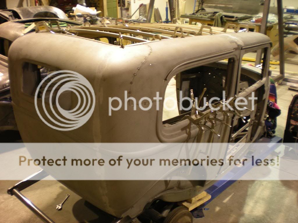

  24. Salt Flats Speed Shop
    Joined: Sep 30, 2007
    Posts: 1,474
    from Utah
    Ive been working on getting the new roof pieces spliced into the body. Ive almost got it to the point where I can start chopping the top. Just got to get all the wood in place, and start laying the chop out.

  26. NOTCH
    Joined: Apr 19, 2006
    Posts: 663
    NOTCH
    looks frickin cool Man!
    Cant wait to see it chopped
  27. 6X2
    Joined: Feb 18, 2007
    Posts: 114
    6X2
    Well done sir...thanks for keeping us posted!
    How many friggin vise grips do you own?
  28. -Brent-
    Joined: Nov 20, 2006
    Posts: 7,379
    -Brent-
    Jeesh, what happened, did the cleaning lady die? :D
    Car looks good.
  29. Salt Flats Speed Shop
    Posts: 1,474
    from Utah
    she must have been living in your model a coupe, and left when you took it home. I'm hoping she comes back when your coupe returns to the shop. :)
