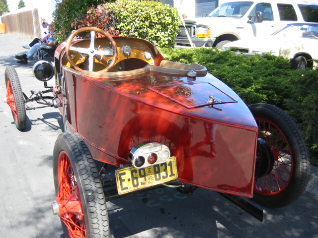

    Here is some pics of the coolest boat tail speedster ever built (in my opinion) the rear end pics shows you one way to deal with covering the chassis.

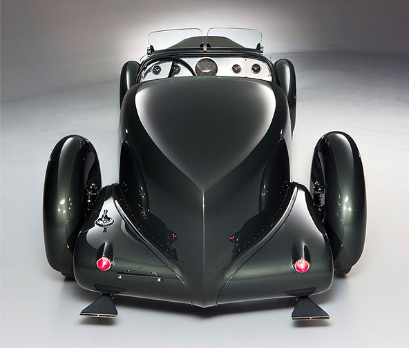

    When ever anybody mentions a boat tail auto this is the first thing that comes to mind.
    Doc :p

  11. bonez
    Joined: Jul 16, 2007
    Posts: 3,487
    bonez
    from Slow lane

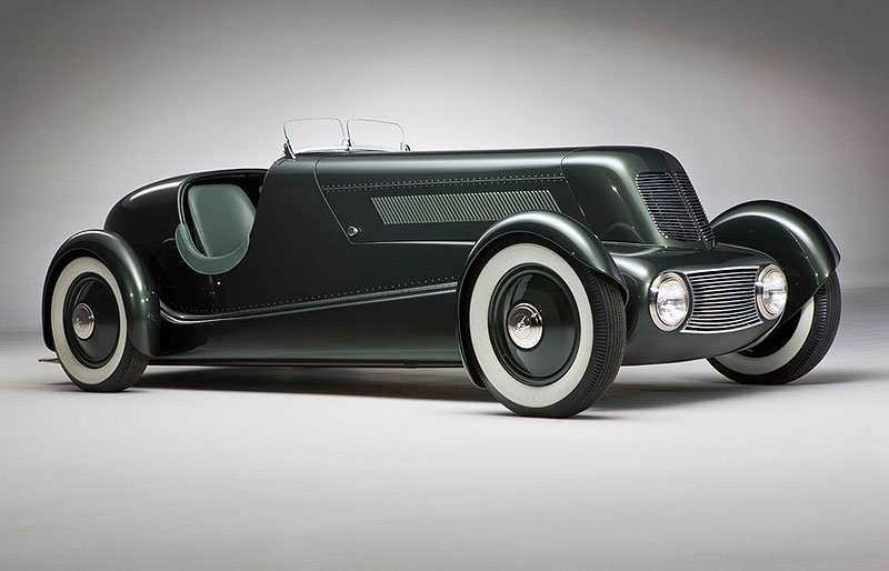

    whats the story on this? I think i really like it.
  12. That's Edsel Ford's second speedster, based on a (1933) Model 40 chassis, designed and built by Bob Gregorie.

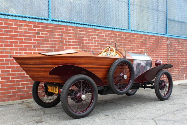

    To my mind a proper boattail has always been something different to a streamline or sports-racing tail. A proper boattail is just like a boat's bow, like the Amilcar skiff in Banjeaux Bob's post, with a distinct deck defined by the beltline, and quite a lot of tumblehome below.

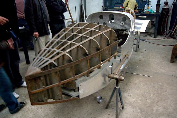

  27. bugatti T35 wooden skeleton
