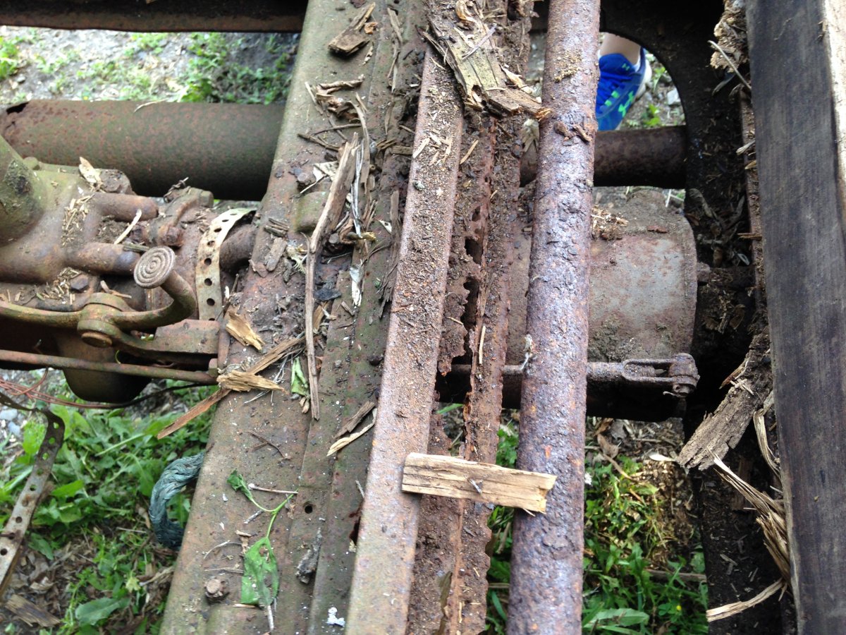

    Just got this dragged out of the bushes and was hoping for a little info. Gas tank is in the cowl, 20 inch wire wheels,12 leafs in the front spring. Transmission has a unit bolted to the back of it, a overdrive? I'll get some pics when I get it home, was it a truck or car?

    It has like a rocker pedal in front the seat that goes back to the overdrive unit?

    Looks like a mixup of parts to make the truck. Some 28 - 29 chassis parts for sure. The unit behind the trans is a "hi/low" unit not an overdrive.

    More close up pic's would be nice, especially of the tranny split box you speak of...

    Stopped and took some more pics

    Boy, you sure plenty of leaves in that front spring, must ride like it was solid...
    Thanks for the extra pic's.
    You got 28 truck wire wheels, but car front axle, the trucks had a heavier axle.
    The diff is a 28/29 style.
    Could not pick what the split tranny was but some others will know.
    Looks like it is made up of several model A truck and car year parts.
