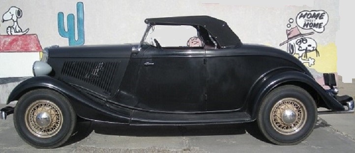

  20. Hi Ben; Yes it has been a while hasn't it, time sure flies by when you are having fun. I been running it around town for a year or so but, still lots to do. Pic is in Needles Cal, down the road a ways. Been on light duty since the hospital stay so probably won't get much done this winter. Maybe some wiring like turn signals.
