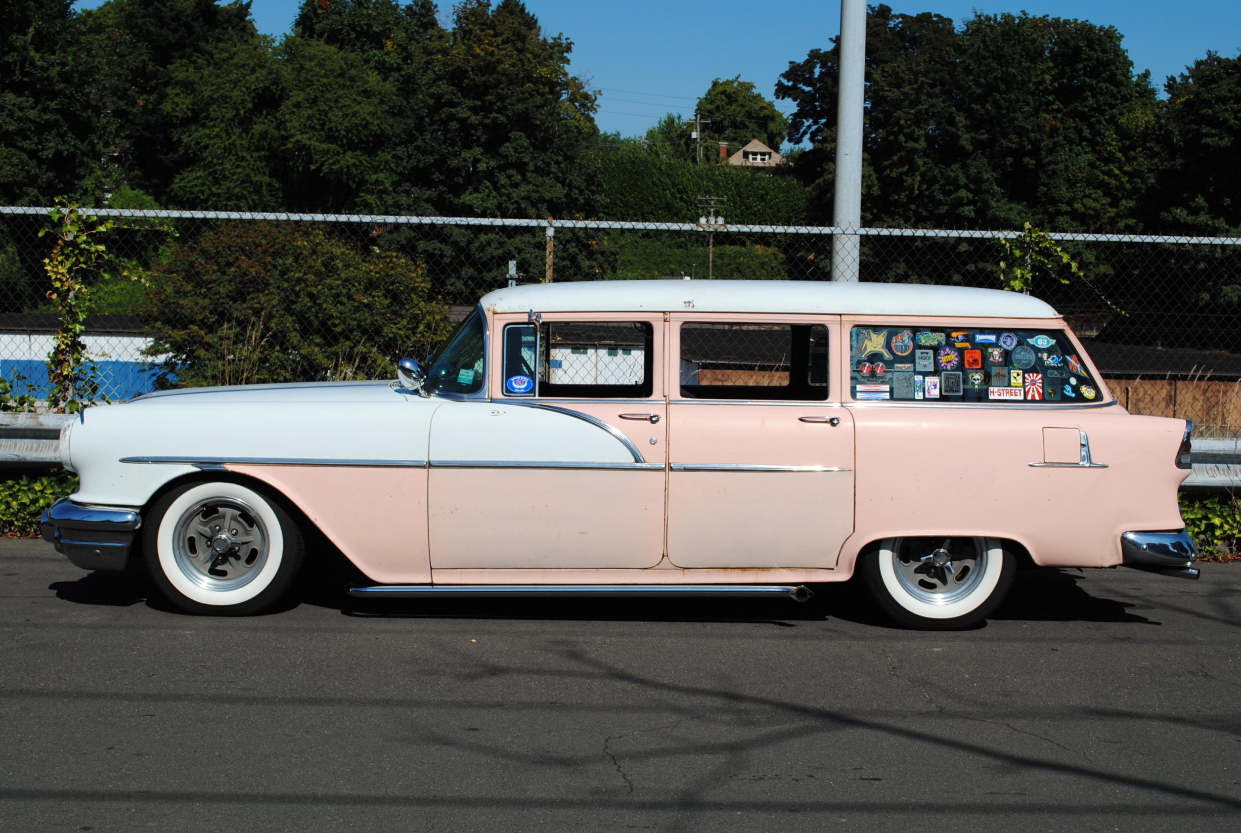

    The one I had took 3 coils to give it a moderate rake.. Still road great though.....
  12. graverobber63
    Joined: Sep 8, 2004
    Posts: 4,134
    graverobber63
    Alliance Vendor
    Cut 3 coils and it still drove nice? Got any pics? how much did that drop it?
