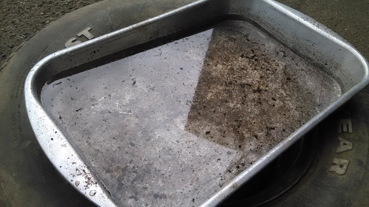

    Hey guys, hoping for some advice on what gear oil I should dump in my '55 Chevy 2 door wagon rear axle. Here is the deal-
    The car been sitting for probly 20+ years and the rear axle was brim full of beautiful, crystal clear, water. I pulled out the diff and cleaned it up and it seems the old gear oil slime pretty much protected everything from rusting up. Everything turns freely but there is a little pitting on the ring gear teeth. At this point I just want to put new wheel bearings/seals and a new pinion seal on and run it. Sorry to get long winded but I figured all this might play into my big fat question-
    Is there any super great gear oil I can use to help my ancient, slightly pitted, diff live as long as possible? I'm trying to get this car on the road before our local cruise week so swapping rearends or rebuilding it isnt really on the table. IMG_20160429_104717.jpg IMG_20160429_103636.jpg
    Thanks in advance.. -John

    I would take it all apart and clean/inspect thoroughly before using
    BigChief likes this.
  3. ^^^^^ yep and when you have it clean fill with 90wt gear lube unless it is a posi then you 90 wt specified for posi traction.

    I would not use any of that center carrier or the rear axle housing, for long term use. The entire rear end housing will be almost impossible to descale inside the axle tubes, and the rust flakes will be coming loose and ruin any expensive bearing overhaul you do.
    If it's just a short trip to a cruise, clean things up with diesel best you can, fill with 90w and get your butt looking for a donor complete rear as soon as possible :) lol
  6. Yep just straight 90 wt gear lube. You will have to set it up if you tear it down.

    I would just rinse it off well with solvent, put it back together, put the cheapest 90 wt oil in it, and take it for a test drive and see how it sounds. And then think about what rear you really want in the car...lots of guys end up with something different.

    So if you're just wanting it to last for 1 week for an event, I'd clean that 3rd member up with some solvent as best as you could, reassemble the axle and fill it with diesel fuel and move it around enough to slosh the diesel around and wash down the interior, then drain and refill with SAE 90 (or 85W-90 if you can't find straight 90) GL-5 gear oil. Run it for the event, and then plan on either a full tear down for bearings and seals, or find a replacement.

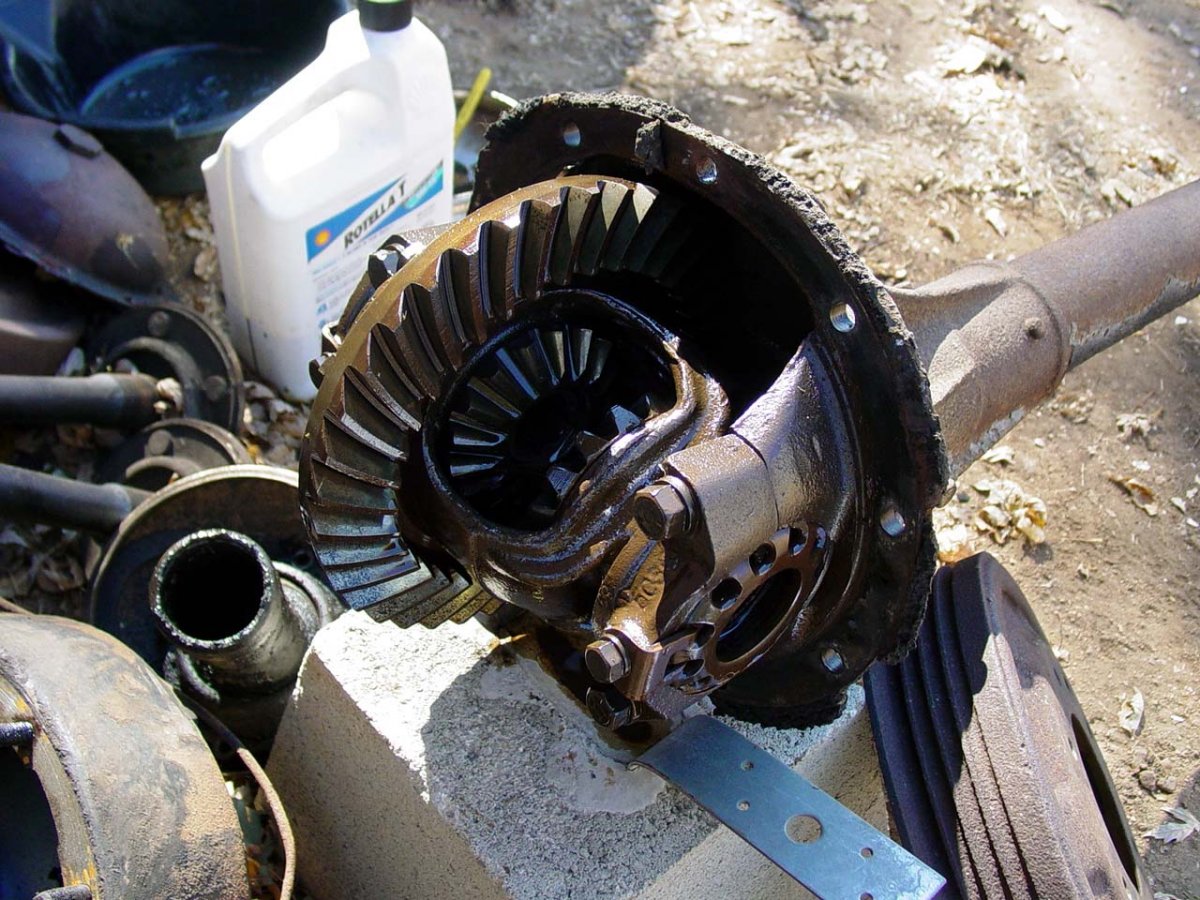

    My 48 original 4:11 gears looked like this (see photo and pitting) when I replaced them eventually with a 1954 3.55 torque-tube and gear section that had little use.
    Draining both the transmission and the rear produced brown water, when I first got into it.
    I just refilled them with GL-4 rated gear oil (GL-5 is OK for the rear) and drove it for another 1000 miles before it was time to replace them during my drive-it-while-rebuilding project of 2007.
