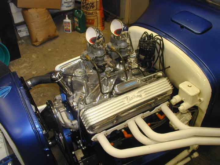

    you could always modify a stock manifold..

    Outstanding execution! THAT looks great!!! Much, much better than a bolt-on plate for a 4 barrel manifold!

    So where would one find a manifold like that? That's not a typical backyard mechanic job, those were done by someone who knew what they were doing. If I could find someone with that kind of talent, I would ship them a stock SBC alum. manifold and have them make the modifications.
