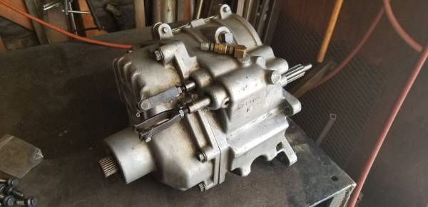

    To answer your question, my 2-speed quick change gearbox is a standard shift. Low for leaving the pits, high for racing. Pictures attached. Note that the counter shaft is above the input/output shafts; maybe to allow for lowest possible location of dry-sumped engine? Cutaway view shows where the QC gears go, but the gears are not shown. These were made by Doug Nash/Richmond Gear, but some British company took over manufacture 15-20 years ago.

    Thanks for sharing the 2 speed. Im familiar with some of the Richmond gear but have never seen anything like it before either.

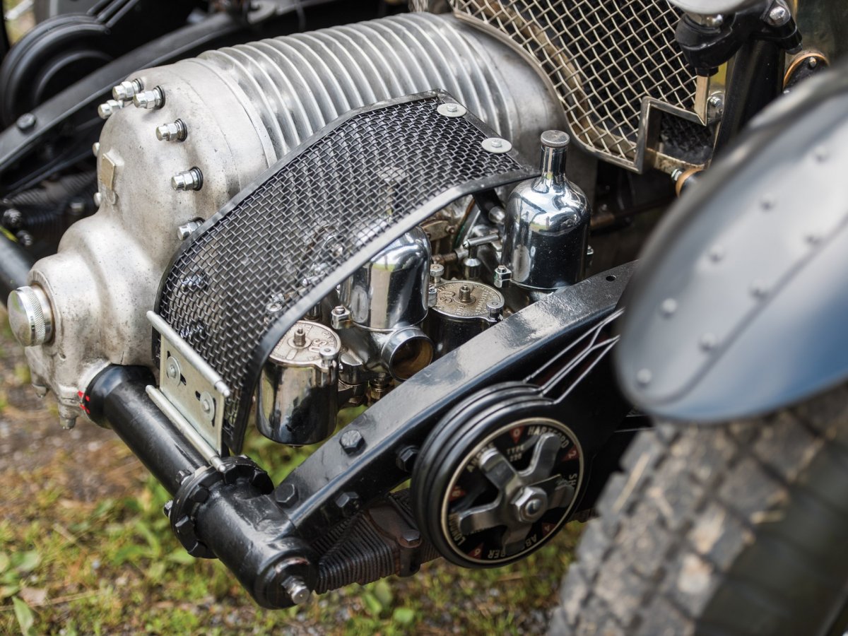

    Skinner unions on a blower Bentley circa 1931. 73ba993783b3ecae4acef5f2f809d695bbc57cd2.jpg
  16. plym_46
    Joined: Sep 8, 2005
    Posts: 4,018
    plym_46
    from central NY
    Just noted the fender detail revited stiffener piece.
