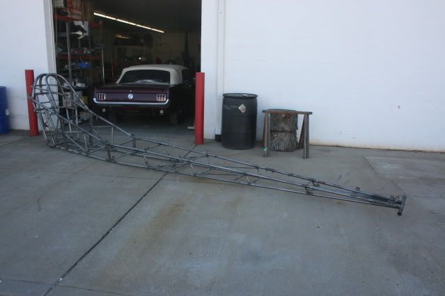

    Lower frame rail bend has been calc'ed and bent. Perfect fit! Other side tomorrow night and then we can start tack'n this shit together....
    BITCHIN!!!
