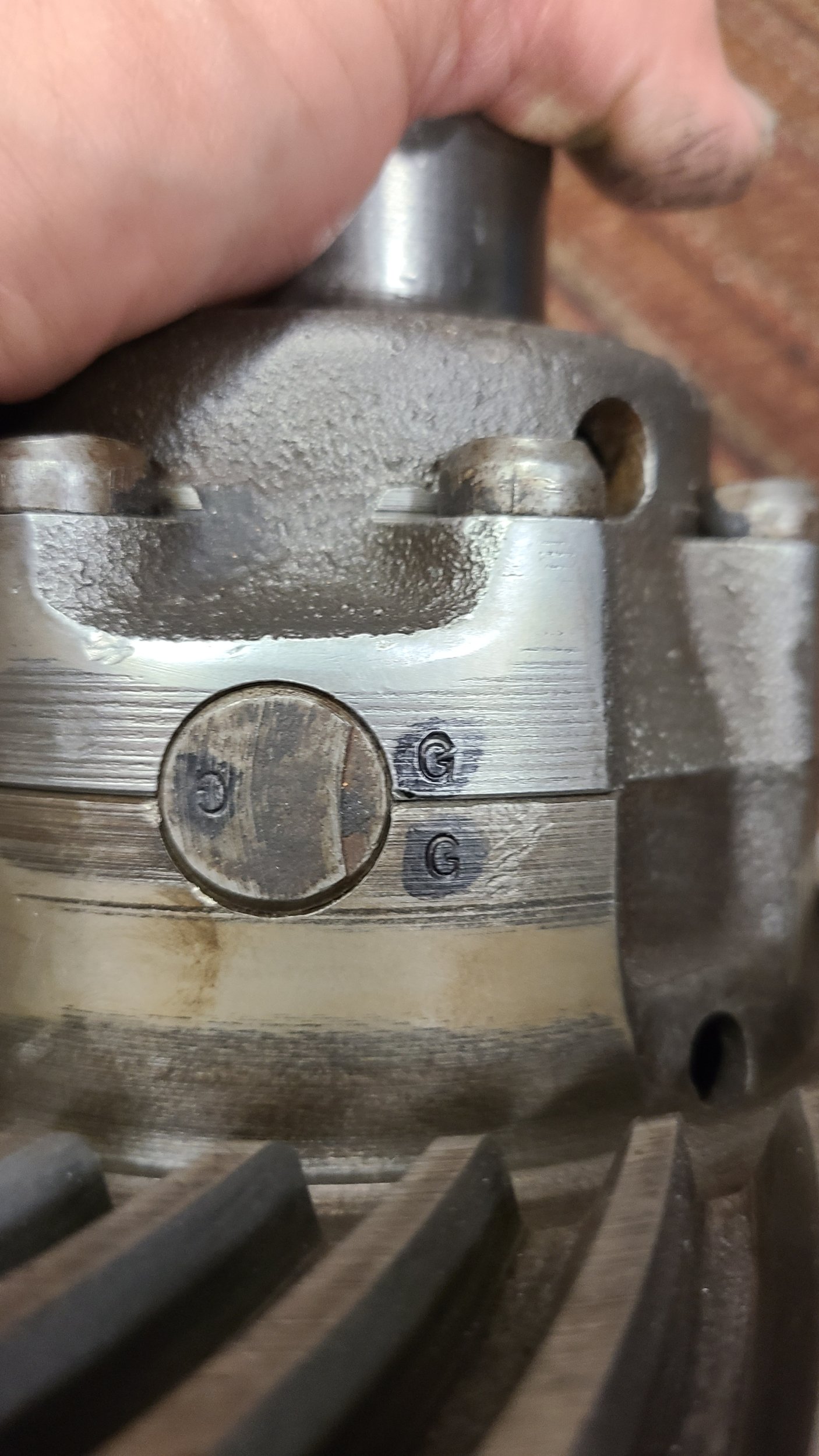

    Forgot to mark the carrier halves when I stripped this banjo rear . What is the worst that can happen? Any tips on solving placement?

    Well you have a 1 in 4 chance of getting it right... or look at colors, markings that might indicate the way it was before. The cross bar may not matter.

    You might also put the two halves together, and see if your fingernail can catch on the spider gear machined surface halves. Maybe one position over another with show better fitment. If in all 4 positions it seems seamless, maybe no harm?

    I agree, a really close examination may show some kinda witness mark, and if not it must be close to new!

    I even have my cross pin inverted, but it's not final assembly. 20250720_144304.jpg

  10. Look close for any kind of matching stains, discoloration, or nicks; there should be something that stands out. Kinda like sorting unmarked main caps.

    Someone is smarter than me. The top punch mark isn't entirely obvious but the parts mate together so well in this position that I can lift the top half and the bottom sticks.

    Could this be a match for stain alignment?

    That's not the parting line.

    No, that's not his part. It's mine to show an example. And, that's not the parting line, where my greasy thumb print
