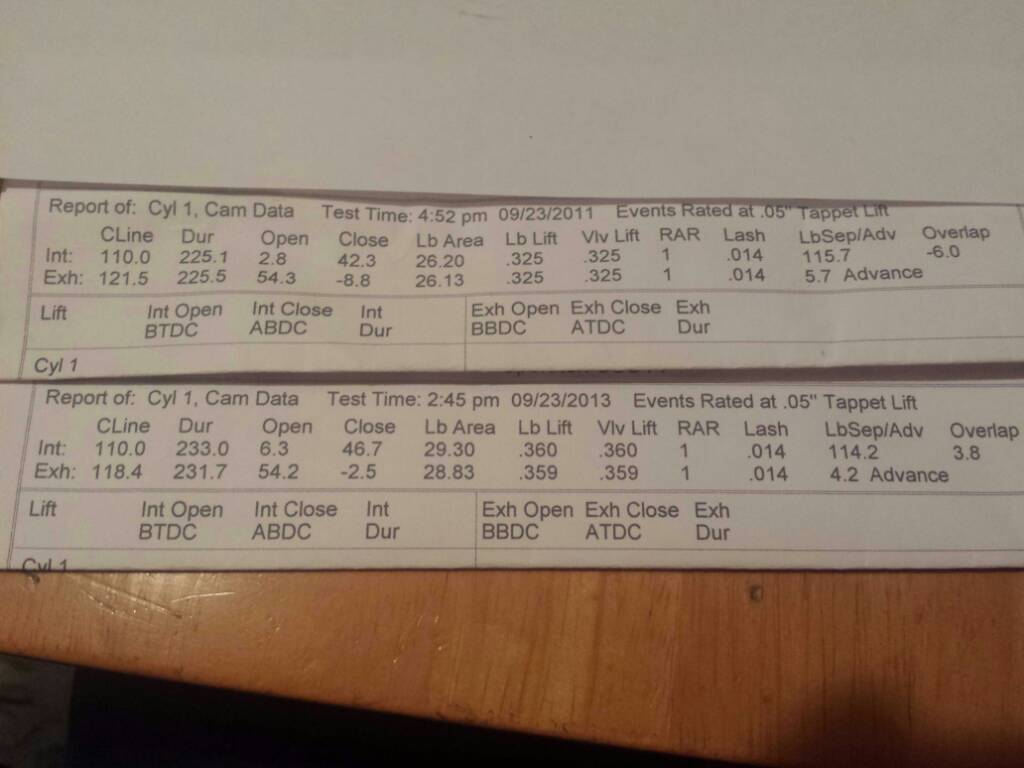

  14. Anyone have any input on these 2 cams? I had 2 good cams I was given checked out. These are them. Either of them worth running? 6:1 head. Winfield b downdraft.
  15. they seem a little short on duration to me, compared to camshafts that are available currently. thoughts?
  16. I will be running an identical setup; Winfield 6:1 head & SR-B carb. I went with the Brierley SU-1R cam (266*/.350"). I believe Mr. Brierley uses masters from Ed Winfield himself - and the 1R cam was designed with this combo in mind.
