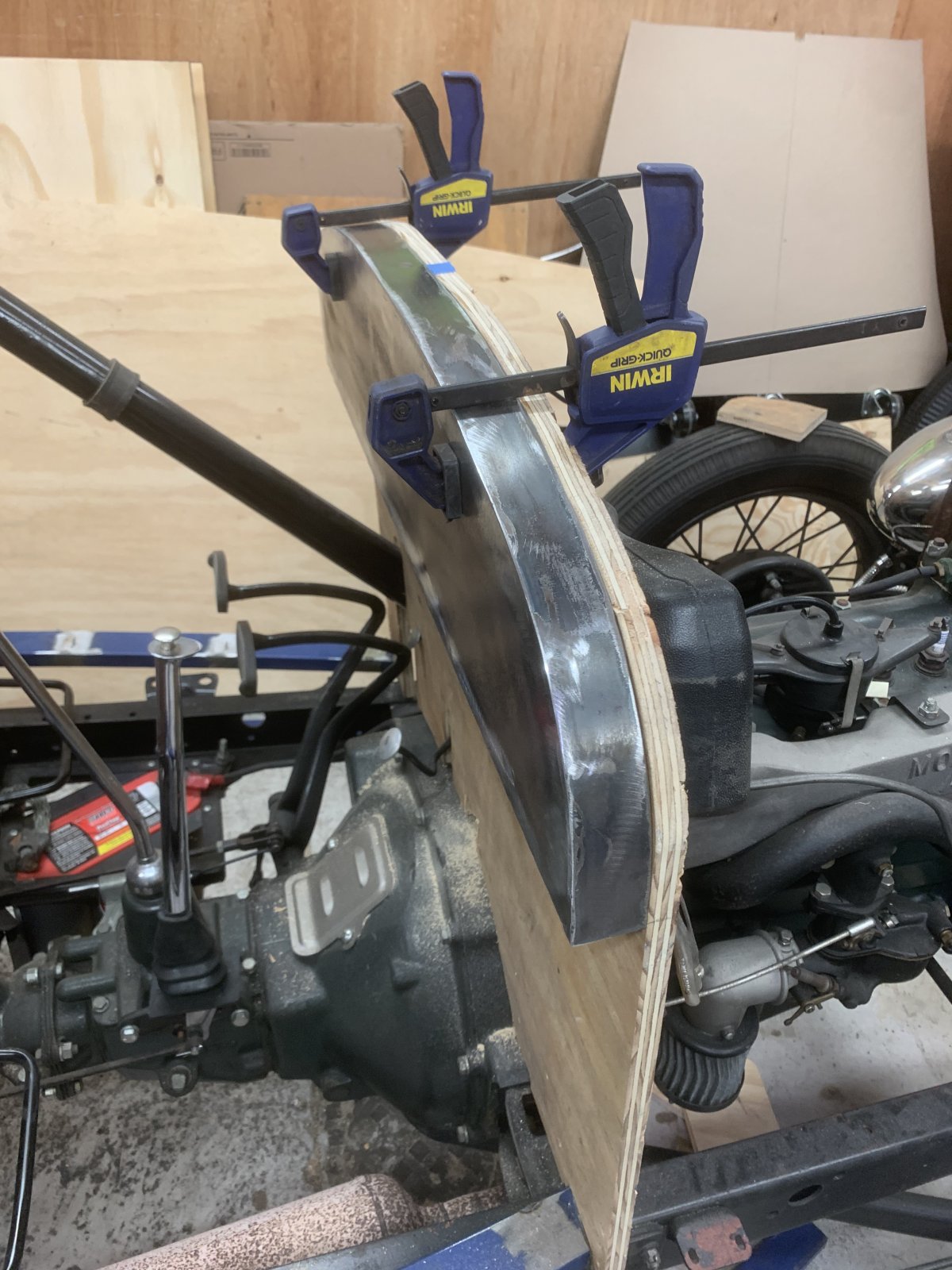

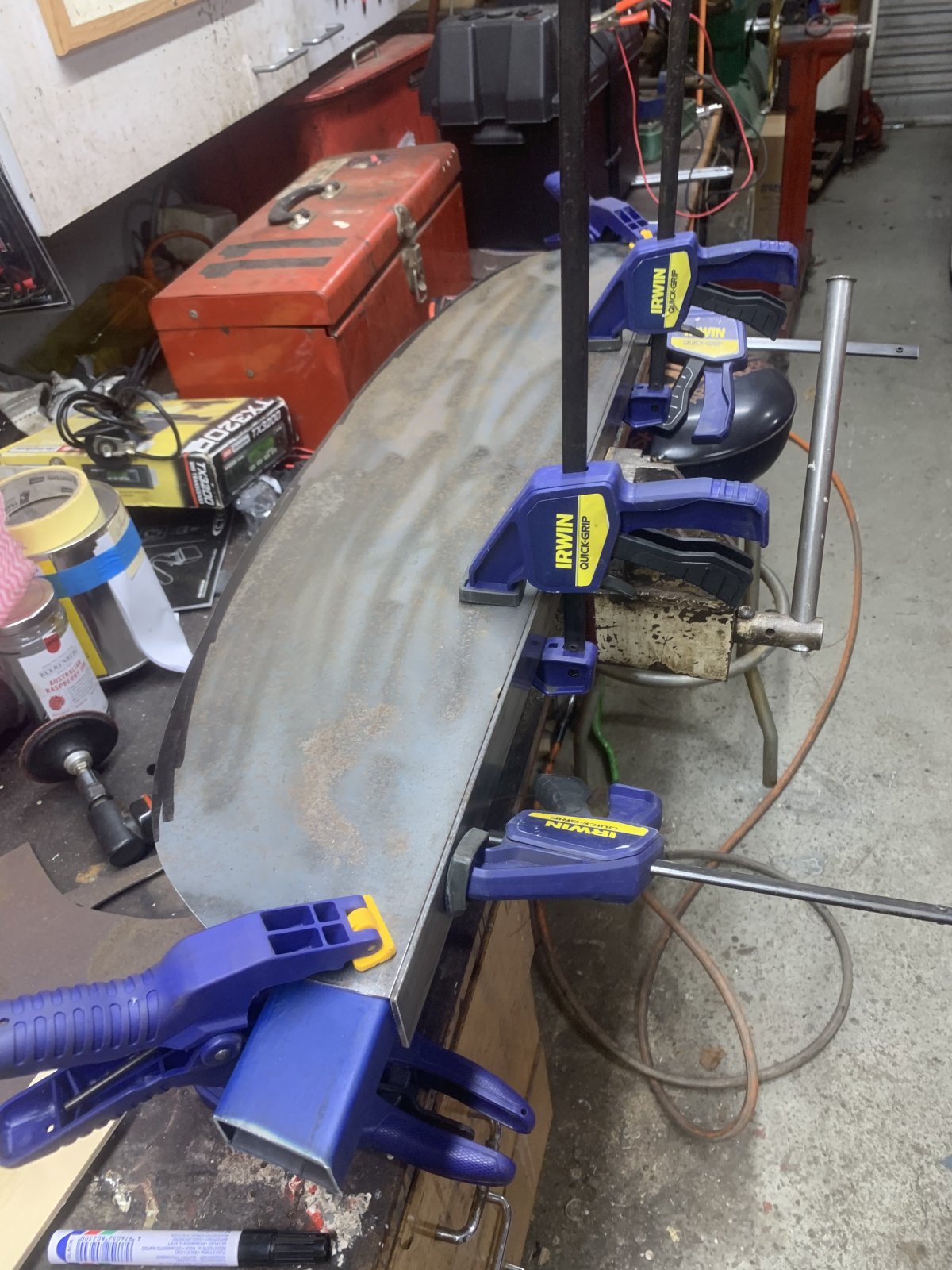

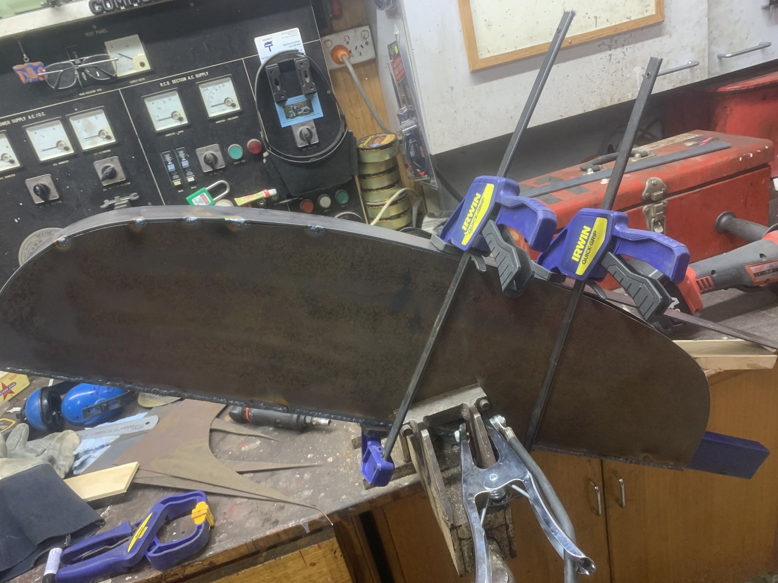

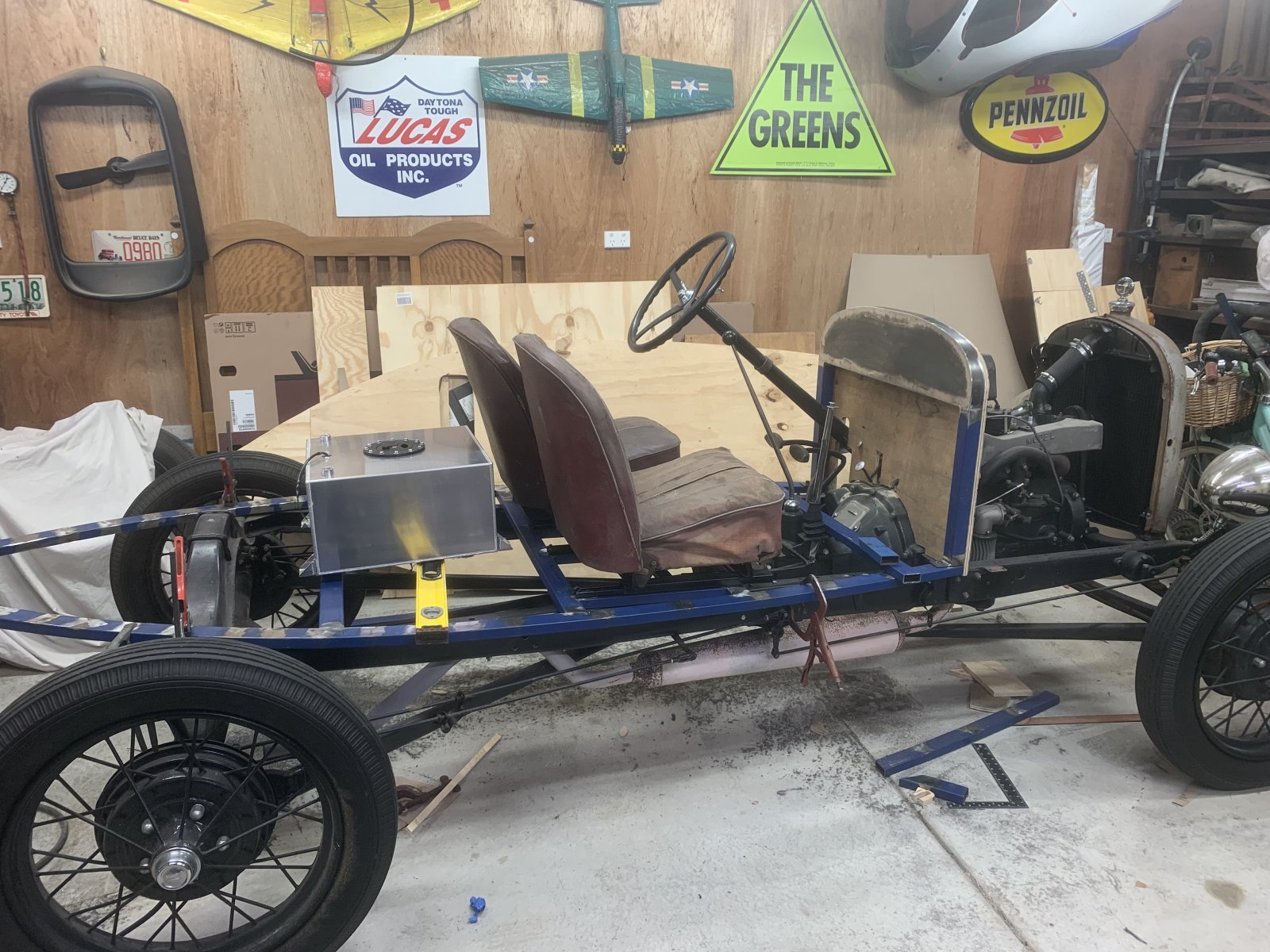

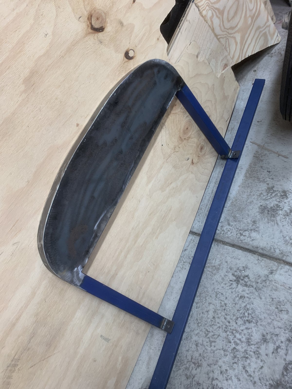

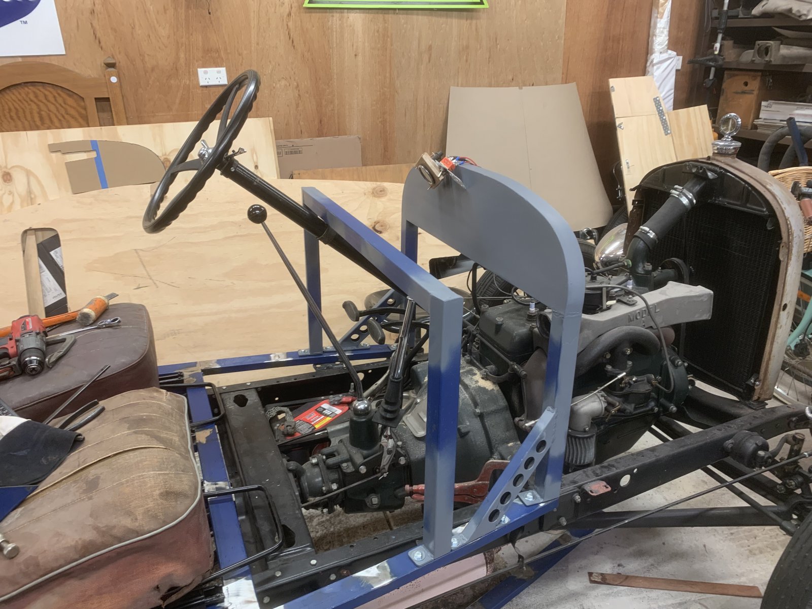

    EB27E342-00F1-4AD9-B791-B5BBE0C8DA60.jpeg C65A139A-4877-4683-8D3F-763EEF219795.jpeg 30CB0DD5-37BC-4521-B52F-613F8E1B2B6B.jpeg CBCFAE79-04A9-43D8-9E68-7CC509165CFE.jpeg 3CB1EDCD-2A19-455C-824C-DD350DBBF527.jpeg 30CB0DD5-37BC-4521-B52F-613F8E1B2B6B.jpeg CBCFAE79-04A9-43D8-9E68-7CC509165CFE.jpeg 78CFF6B2-EAEB-4C62-ABB7-66DB07F72C75.jpeg E3DE0C1F-F90D-4FAF-8EA0-238B3FA18B62.jpeg A bit more progress
    Made up a fire wall frame, I was going to try bending the square tube, but made up a box instead, much easier, fuel tank turned up as well, hopefully 40 litres will be enough!
    Squablow, Stogy, Kume and 6 others like this.

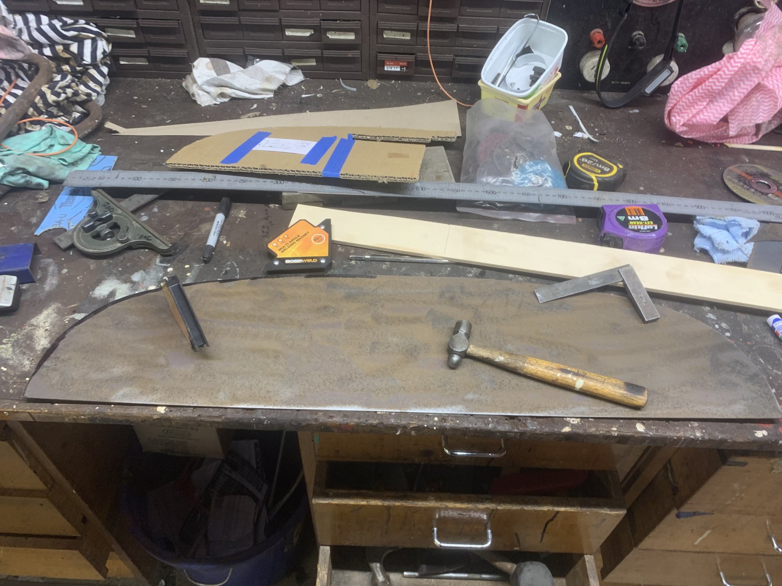

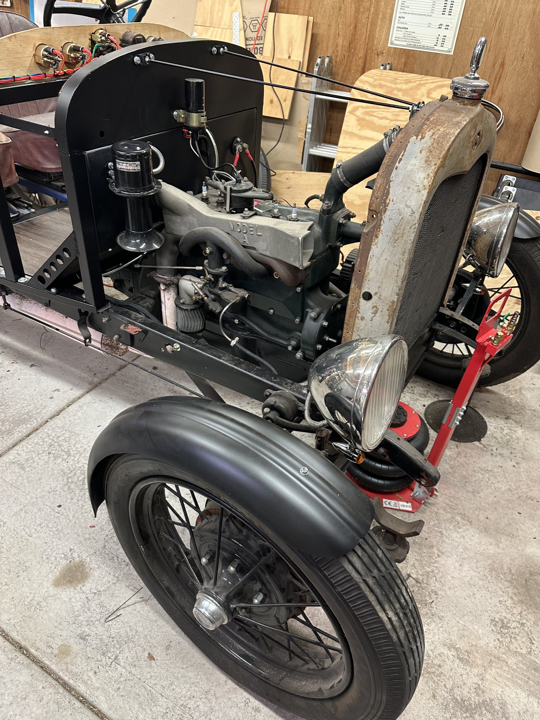

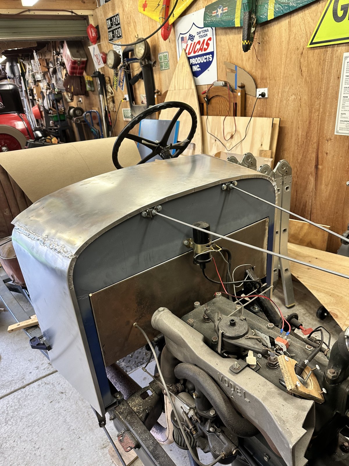

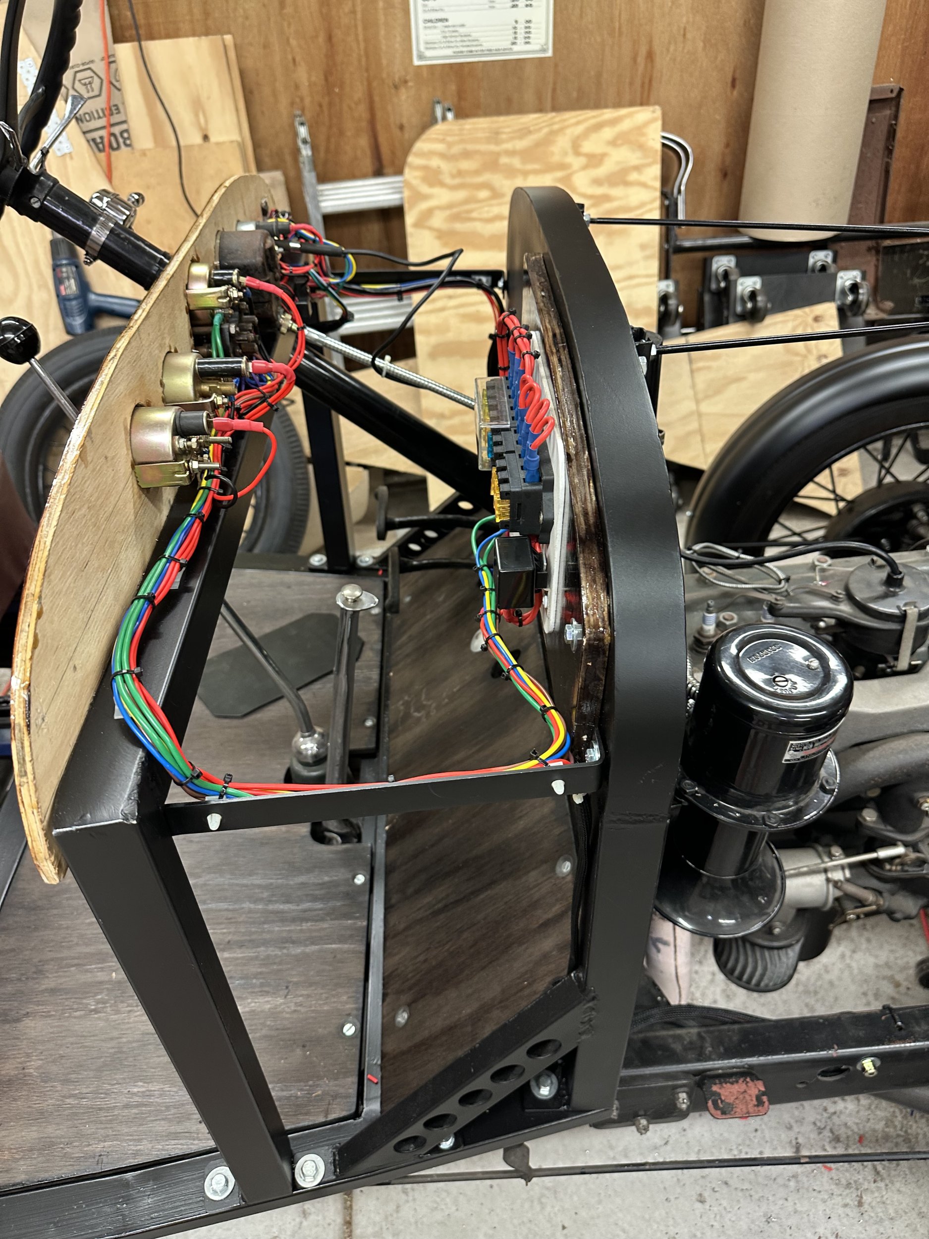

    A bit more progress 48C0CED4-E74B-4854-8F35-A5290CA7FB7F.jpeg 2DD9D43B-2BA9-49F4-9EB2-BCEBF87D660B.jpeg 8539352E-F384-4E3D-9548-1E92D062F60F.jpeg 2C91F9A8-3658-4715-A4B7-429B2E6B085A.jpeg

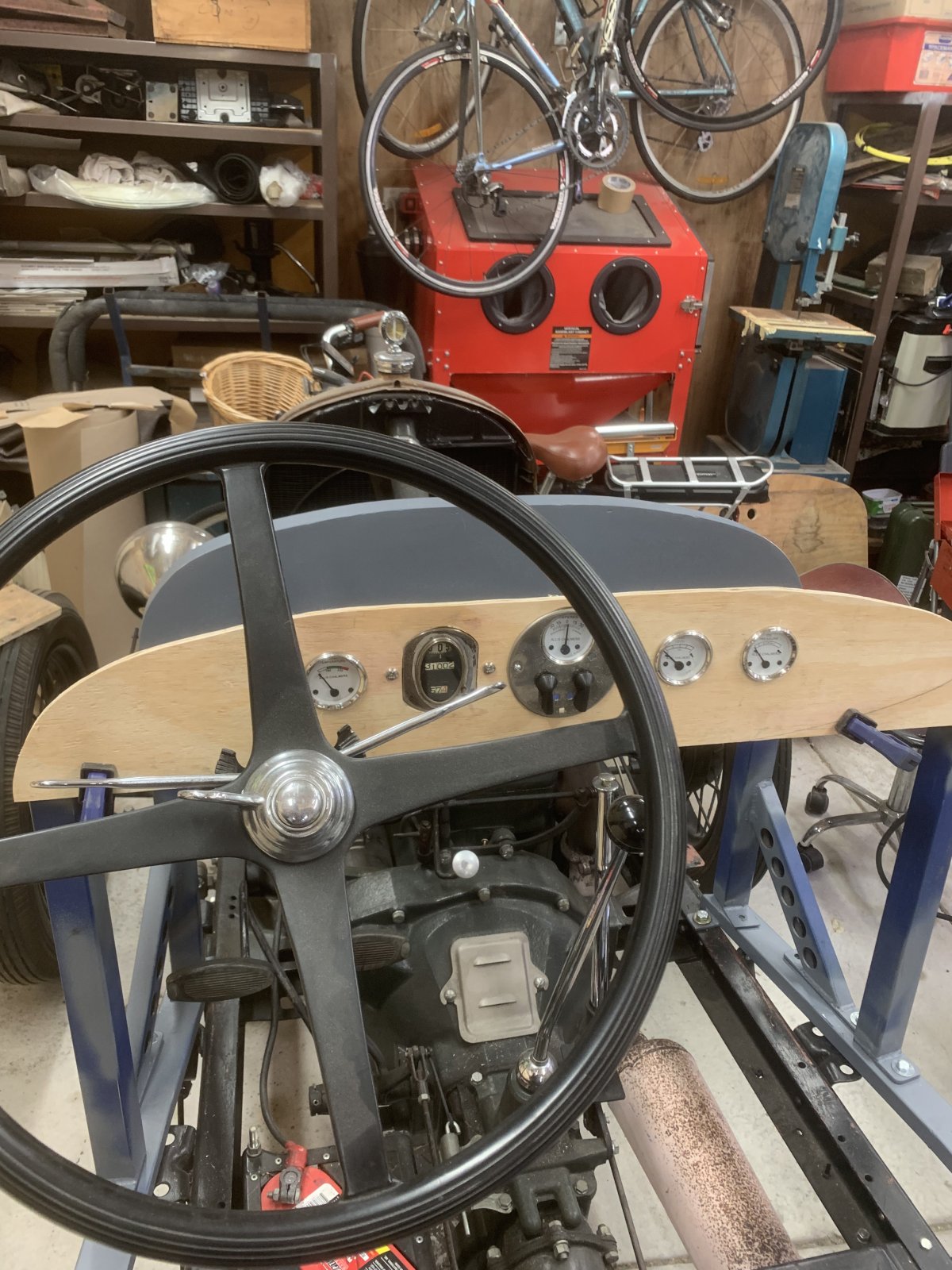

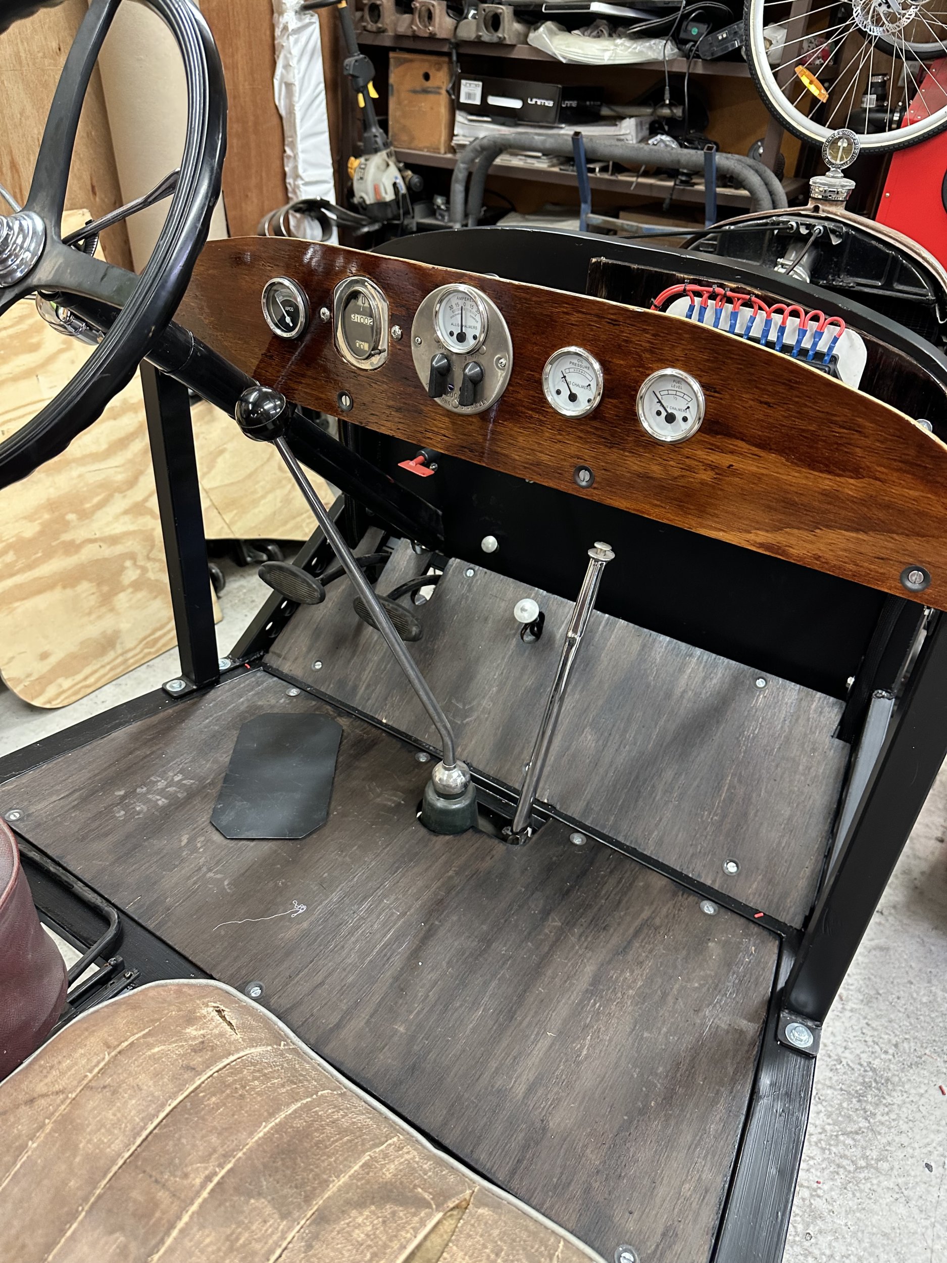

    not much progress just mocking up the dash

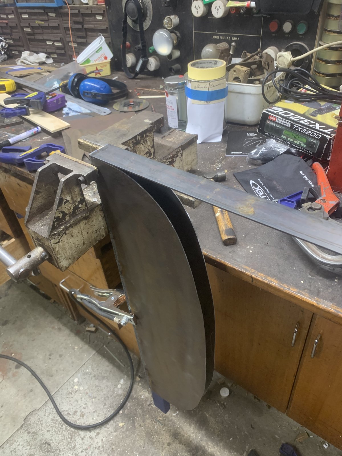

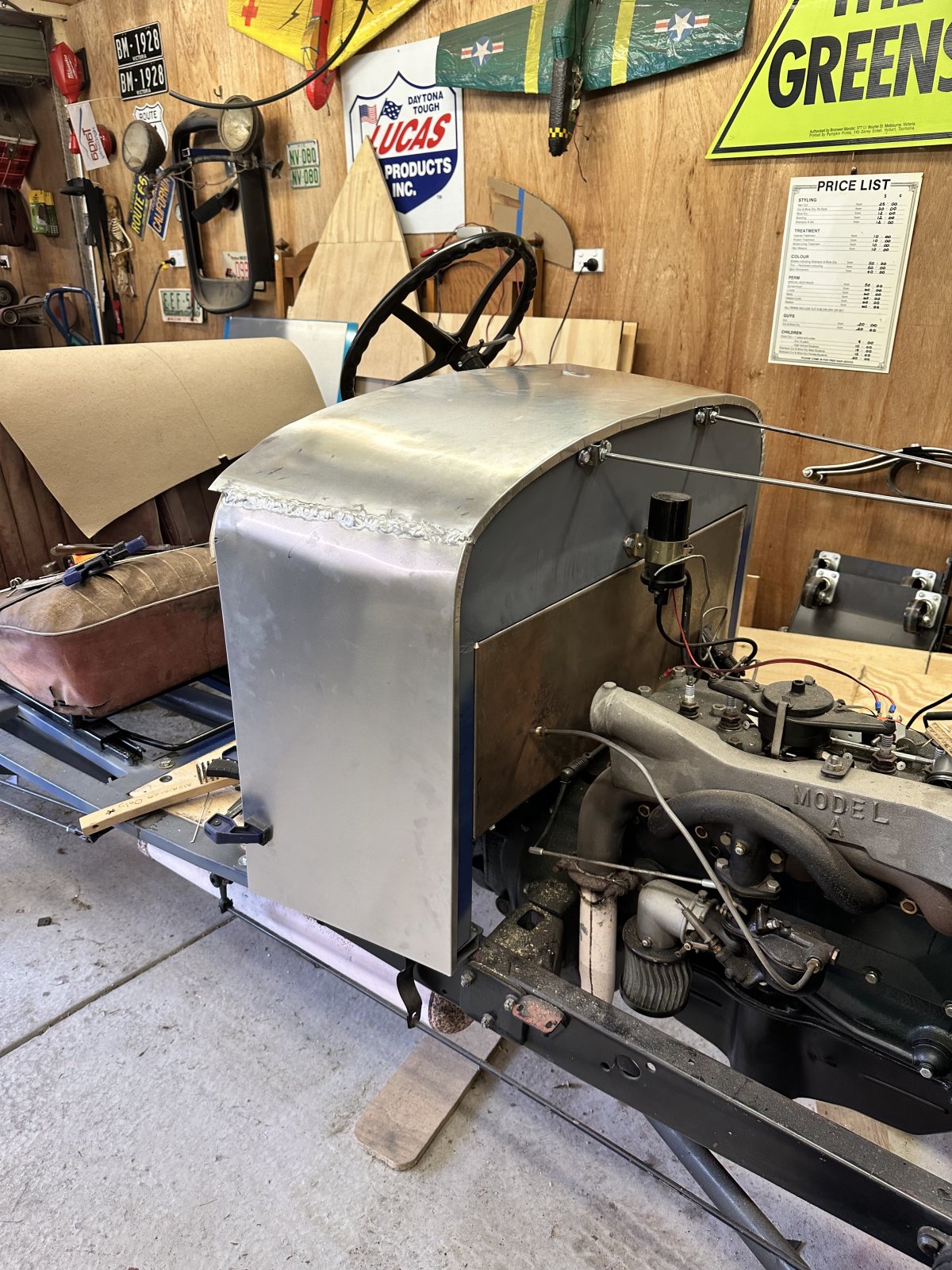

    Jeff34, brEad, loudbang and 3 others like this.

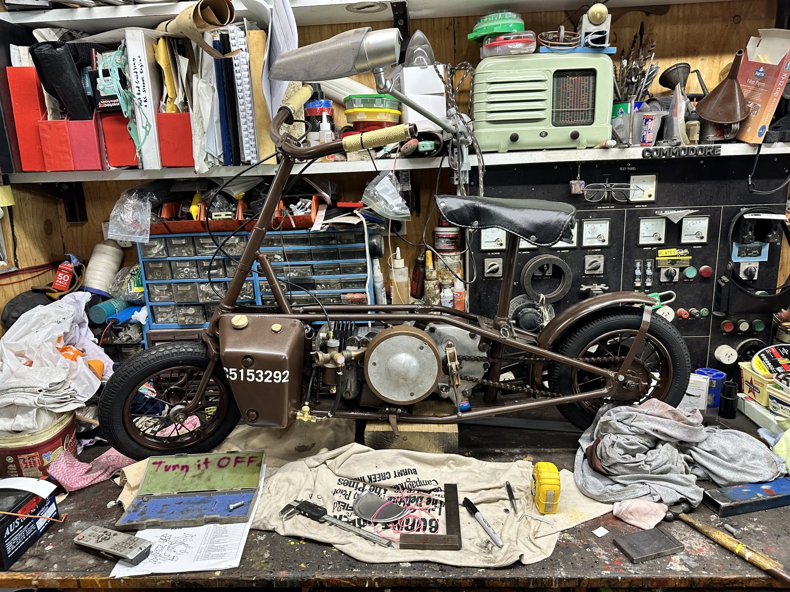

    So is this backup for the rare occasions when the banger won't run? Like the little rowboats pulled behind bigger sailboats?
  19. Brendan1959
    Joined: Jun 26, 2008
    Posts: 336
    Brendan1959
    Its a 1942 English paratrooper welbike quite rare, and apparently valuable.

    Not sure my skills are up to aluminium, 2 but welds many hours and 1/2 a bottle of gas.
    I may be better using sheet steel.
  22. stubbsrodandcustom
    Joined: Dec 28, 2010
    Posts: 2,566
    stubbsrodandcustom
    from Spring tx
    Almost thinking you need to invest in a spool gun for your mig welder and run co2 shielding gas. I think that would fix your welding issue... You got alot of puddle there that you were chasing for sure.
