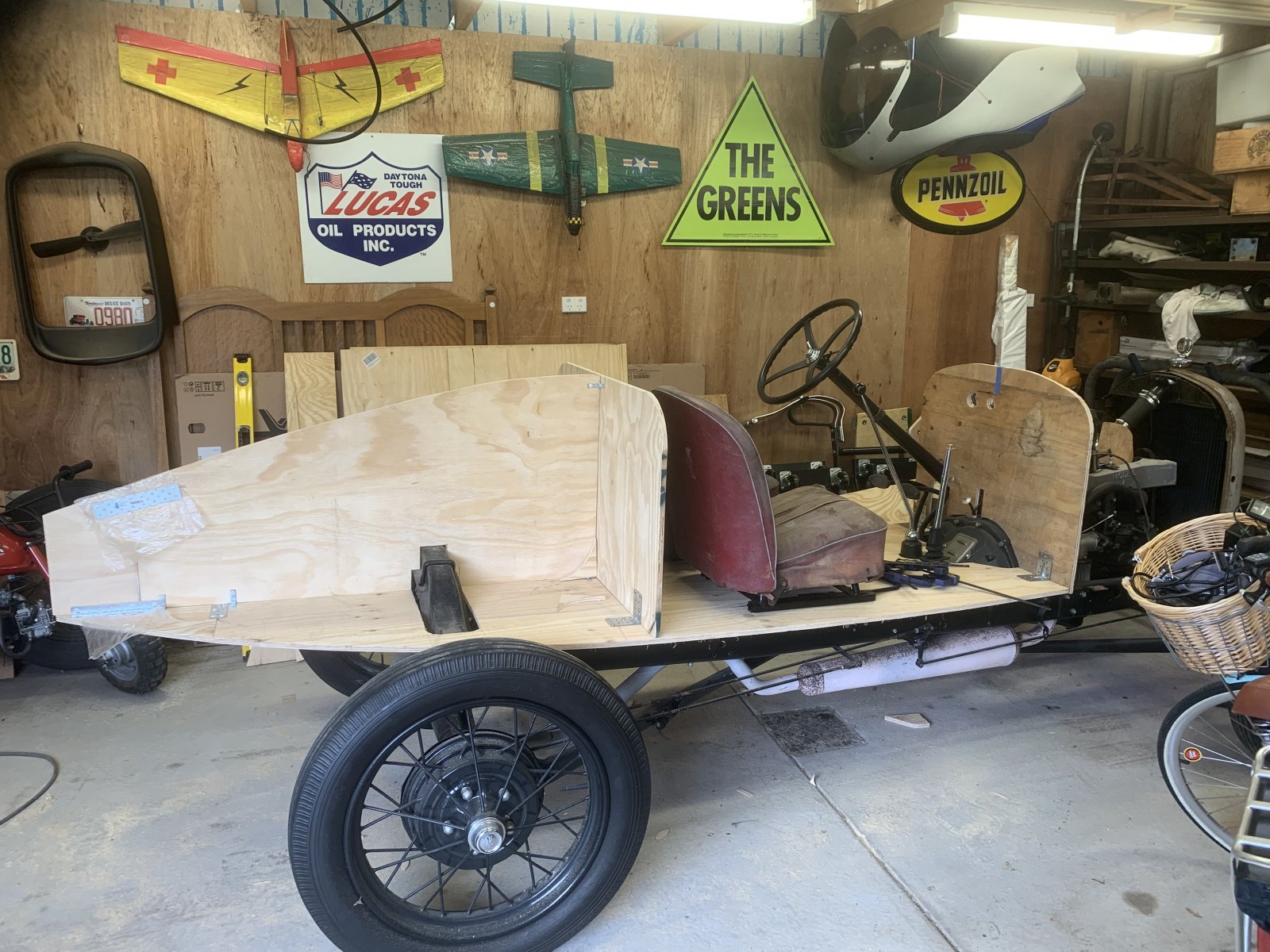

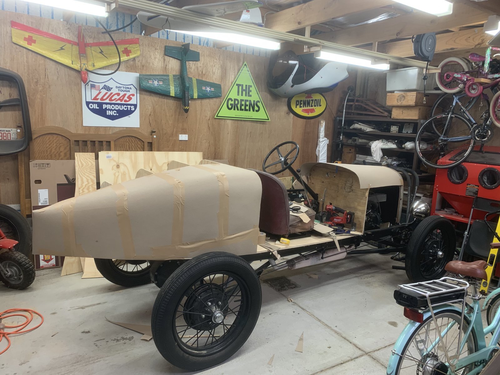

    Is the tail to long?
    Stogy, 1biggeorge, ClarkH and 2 others like this.
  2. Outback
    Joined: Mar 4, 2005
    Posts: 3,222
    Outback
    from NE Vic
    Looks ok to me, but you really need yo get the whole profile to really know. They need to flow front to back.
    Stogy and ClarkH like this.

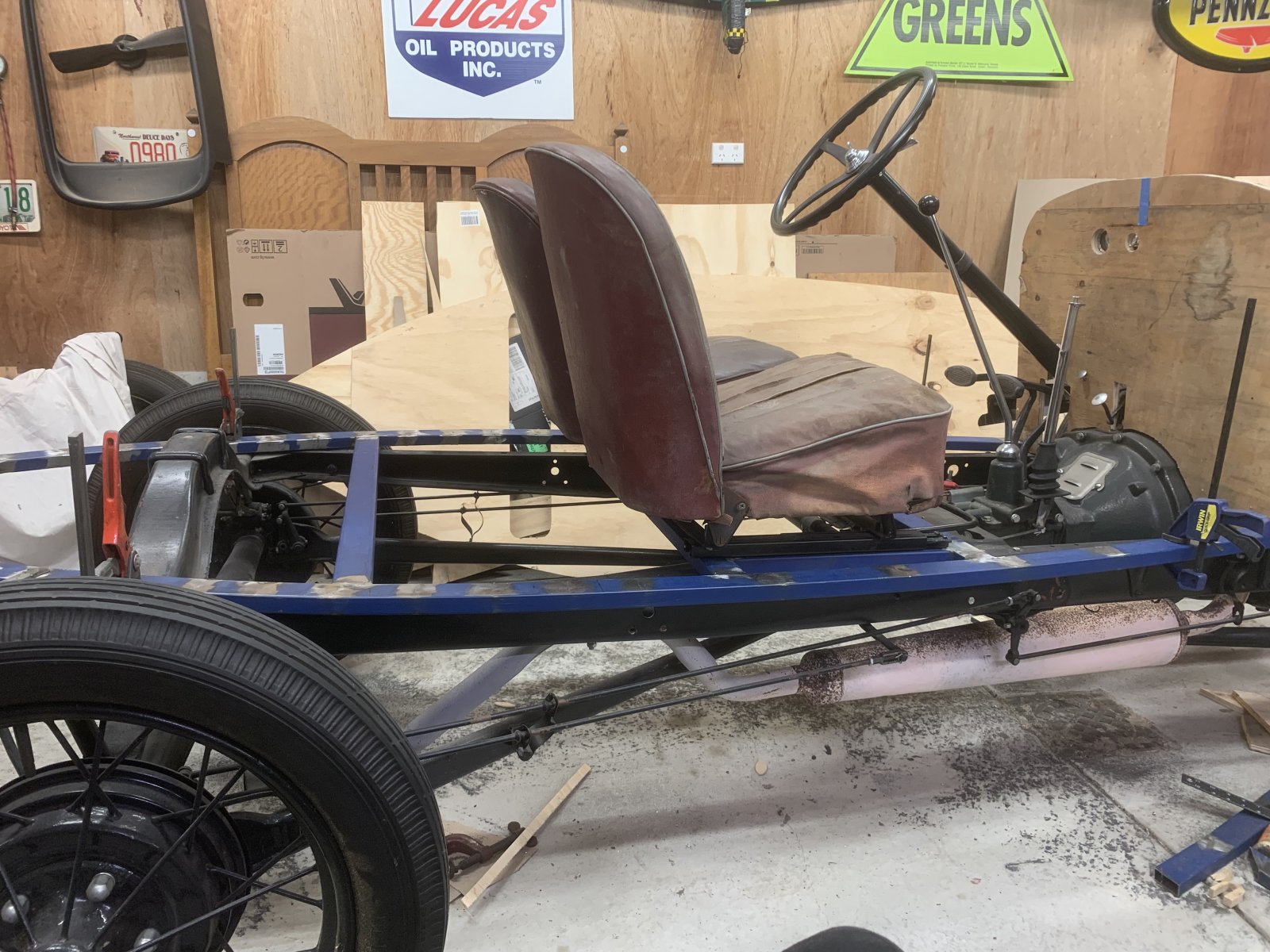

  4. Jeff34
    Joined: Jun 2, 2015
    Posts: 1,196
    Jeff34
    Now create the shell with blue painters tape to get a good vision of the shape of the tail. You may find that you want to increase the radius on the upper corners as you move forward toward the cockpit, or that you want to change the shape in another way.
    Great progress!
    Stogy and brEad like this.
  5. Brendan1959
    Joined: Jun 26, 2008
    Posts: 336
    Brendan1959

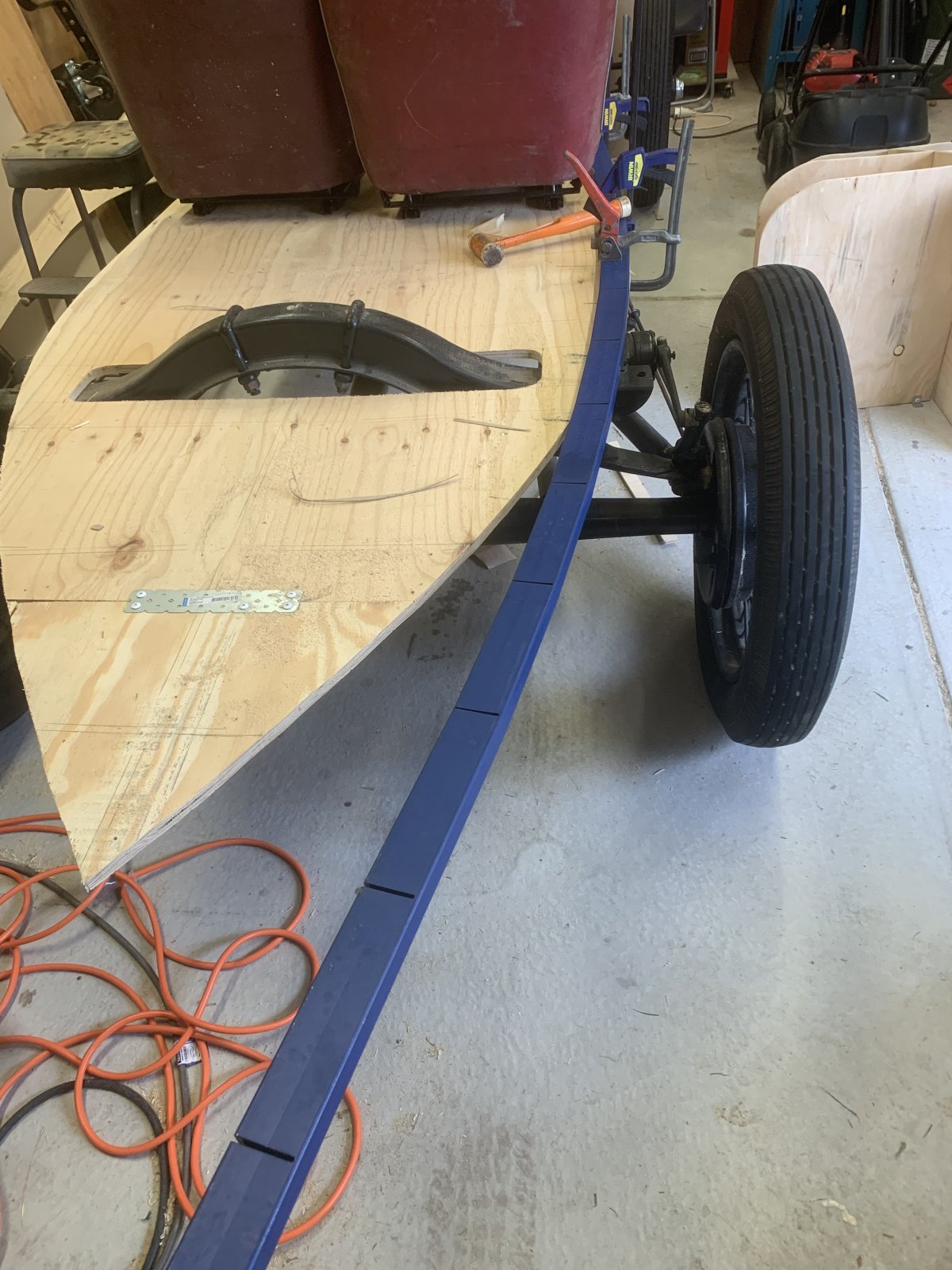

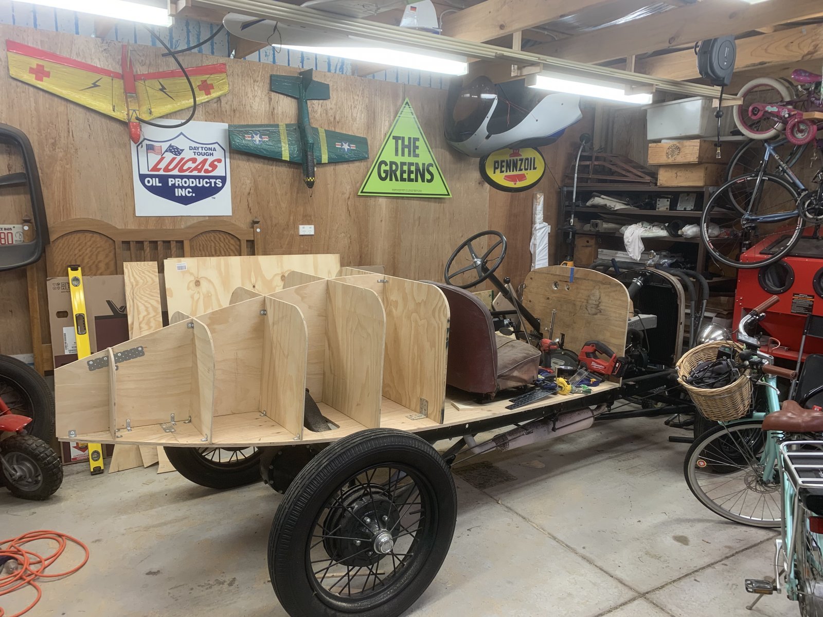

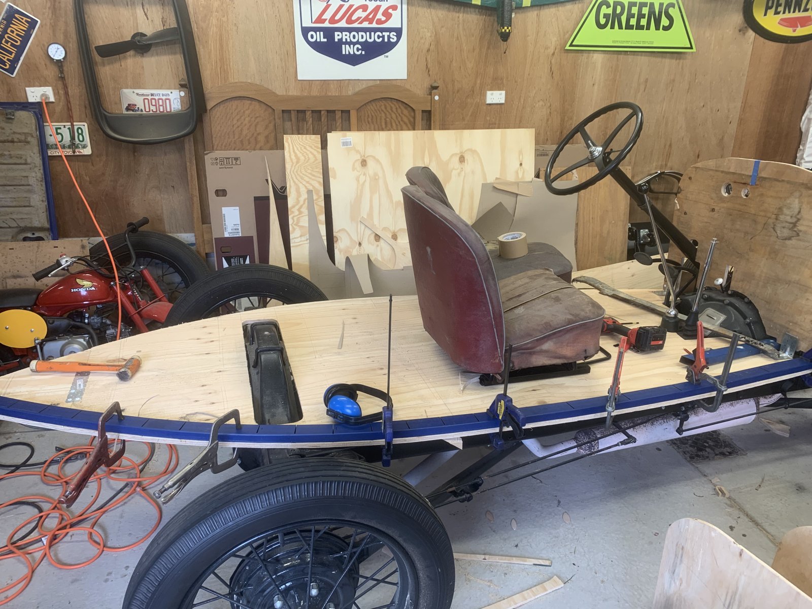

    Yes jeff I think you are right, 8B733A40-B764-4D0D-A63E-42EED2554B34.jpeg 2AE59DDA-2948-48B7-850A-086FA036FB89.jpeg it is a little square near the seats, I have made a start on the mock up.

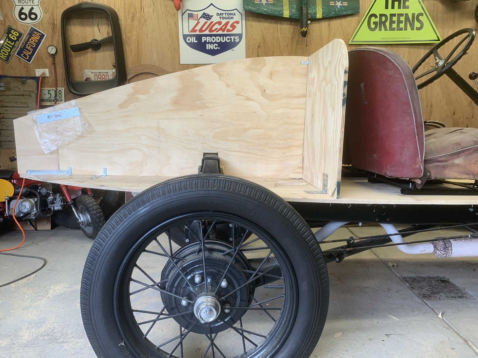

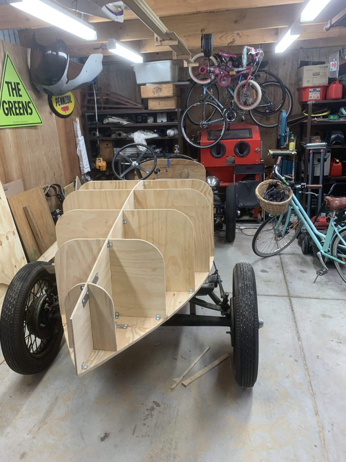

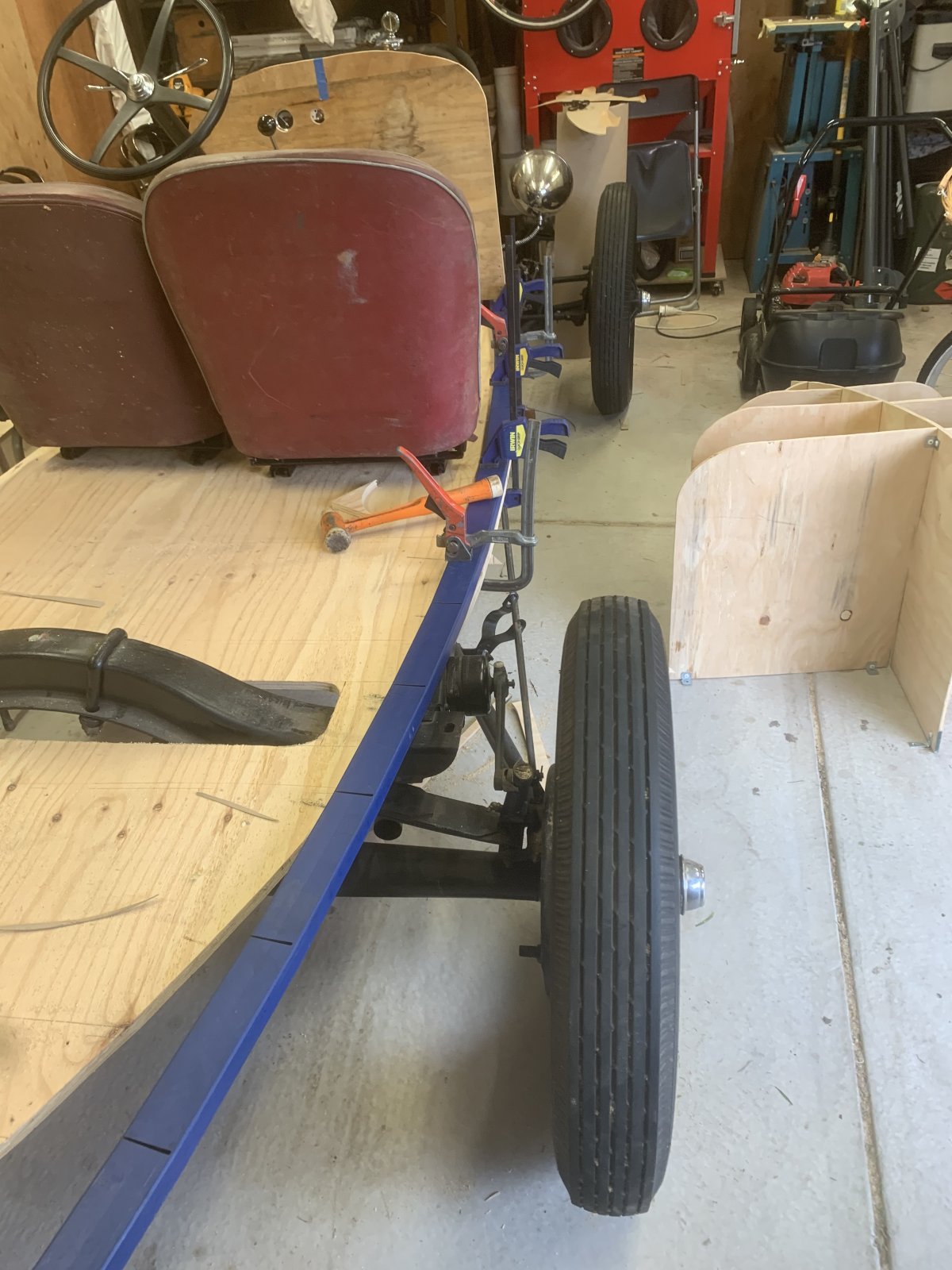

    What do you think of the lines/shape? I think its close. photo_2022-05-25_13-51-52.jpg photo_2022-05-25_13-51-57.jpg photo_2022-05-25_13-52-07.jpg
  8. Daniel Dudley
    Joined: Feb 20, 2022
    Posts: 42
    Daniel Dudley
    I wonder how it would look if it dropped 1/2 or 3/4" at the first former behind the seat to fair out the line.
  9. flatheadgary
    Joined: Jul 17, 2007
    Posts: 1,045
    flatheadgary
    from boron,ca
    it looks perfect! if it were mine, a little half circle as a door to get in. otherwise it is great. after all it's your vision not mine. i have several models of the 35c so i do like them. i have an old kit car book with several of the kits they used to make.
    Stogy likes this.

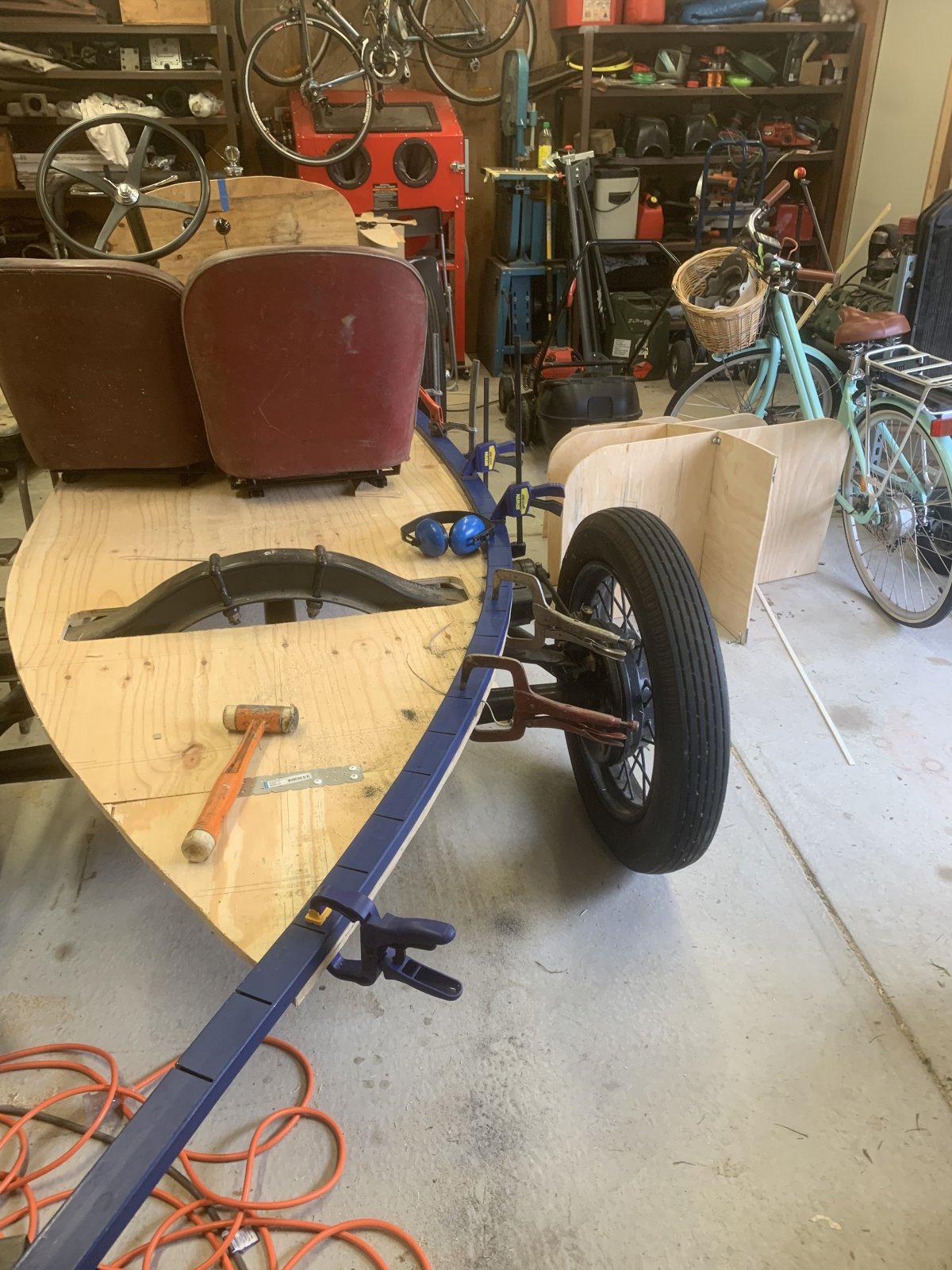

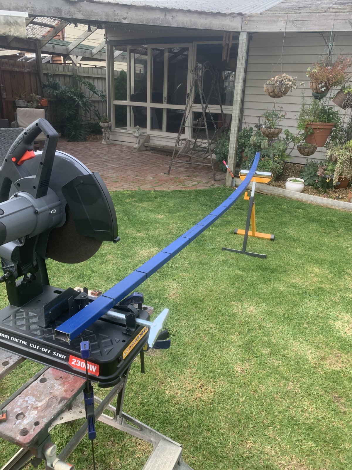

    Back home for a week or so from our country place, managed to get my A roadster going for a run around the hills while there, it was back firing and the wolf whistle was pulsing. Stuck exhaust valve, managed to pop it down from the spark plug hole. Now the wolf whistle sounds normal, who would of thought that they could be used to diagnose problems.

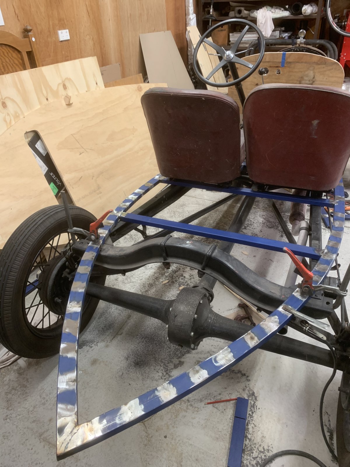

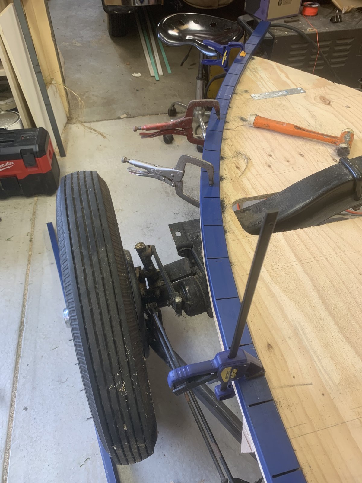

    Back on the speedster, I got some steel tube delivered, I thought I might be able to bend the 50 x 25mm rhs with a plank and rope, no luck, so I went with the multi cuts on the inside. 10 at 200mm apart and 20 at 100mm apart at the tail end. Looks better than I thought it would. 60A52600-A55C-4A1A-9080-D85D8D6C6A5B.jpeg 5825BCCD-E69E-4C10-9B7A-E19D001BE87C.jpeg 3AD1EFE8-EB38-42A0-B4E6-9FCB374732BB.jpeg F5F3311F-D293-4C91-9FBF-2BF3084DBBEC.jpeg
  18. v8flat44
    Joined: Nov 13, 2017
    Posts: 1,211
    v8flat44
    Well, I sure like it ..... bang on
    Stogy likes this.
  19. Looks good. Nice even arc without obvious flats!

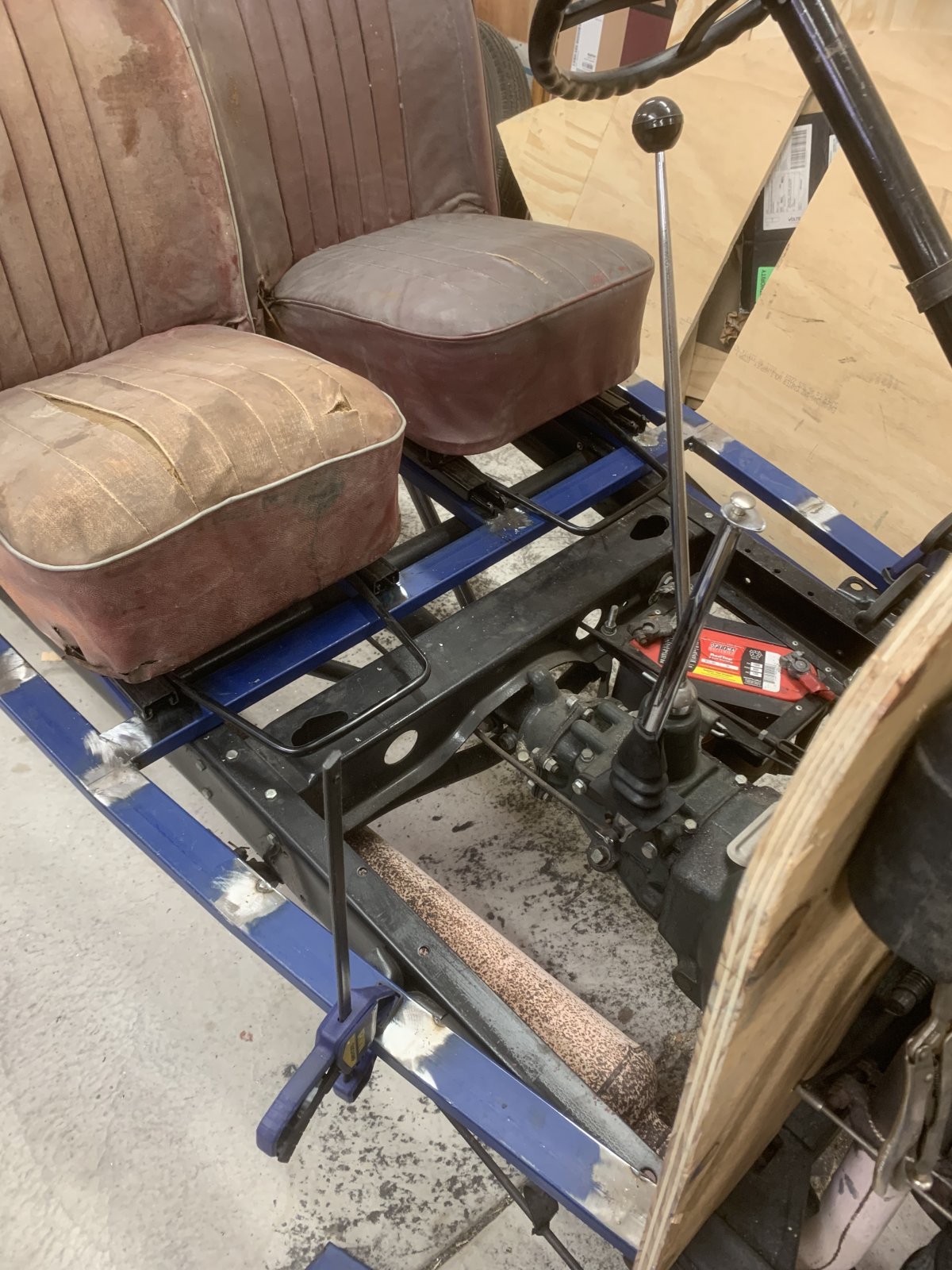

    Sun frame some what done, seats and sliders bolted in.
