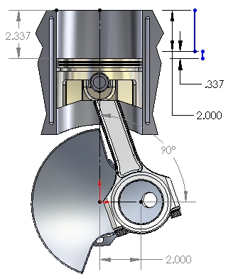

  10. Blues4U
    Joined: Oct 1, 2015
    Posts: 8,058
    Blues4U
    from So Cal
    And the length of the connection rod has an impact on this. The shorter the rod, the more dramatic this effect.
