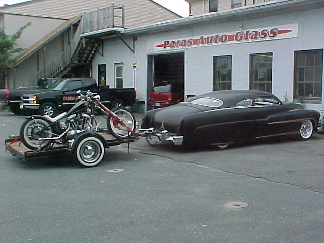

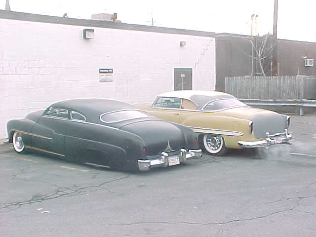

    has anyone here bagged a merc or shoebox?ive biult a few cars now but never did bags..i guess my question is will the car stop bottoming out at ride hight, i will not drive the car higher than it is right now!!! i want low all the time not just wen its parked (am i making sense?) this is how the car sits now and i wanna keep it that way

    If the car is at the ride height you want it at (which looks great), I don't think adding bags will keep it from bottoming out - they will just give you the adjustability to raise the car when you need to, and I think you said you don't want to do that. It sounds like you have some chassis work to do instead.
    What has been done to the frame/floors to accomodate for the current stance?

    Killer stance on your Merc, I wouldn't raise it up either.
    I'm using those RV type bags (red color ones) that sit inside my front coils.
    I had the same problem, kinda, I've got dropped spindles. No part of the front suspension bottoms out on the frame, but the whole car used to come down and bottom out on the ground. The RV type bags make the front springs stronger. Trouble is, if you pump up the bags all the way, the car rides like the springs have been replaced with a 4 x 4" piece of lumber.
