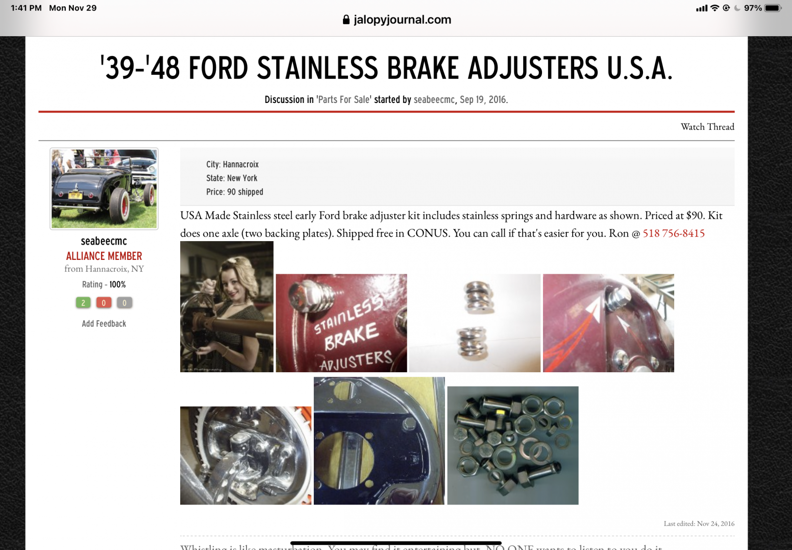

  5. ssffnomad
    Joined: Jul 23, 2008
    Posts: 960
    ssffnomad
    Does this help you ? 676DAC09-E330-49C5-8051-CF1CE59613D2.png ,
    seabeecmc likes this.
  6. alchemy
    Joined: Sep 27, 2002
    Posts: 22,336
    alchemy
    Oh, I thought he was missing the inside cam. Those stainless bolt kits still require the original inside cams.
  7. brading
    Joined: Sep 9, 2019
    Posts: 814
    brading
    I think he is missing the cam. When I looked at that kit I thought it was strange they do not show the cam. The similar kits they do over here come with a cam but are not stainless steel.

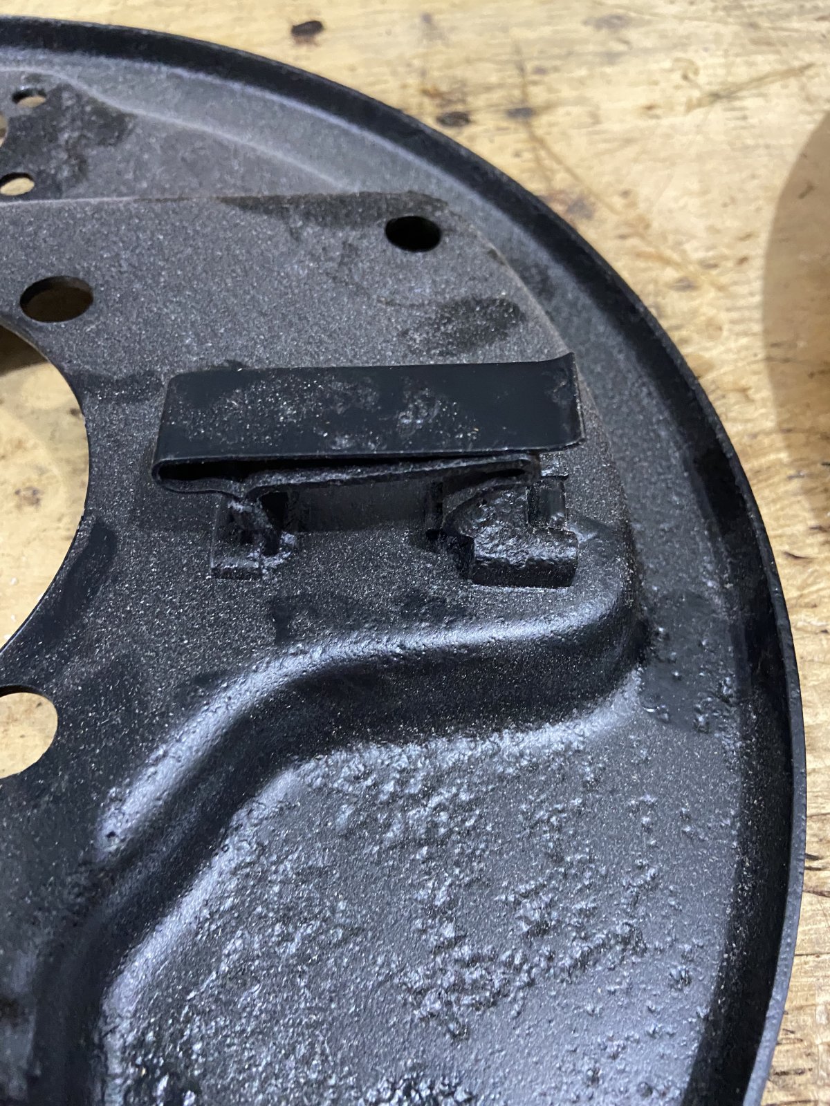

  9. novaskilling
    Joined: Jul 8, 2018
    Posts: 169
    novaskilling
    A friend gave me a backing plate however the shoe clips are missing, I thought about using mine but you can see the mounts are different for the clips
  10. Corn Fed
    Joined: May 16, 2002
    Posts: 3,411
    Corn Fed
    Your top left pic is a 46-48 plate....it uses a clip that slides in. The bottom right pic is a 39-40...the clip is part of the plate. The top right pic is someone's homemade attempt at a replacement clip.
  11. novaskilling
    Joined: Jul 8, 2018
    Posts: 169
    novaskilling
    thanks for the info, which plate is 46/48 the black one or rusty one? The black ones were on my 40 banjo.
  12. alchemy
    Posts: 22,336
    alchemy
    I think the long clip might be for the parking brake arm. Is it the opposite side of the cable tube?
  13. novaskilling
    Joined: Jul 8, 2018
    Posts: 169
    novaskilling
    Yes it is.
  14. alchemy
    Posts: 22,336
    alchemy
    That black plate is a 40 style.
