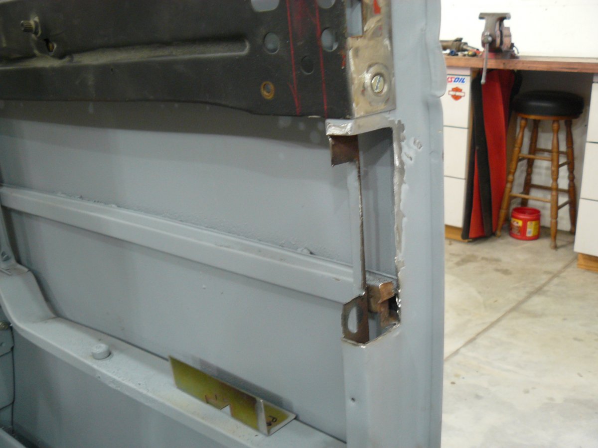

    after a lot of time and swear words I finally got the doors lined up, it was time to get the bear claw latches installed. I'm wanting to drive it, figured I should have doors that stay closed. I've been thinkin about how to do this for a couple months.I am very pleased how they turned out. I will let the pics tell how I did it.

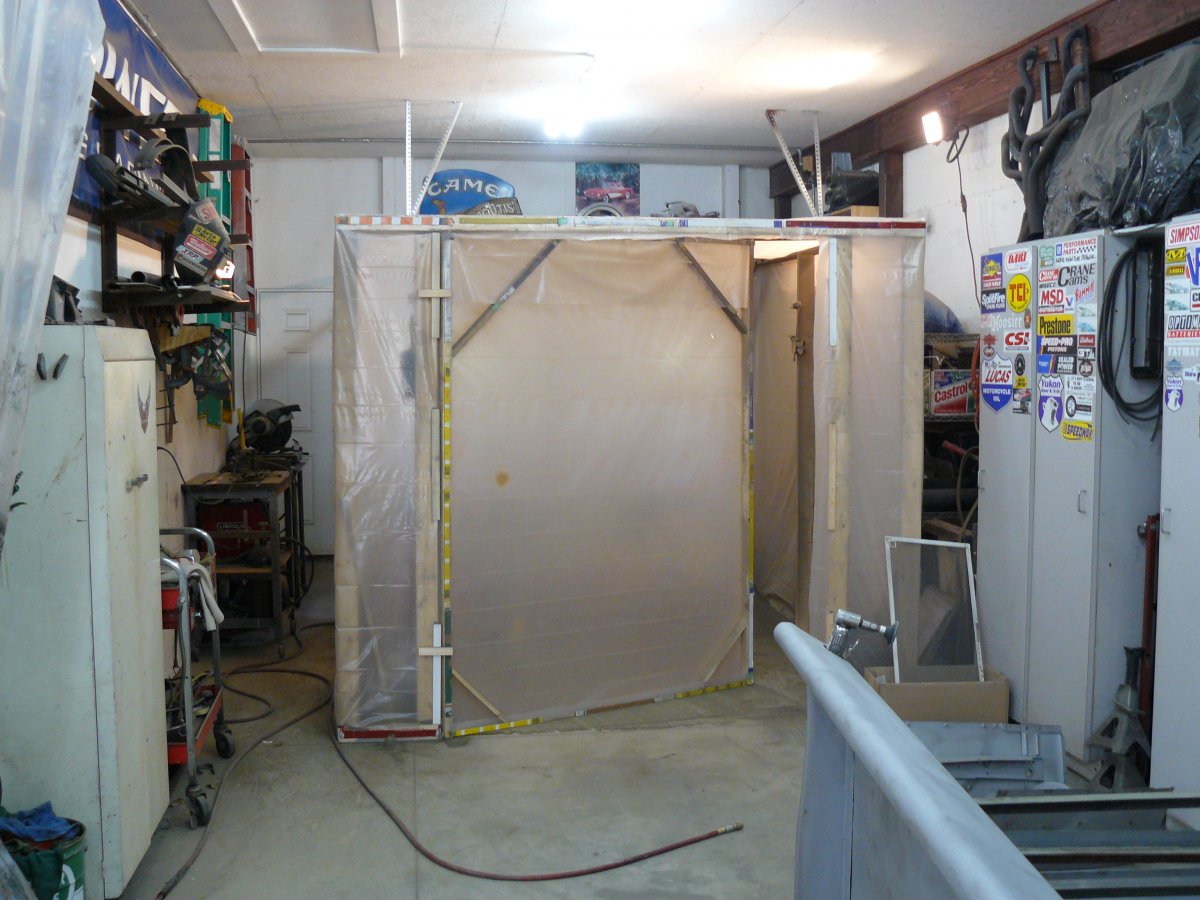

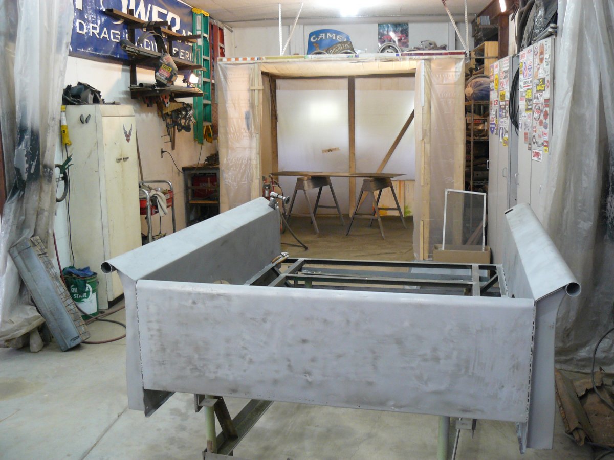

    time for an up date. spent the last month blasting all of the sheet metal . it was going to cost $1000 to get every thing stripped .so I bought a HF blaster and 12 bags of blasting media from menards . and built a temp. blasting booth in my shop. worked great. now time for some body work and paint. I have decided to paint it Hugger Orange.
