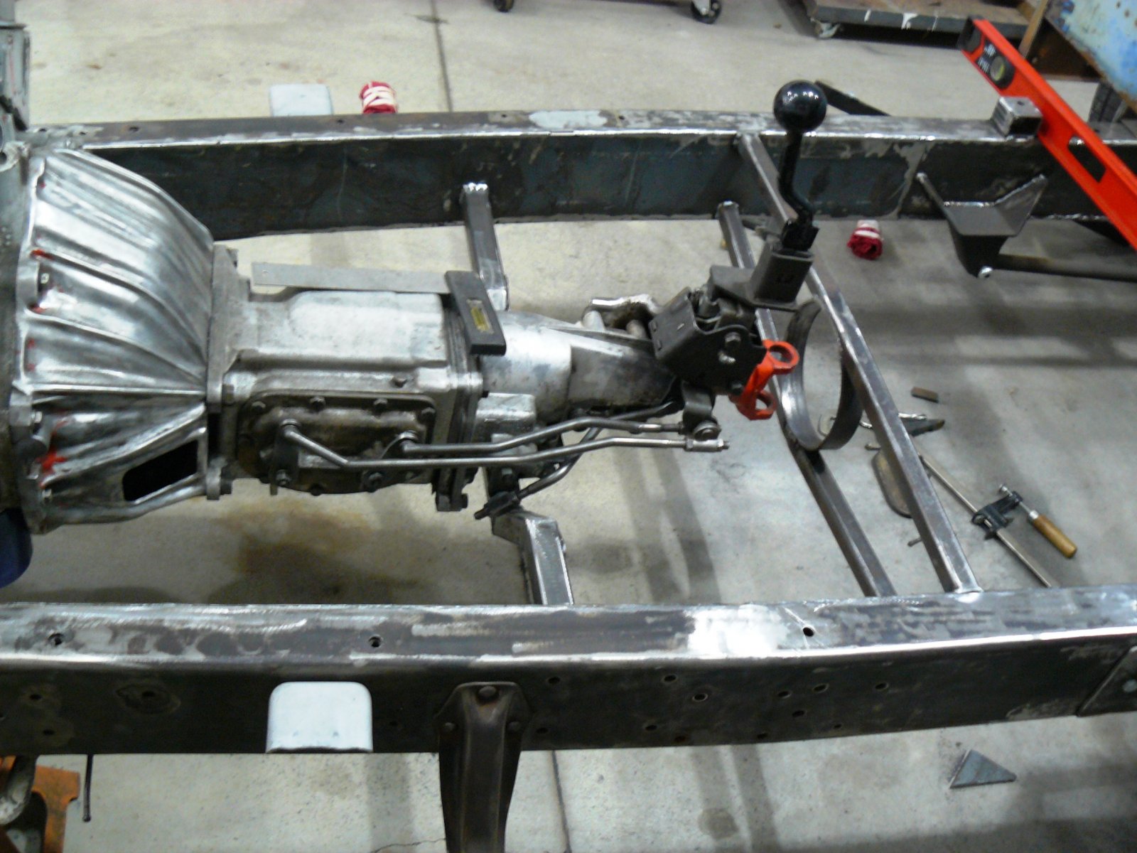

  24. harley rider
    Joined: Aug 11, 2010
    Posts: 527
    harley rider
    I scored a borg warner super t10 that I will be using.I stole this trans from flywheel to shifter for $100.
