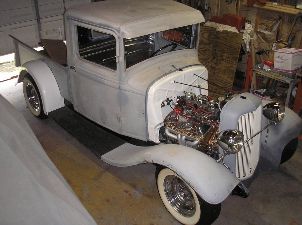

  3. I used a 46" 4 inch dropped Super Bell under my 34.
    I wanted to run disc brakes on the front and the stock axle would have my tires hitting the fender lips. My crossmember is aftermarket with a 1" built in drop.
    I have chrome smoothies and bias ply tires on the front and it fits just right to me, the tires are right in the deepest curve of the fenders. I can turn the wheels lock to lock without interference.
    After reading about the breakage problems associated with the Super Bell cast axle, I would reconsider buying it again though. But the 46" width works for me.

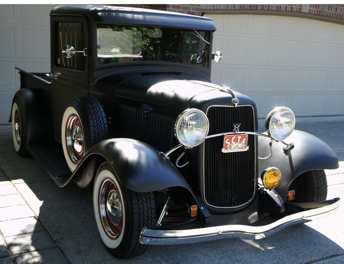

    Flip, I'm using the 46" Super Bell, 4" drop, and disk brakes (the full kit out of the Speedway catalog)

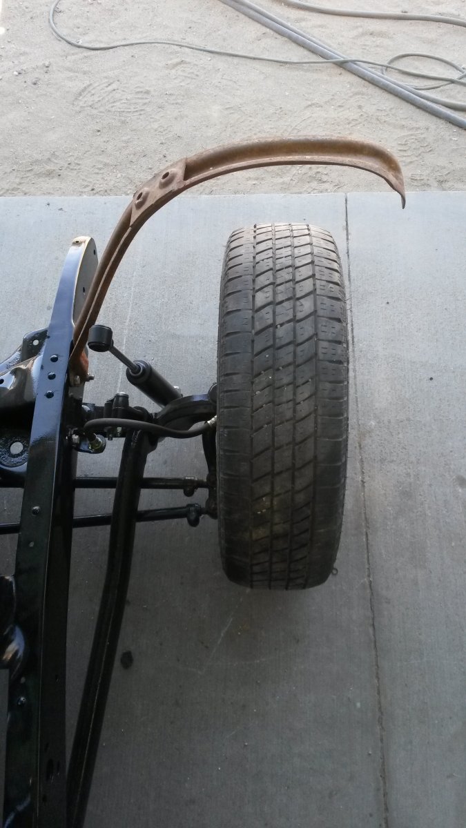

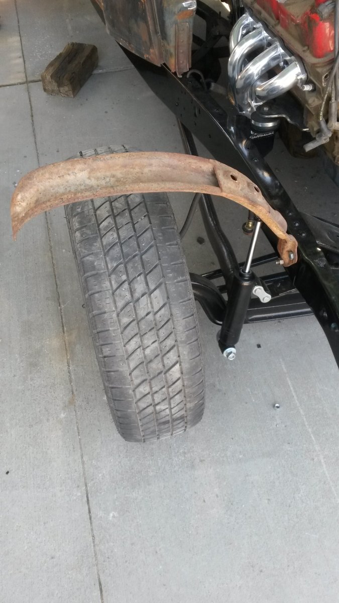

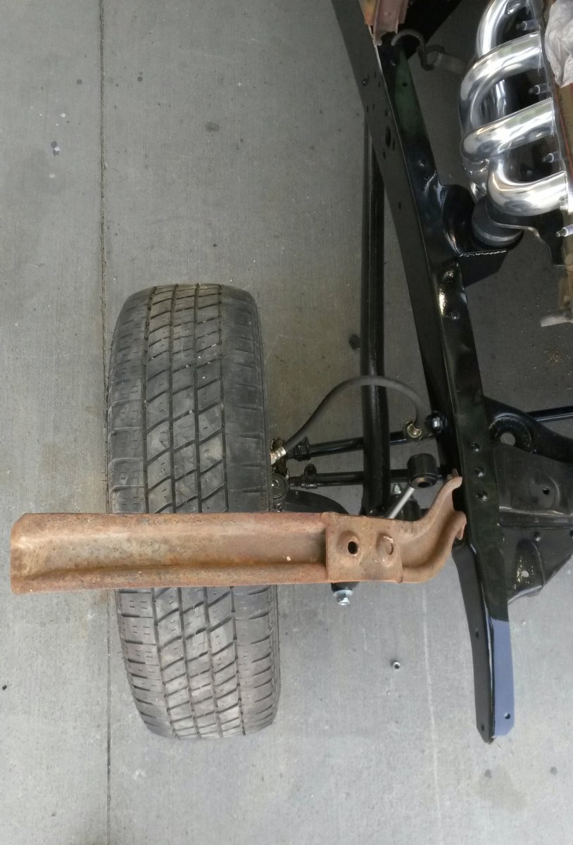

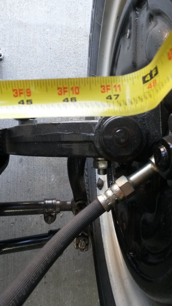

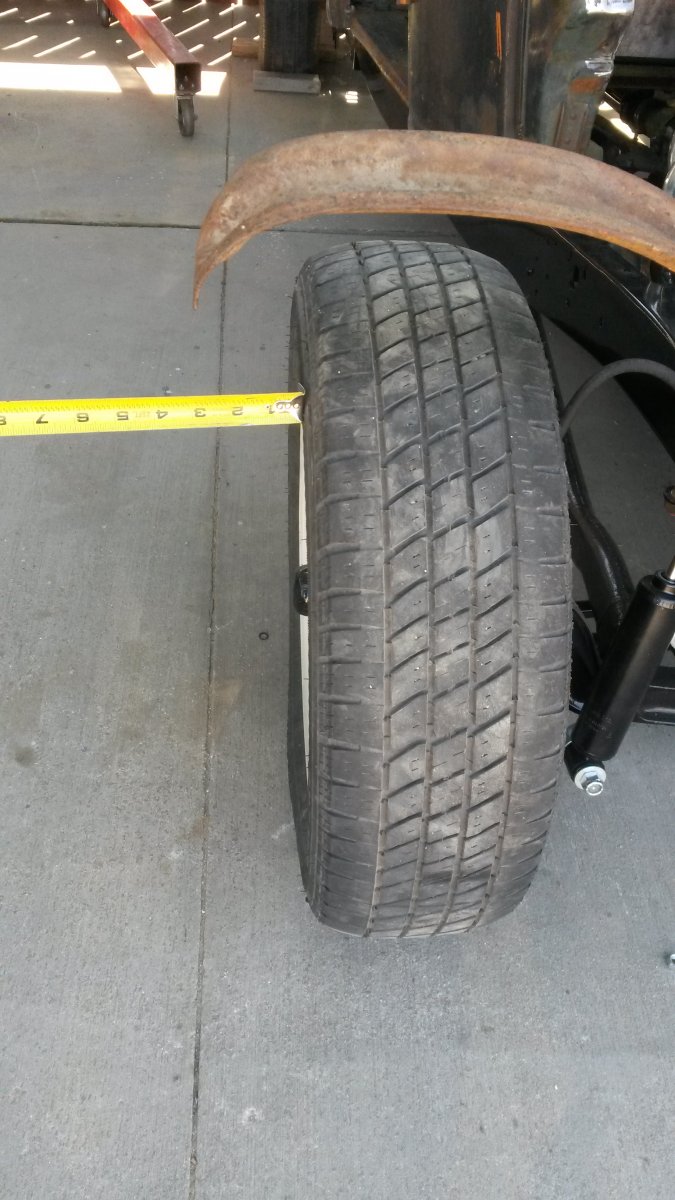

    Hey Flip,
    I'm gonna try to load some pictures here of my setup with the 47" Socal axle, I'm using the one with a 29" spring which brings the bones in closer to the frame giving more steering clearance ( not much, but every bit helps) ... I'm in the middle of rebuilding the whole front end so I have the fenders off right now but took a couple pictures of the bracket, one with a tape measure to it that reads just under 3 inches of clearance ... hopefully that helps you get an idea of the outside fender clearance. As far as steering clearance: I have 5x15" original 40's wheels but have a little wider tire on it so it rubs the wish bones a little bit if I make Sharp turns. ... Rich 20160904_133954.jpg 20160904_134410.jpg 20160904_134326-1.jpg 20160904_134432.jpg 20160904_134251.jpg

  11. flip
    Joined: Jul 15, 2006
    Posts: 127
    flip
    Thanks for the information and excellent pictures. I have a dropped orginal axle that is a touch over 48 inches. Trying to visualize the tire out another 1/2 in. Plus I want to run a Wilwood disc brake kit that will push it out another 3/16 so they say. Maybe with a little narrower wheel and offset I could get it to work. If not, looks like the Solcal axle would work for me. Again thanks for all your help.
