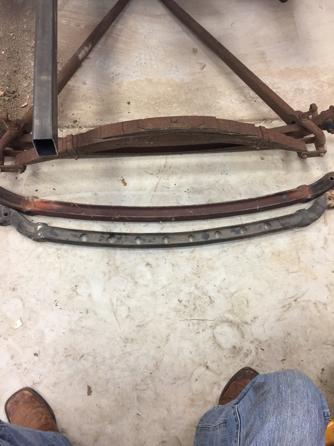

    Bought yet another axle.... it's drilled and a little more narrow. Think I'm gonna use this one.
