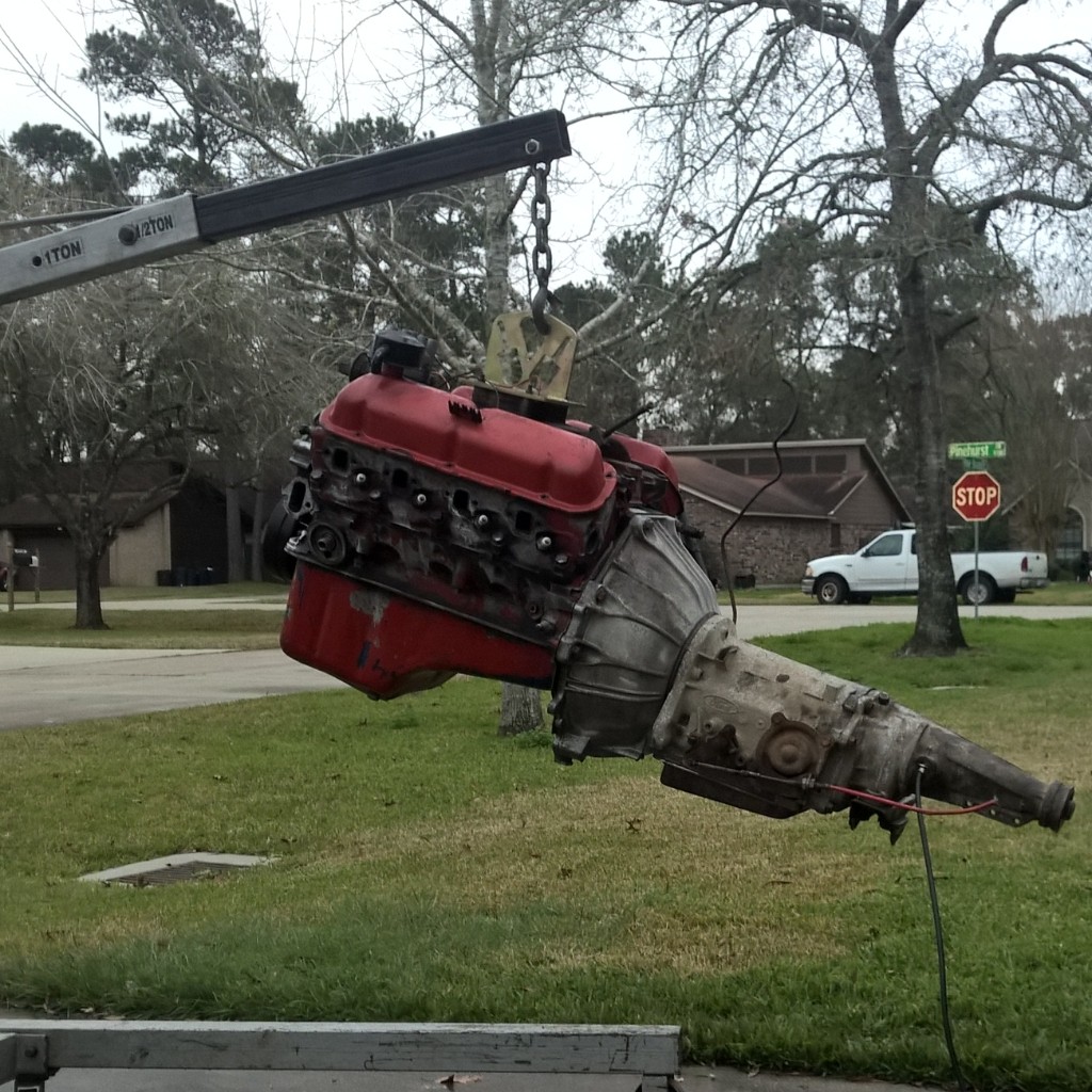

    It has been a while since I last updated, things are continuing to progress with the build, including some major changes to the project.
    Engine Change: As previously stated I had pulled the 8RT from the truck to use in the build with the T5. Once I got it tore down to replace the water pumps (that I knew leaked quite a lot) I discovered a crack in the block from the rear of the water pump to the oil pan lip. As this is a budget build and in true hot rod fashion I had to use what I had on hand, went to the back forty and pulled the smallbock ford out of the Fairlane.

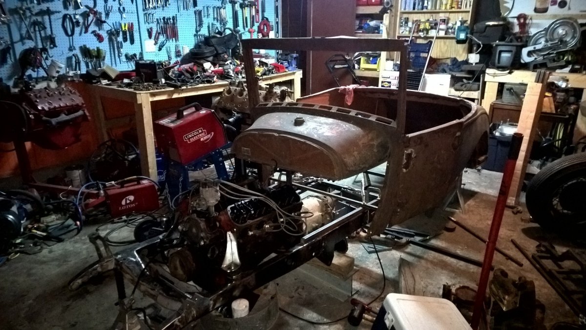

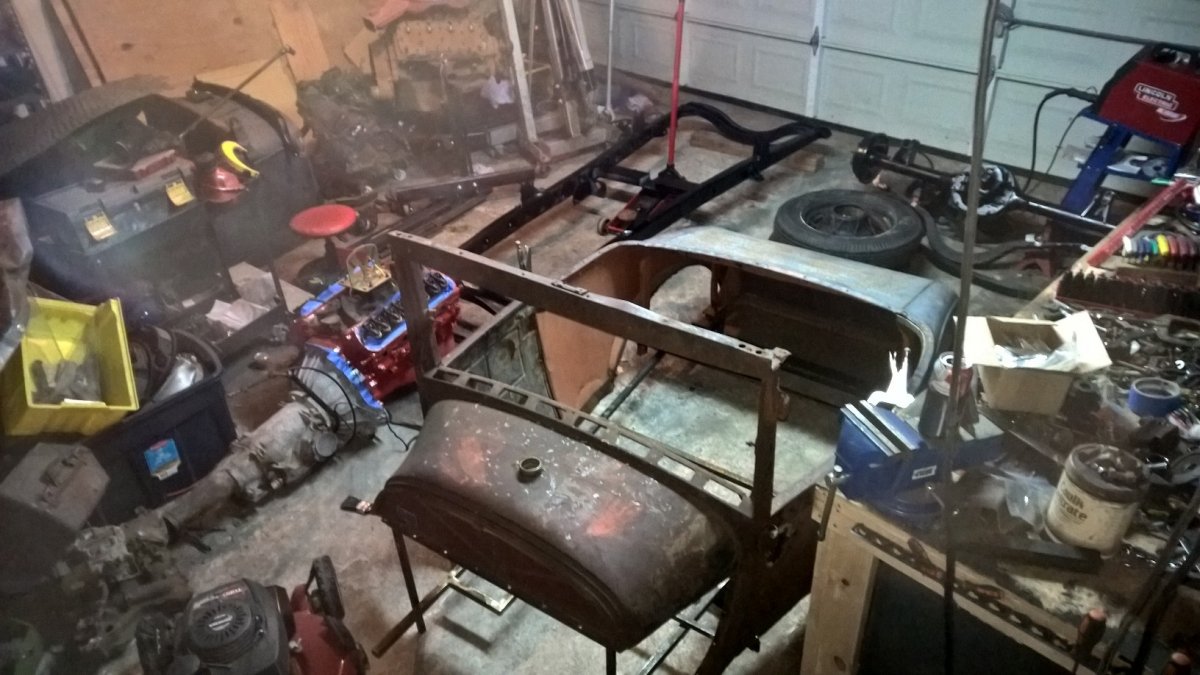

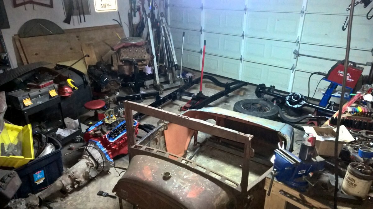

    Body Change: I started with the rear quarters from a 28/29 Sports Coupe the cowl of a 30/31 roadster and the doors of 30/31 sedan. I picked up a set of 28/29 roadster doors and a 28/29 sedan cowl, and began working the body together with the sports coupe quarters.
